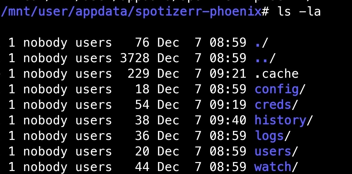

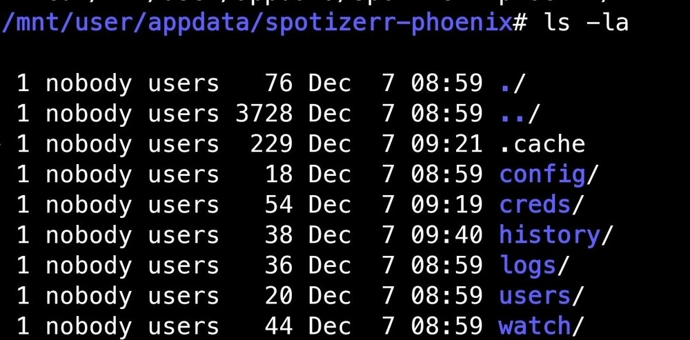

  19. Only thing I can think of is maybe a permission issue. If you are comfortable in the command line, navigate to your spotizerr appdata folder and run "ls -la". Everything should show as "nobody users". For the debugging, it might be worth asking at the creator's code repo. I can't add anything unfortunately since I don't have the skill. I just created the template. https://lavaforge.org/spotizerrphoenix/spotizerr-phoenix

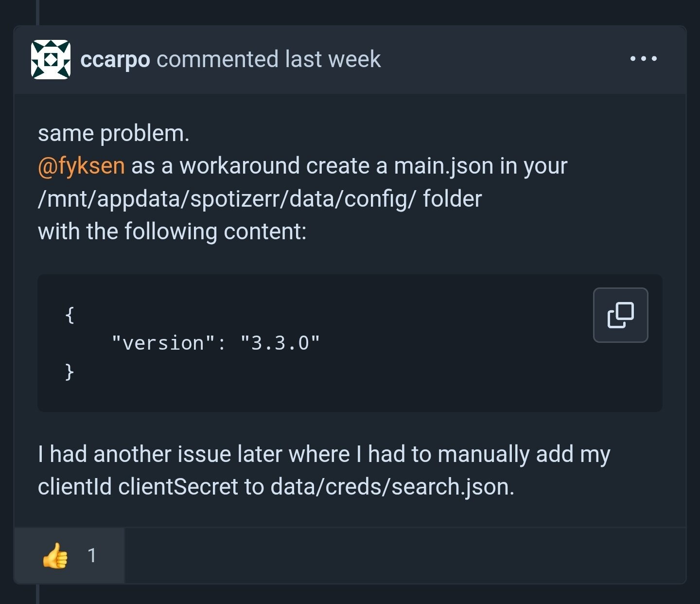

  25. You have to make a config directory in your appdata folder. Then make a main.json that has { "version": "3.3.0" } That seems to get me up and running. Source: https://lavaforge.org/spotizerr/spotizerr/issues/2
