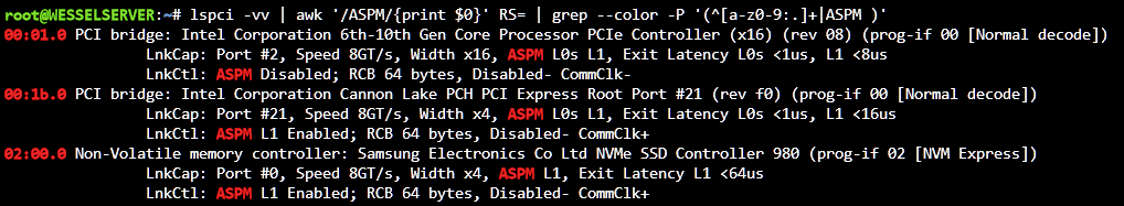

  1. I ended up disabling all the PCI express ports in the bios as I don't use them. This removed the disabled ASPM device from lspci and currently reaching C8 whici results in an average idle power draw of 7W. Might have to dig further in order to reach C10 but for now I'm happy with the idle power draw.

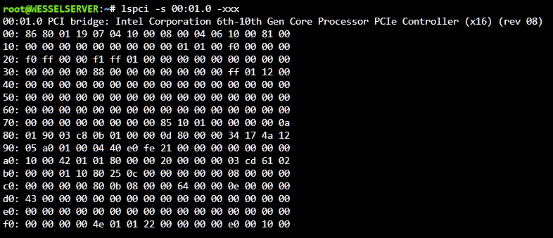

  4. Hi guys I'm havig similair issues as described above. Running an i3-8100 on Fujitsu D3643-H motherboard with Unraid 6.11.5. Currently stuck at C3 while in Ubuntu I can get to C10. Ran the lsci command (Thanks mgutt!) and believe the Intel corperation 6th-10th Gen Core Processor PCIE controller is the culprit. I'm willing to try the hack described above but get stuck on reading the bytes. I got the following output: Following the algorithm I get the following: 0x88>0x0d>0x80>0x81>0x90>0x95>0xa0>0x10. So then 0xa0 + 0x10 = 0xb0 (?) whici is 0x00? To me this doesn't seem right as I thought that it should read 0x4*. Any insight on how to proceed?
