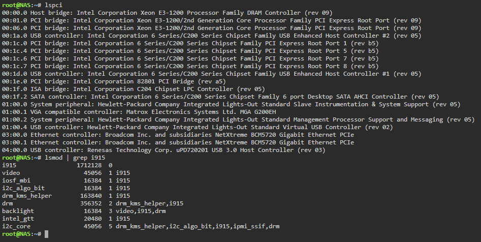

  2. Yes i tried all three options with/without Intel GPU Top plugin. Same results

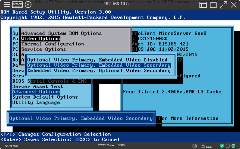

  3. In attacched file you can see what i have in my BIOS. Tried to remove Intel GPU Top and to manually enable i915 module: Same results

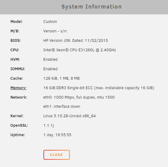

  4. Hi guys, i just replaced my old CPU with Intel Xeon CPU E31260L (with h264 hw transcoding supported) on my Microserver GEN8 . I cannot find Intel HD Graphics 2000 GPU on my OS. I already installed Intel GPU Top plugin and the "i915" module seems to be correctly loaded, but no graphic card on lspci. Some advices? Thank you nas-diagnostics-20220218-1714.zip

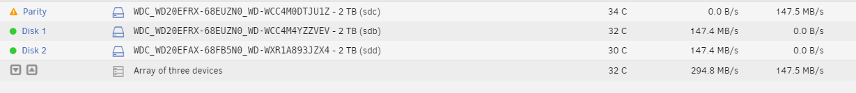

  5. Enabling write cache and AHCI on BIOS settings did the trick! Sorry, i didn't think that was disabled, i saw these performance only with unRAID. Thank you so much for your support!
  6. Ok i will wait and give a feedback tomorrow. Now parity needs almost 15h to complete. Thank you for your support
  7. I started with a new config leaving out the disk with SMR and added CMR disks as parity and data. Nothing seems to be changed. I already made this configuration with "md_write_method -> reconstruct write". Same speed. Are my disks not really good for unRAID? I remember that with other OS write/read speed were more efficient. I really want to stay wit unRAID and get the basic version after trial. nas-diagnostics-20220209-1641.zip
  8. Perfect i will check again whe parity will be done. I have 1 WD20EFAX (SMR) and 2 WD20EFRX (CMR). In this case you suggest to pick one of WD20EFRX and select as parity disk? After that, is there something else can i do trying to improve writing performance?
