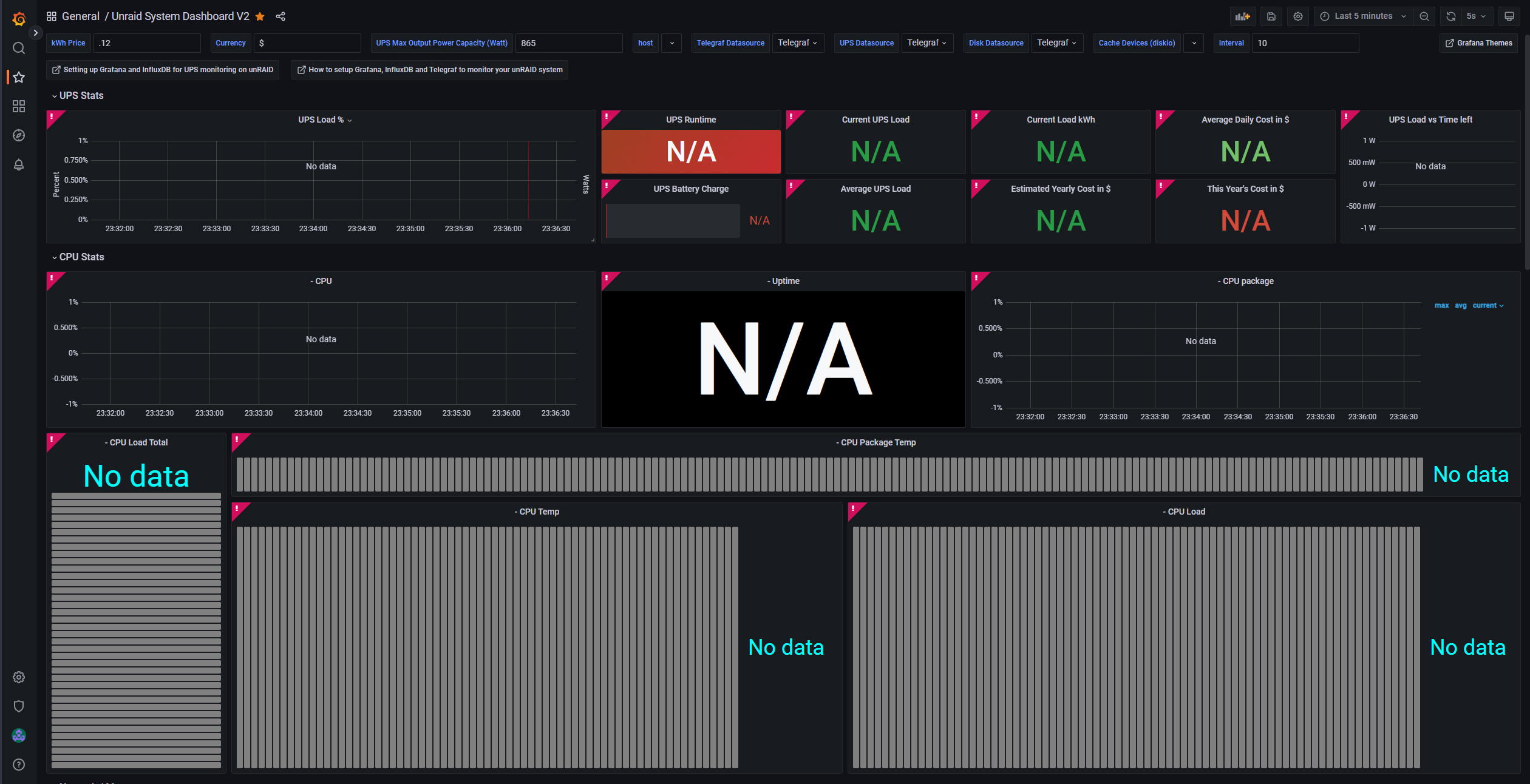

Bonjour, je me creuse la tête pour essayer de trouver d'où vient mon problème mais je ne parviens pas à trouver de solution. J'ai installé les dockers, j'ai créé le dashboard dans Grafana, seulement j'ai "no data" affiché partout, dans la fenêtre d'importation des paramètres data source InfluxDB il était noté "datasource is working. 0 measurements found". Je ne comprends pas ce qui est mal configuré. j'ai lu les logs de Telegraf et j'ai effectué les modification demandées dans telegraf.conf mais j'ai toujours ces demandes : 2023-02-24T22:46:16Z I! Starting Telegraf 1.20.2 2023-02-24T22:46:16Z I! Using config file: /etc/telegraf/telegraf.conf 2023-02-24T22:46:16Z I! Loaded inputs: cpu disk diskio docker kernel mem net netstat processes sensors smart swap system 2023-02-24T22:46:16Z I! Loaded aggregators: 2023-02-24T22:46:16Z I! Loaded processors: 2023-02-24T22:46:16Z I! Loaded outputs: influxdb_v2 2023-02-24T22:46:16Z I! Tags enabled: host=SeiferNAS 2023-02-24T22:46:16Z I! [agent] Config: Interval:10s, Quiet:false, Hostname:"SeiferNAS", Flush Interval:10s 2023-02-24T22:46:16Z W! [inputs.docker] 'perdevice' setting is set to 'true' so 'blkio' and 'network' metrics will be collected. Please set it to 'false' and use 'perdevice_include' instead to control this behaviour as 'perdevice' will be deprecated 2023-02-24T22:46:16Z W! [inputs.docker] 'total' setting is set to 'false' so 'blkio' and 'network' metrics will not be collected. Please set it to 'true' and use 'total_include' instead to control this behaviour as 'total' will be deprecated fetch https://dl-cdn.alpinelinux.org/alpine/v3.14/main/x86_64/APKINDEX.tar.gz fetch https://dl-cdn.alpinelinux.org/alpine/v3.14/community/x86_64/APKINDEX.tar.gz v3.14.9-22-g96b34ac960c [https://dl-cdn.alpinelinux.org/alpine/v3.14/main] v3.14.9-22-g96b34ac960c [https://dl-cdn.alpinelinux.org/alpine/v3.14/community] OK: 14975 distinct packages available (1/3) Installing libgcc (10.3.1_git20210424-r2) (2/3) Installing libstdc++ (10.3.1_git20210424-r2) (3/3) Installing smartmontools (7.2-r1) Executing busybox-1.33.1-r3.trigger OK: 21 MiB in 33 packages (1/3) Installing libbz2 (1.0.8-r1) (2/3) Installing perl (5.32.1-r0) (3/3) Installing lm-sensors-detect (3.6.0-r1) Executing busybox-1.33.1-r3.trigger OK: 59 MiB in 36 packages (1/2) Installing libuuid (2.37.4-r0) (2/2) Installing nvme-cli (1.14-r0) Executing busybox-1.33.1-r3.trigger OK: 60 MiB in 38 packages (1/1) Installing ipmitool (1.8.18-r9) Executing busybox-1.33.1-r3.trigger OK: 61 MiB in 39 packages 2023-02-24T22:46:26Z E! [outputs.influxdb_v2] Failed to write metric (will be dropped: 404 Not Found): :

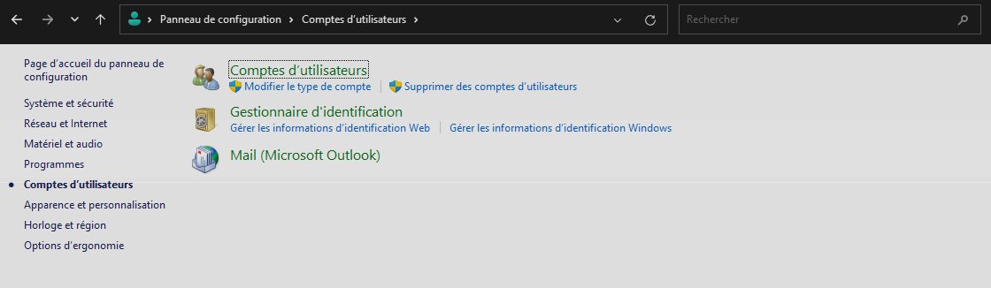

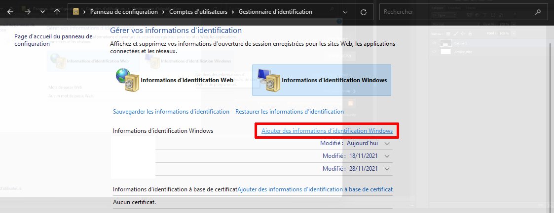

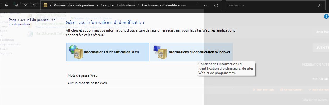

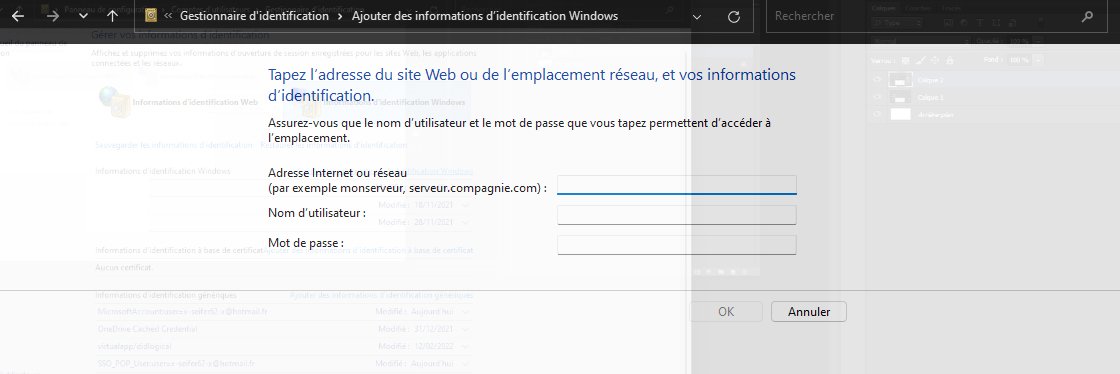

Bon après un moment à rechercher la cause du problème, cela semblerait provenir de Windows, je viens d'ajouter un compte utilisateur pour l'accès au NAS : (je partage au cas où cela pourrait en aider certains) Aller dans panneau de configuration > Comptes d'utilisateurs > Gestionnaire d'identification : Ensuite cliquer sur Informations d'identification Windows : Et cliquer sur Ajouter des informations d'identification Windows : Ajouter l'adresse IP du serveur, le nom d'utilisateur et le mot de passe : Au redémarrage de Windows, plus de soucis d'accès aux dossiers Shares.

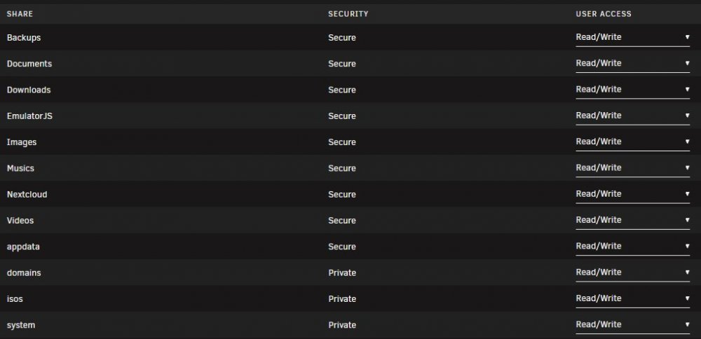

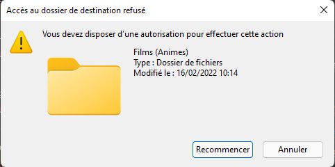

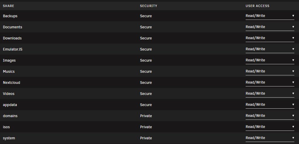

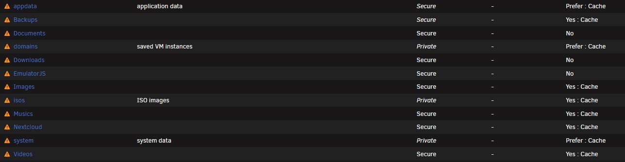

Bonjour, je suis confronté à un soucis récurrent sur Unraid, j'ai sauté le pas du NAS DIY et de l'installation de divers plugins et dockers, de ce côté RAS. Par contre, pour transférer les fichiers de mon RPi au NAS DIY c'est une autre histoire. Il m'est parfois impossible de transférer des fichiers par soucis d'autorisation d'accès au share, j'ai beau aller dans Tools > New permissions et cliquer sur le share désiré et Apply, rien n'y fait, j'ai beau essayé de redémarrer le NAS ou le PC (sous Windows 11), je ne parviens pas à effectuer de transferts. J'ai droit à ce type de message lorsque je veux créer un dossier : Dans mes shares, tout est paramétré correctement je pense : Et dans Users, j'ai bien tout placé en Read/Write : Y a-t'il une manip qui pourrait causer ce genre de problème? Y a-t'il un délai à attendre entre la demande de nouvelle permission et l'accès aux dossiers? EDIT: Aucun login/mdp ne m'est demandé par le NAS sous Windows pour l'accès aux fichiers, est-ce normal?
