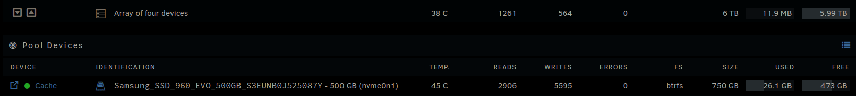

  4. Unraid 6.12.4 hello, just set up a new unraid server with a cache drive today, my cache device has 26GB used but my array only has 12MB so when does the data on the cache get copied to the array? i would assume a cache would work in the way that when writing to server it first gets written to cache and then basically immediately gets copied to the array drives while still remaining in cache and then when reading an uncached file i would assume it would copy it to the cache drive and still keep a copy on the array is there a way to have this behavior? ^^^ have it set it up wrong?

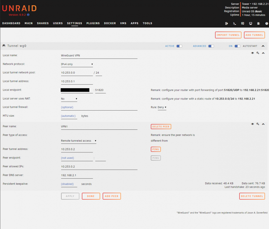

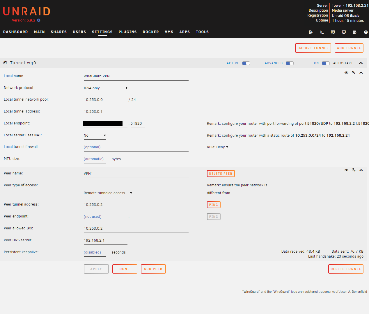

  5. hello, i have set up a wireguard VPN on unraid 6.9.2 using Dynamix WireGuard plugin (installed via Community Applications plugin) when i connect to the VPN i am only able to access my UnRaid server but not the internet or LAN, i have forwarded the UDP port and the peer access type is set to Remote tunneled access i have attached my wireguard config screen what could be wrong and how could i fix it?
