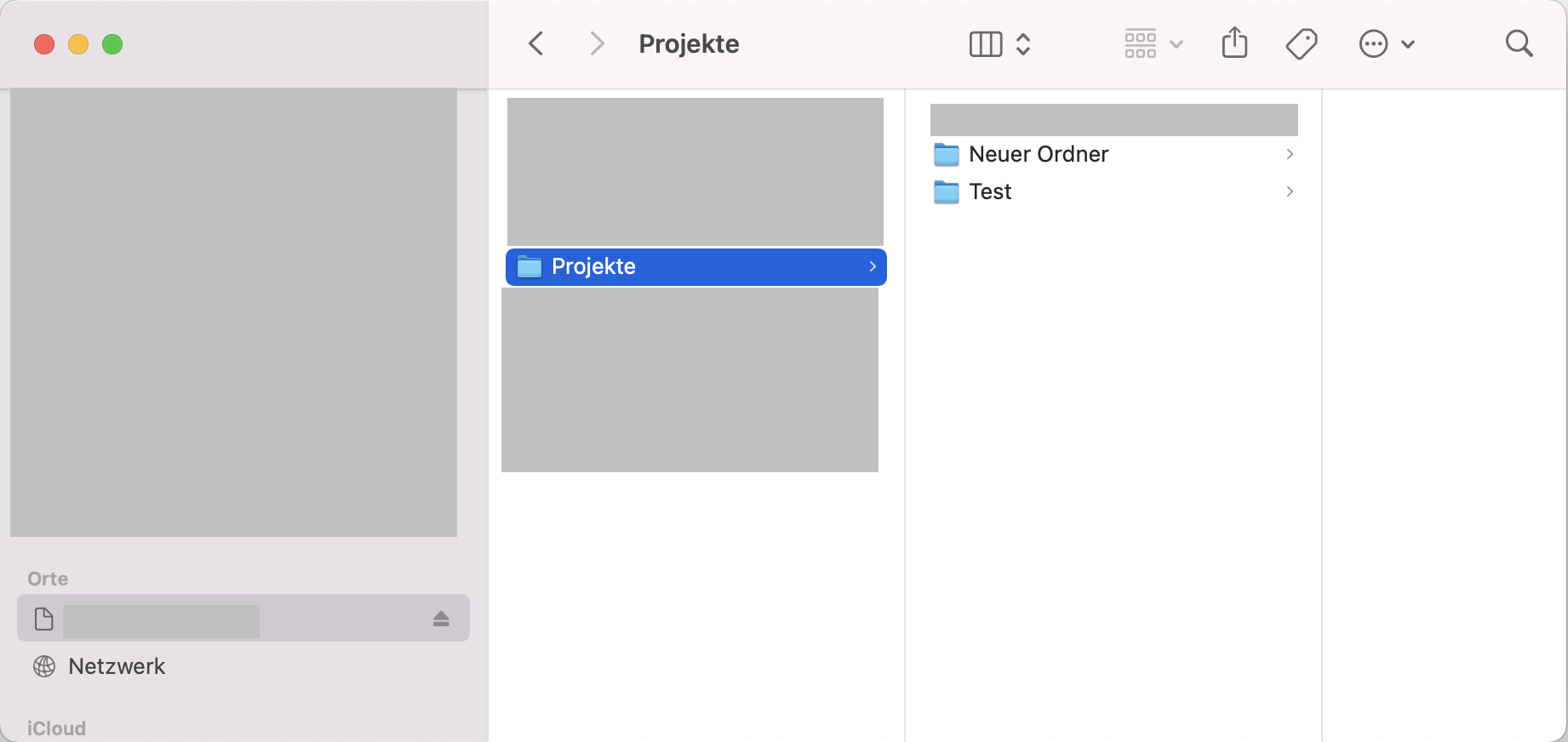

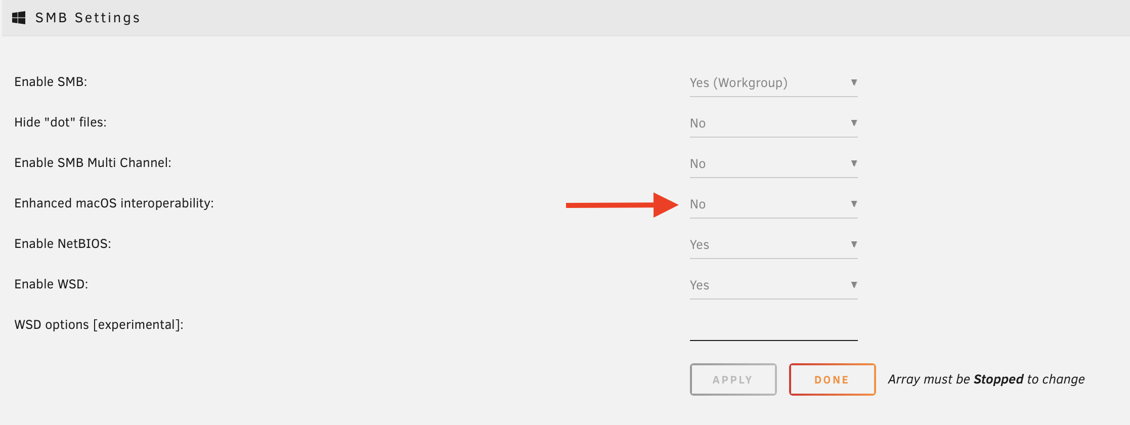

Most folders are "gone" after updating to Unraid OS 6.10.3 - but they're still kinda present....
Thank you! Disabling "Enhanced macOS interoperability" worked for me... Navigating in Finder seems way smoother as well... Thanks a lot!

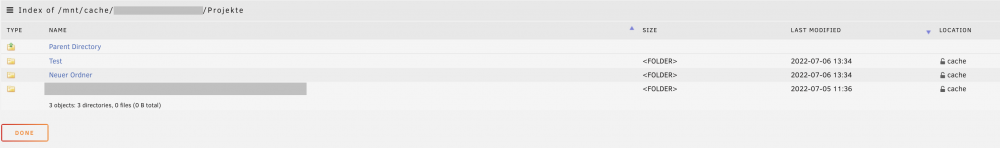

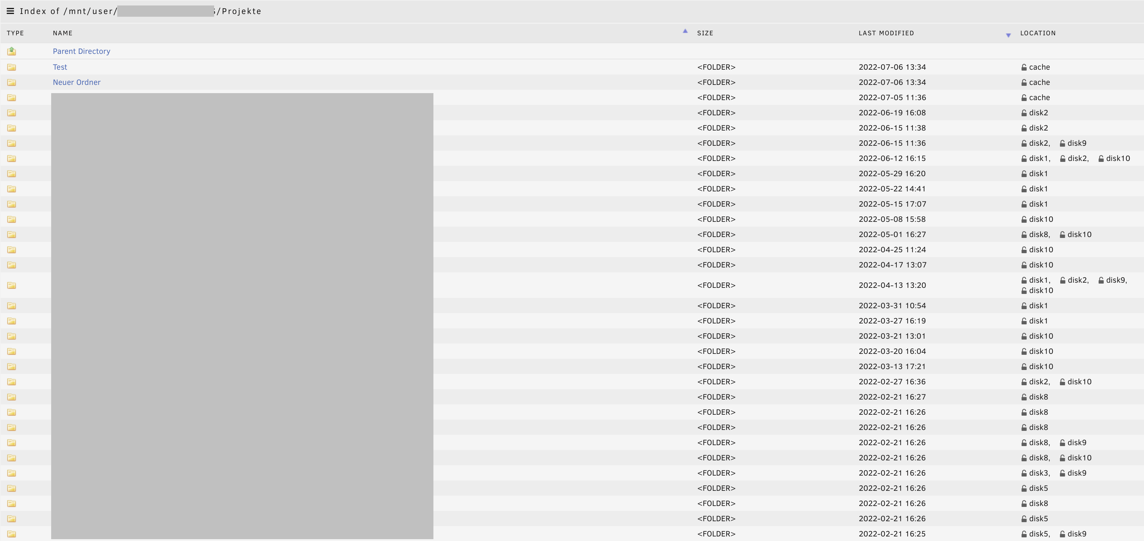

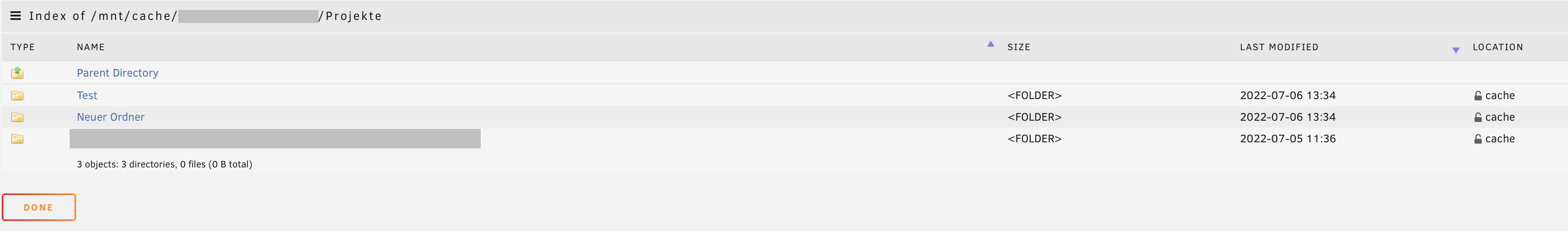

Thanks. I know what's the problem though now... Unraid only presents the folders present in cache, to my Mac... Meaning, it somehow does not display the main folders on the hard drives... So it must be an Unraid error, right?! See those are all the folders on my share (main hard drives): Those are the folders currently in cache, ready to be moved...: Now instead of displaying all folders that are in cache + the ones on my main drives, it only shows the folders in cache to my Mac...: Has anyone ever had this issue?! HELP

Hey everyone, I've been on OS 6.9.2 for a long time, but wanted to do an update now. I started the update procedure, and it went just fine. After reboot, everything looked normal, until I wanted to access data. I have a share with a folder named: "Projects". It contains a ton of subfolders and is really important data for me, a few terabytes... When I'm trying to access this "Projects" folder on my Mac, it appears absolutely empty. There's just nothing in it. However, when I take a look at the Unraid UI and go to the folder, all the data is present... The general Share containing the folder shows up on my Mac and is accessible. When I undo the software update, all my data shows up again on my Mac... Has anyone ever experienced something similar? I attached a diagnostic file from Unraid OS 6.10.3... Thanks for your help! leoT-diagnostics-20220705-1204.zip

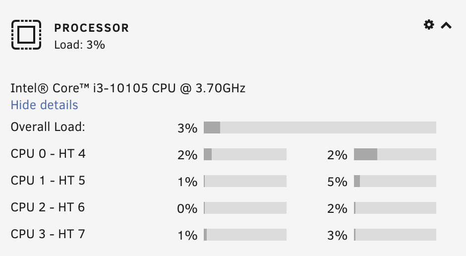

I don't know what was wrong... But now everything runs smoothly using the following command: rclone sync --update --verbose --transfers 10 --checkers 8 --contimeout 60s --timeout 300s --retries 3 --low-level-retries 10 --stats 1s /mnt/user/SOURCE GoogleDrive:Destination FYI: when adding --exclude "._*" --exclude ".DS_Store" rclone stops uploading those random generated files by macOS systems... CPU load is totally fine now:

I don't know what was wrong... But now everything runs smoothly using the following command: rclone sync --update --verbose --transfers 10 --checkers 8 --contimeout 60s --timeout 300s --retries 3 --low-level-retries 10 --stats 1s /mnt/user/SOURCE GoogleDrive:Destination FYI: when adding --exclude "._*" --exclude ".DS_Store" rclone stops uploading those random Mac generated files... CPU load is totally fine now:

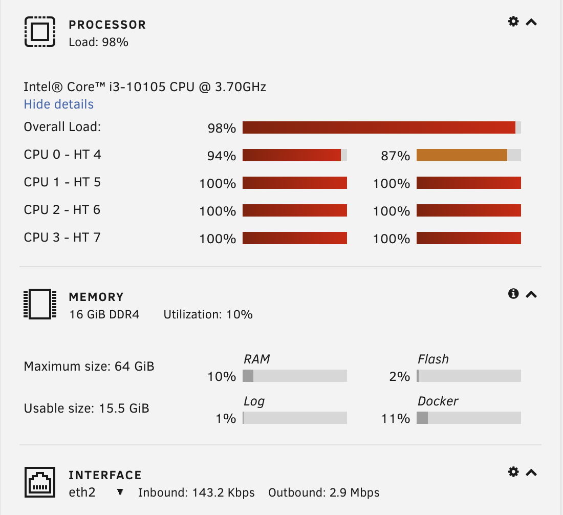

I somehow can't post into 'Plugin Support'... That is why it's here... I need some help.... I set up a rclone instance, cloning all my data to Google Drive. So far it's running flawlessly except for the CPU usage. As soon as I hit the "Run in Background" button of the "CA User Scripts" Plugin, my CPU ramps up to nearly constant 100%... I know that I don't have the best CPU, but 100% does not feel right. Btw. I can't stop the script by aborting it through the "CA User Scripts" Plugin. I always have to restart the entire server... I'm running the following script inside the "CA User Scripts" Plugin. Much appreciate your Help! #!/bin/bash echo GoogleDrive SYNC wurde gestartet: rclone sync /mnt/user/SOURCE NAS-SYNC: -P --progress-terminal-title --max-transfer=700G --retries 15 --retries-sleep=1800s --transfers=2 --checkers=4 echo GoogleDrive SYNC wurde erfolgreich beendet.

Hi everyone, I need some help. I set up a rclone instance, cloning all my data to Google Drive. So far it's running flawlessly except for the CPU usage. As soon as I hit the "Run in Background" button of the "CA User Scripts" Plugin, my CPU ramps up to nearly constant 100%... I know that I don't have the best CPU, but 100% does not feel right. Btw. I can't stop the script by aborting it through the "CA User Scripts" Plugin. I always have to restart the entire server... I'm running the following script inside the "CA User Scripts" Plugin. Much appreciate your Help! #!/bin/bash echo GoogleDrive SYNC wurde gestartet: rclone sync /mnt/user/SOURCE NAS-SYNC: -P --progress-terminal-title --max-transfer=700G --retries 15 --retries-sleep=1800s --transfers=2 --checkers=4 echo GoogleDrive SYNC wurde erfolgreich beendet.
