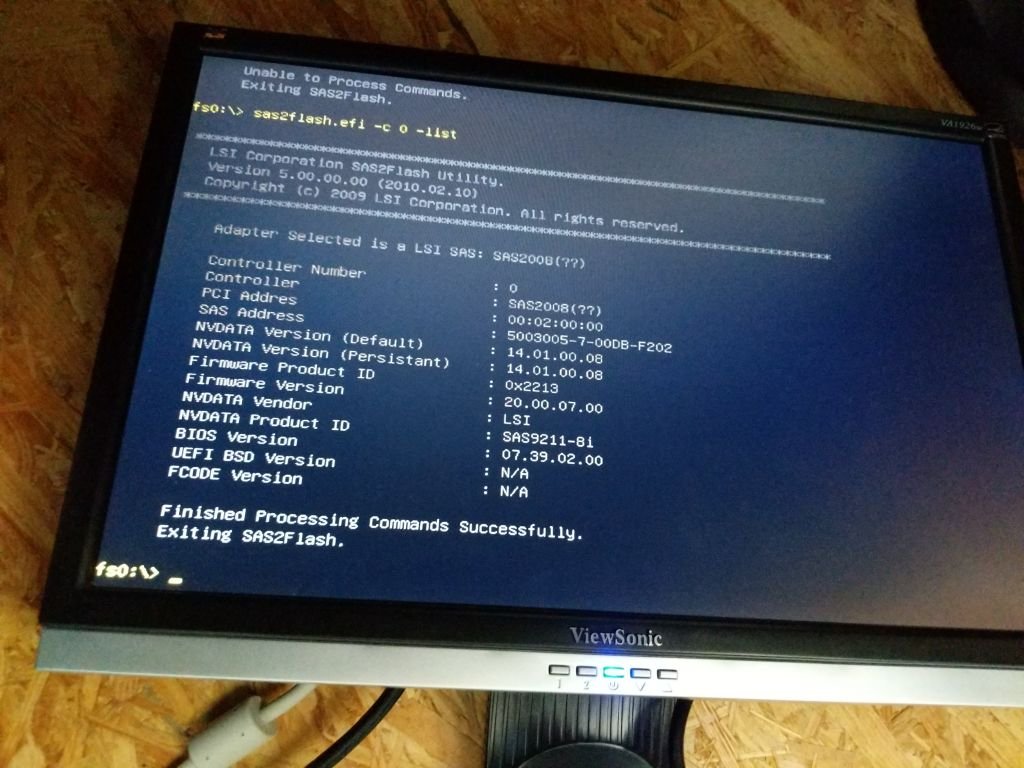

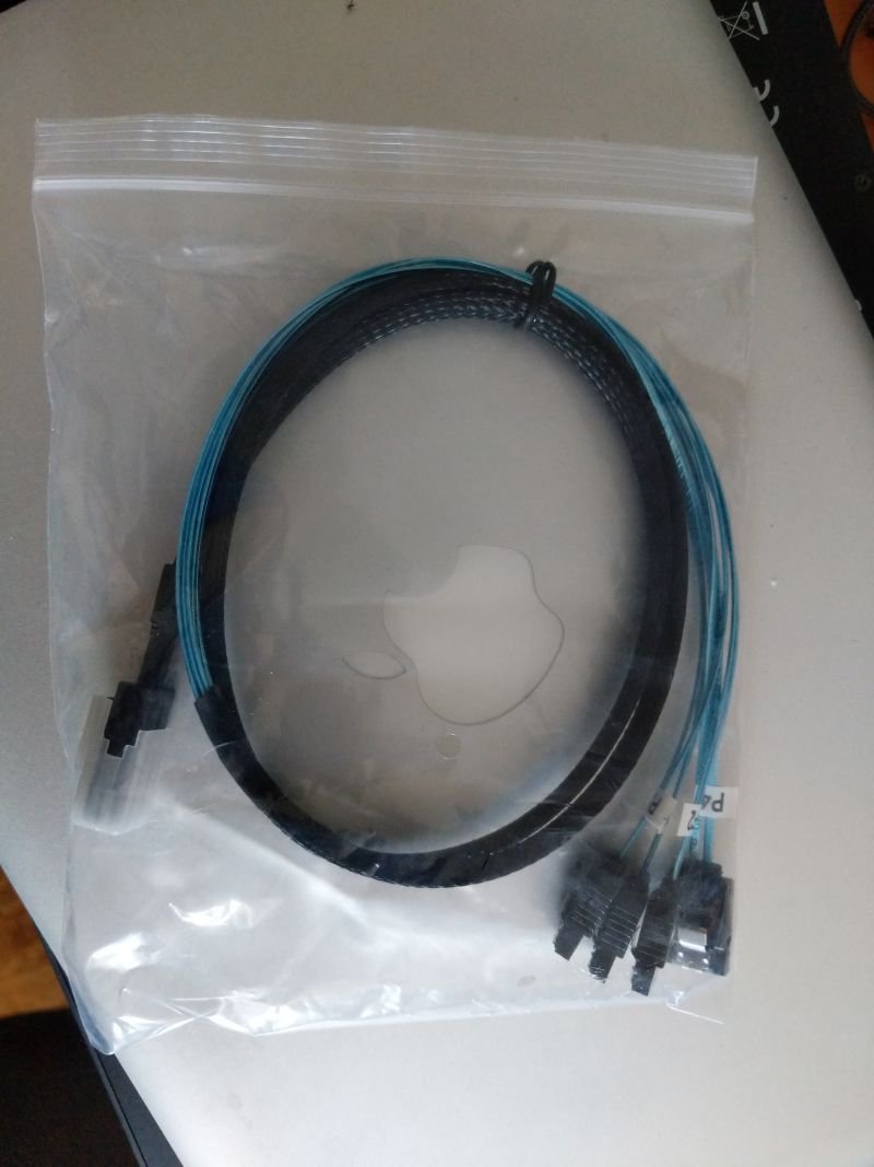

Sorry for late reply, couldn't get back on it earlier! I'm using the two split cables that came with the LSI card from China, they are unlabeled. I plugged it into a HDD today, HDD appears in Unraid Devices, but optical drive doesn't. @Vr2Io You seem to have positive experience passing through optical drives with LSI HBA. Any idea why it's not working for me? The cables seem to be ok. Cheers all!
LSI HBA 9211-8i: connected devices not shown despite IT mode
Thank you JorgeB for your comment! I'll try if a normal HDD works asap. But anyhow, somehow it must be possible to passthrough an optical disc to a VM in Unraid, right? As none of the PCIe ACS Override helped me separate the mainboard SATA ports being used by my array from the one I originally had my DVD drive connected to, should I move my array to the LSI (if disks are recognized) and move the optical drive to the mainboard SATA ports instead? Would non-LSI HBAs work with optical drives, as you said "not sure if an LSI would detect optical drives? Here are my diagnostics: where would you see if the HBA is being initialized properly? nexus-diagnostics-20220623-2218.zip Cheers!
Hi all, I've bought a LSI SAS2008 HBA card (9211-8i), but in Unraid Device Settings I can only see the LSI Raid Adapter, not the connected devices. I want to pass-through a DVD drive to a VM, which wasn't possible using the mainboards SATA port, as my drive array is running on that and I coldn't manage to split the IOMMU group to only pass-through the SATA port connected to the DVD drive. I've checked the installed firmware/bios with sas2flash, FW is 20.00.07.00 and NVDATA version is 14.01.00.08. Reflashing IT fw didn't change anything. CSM support is enabled in BIOS, but LSI Bios is not shown (so no Ctrl-C possible to check if "IT" or "IR"). What am I missing? Please see screenshot ot SAS adapter info. Cheers!

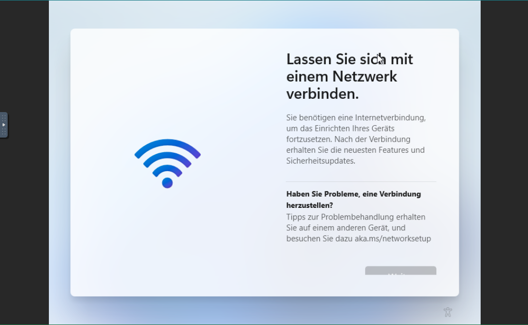

having the same problem here. just can't create and successfully access (via noVNC) a Win 11 VM. tried different driver images, Q35 and i440, nothing works! any idea what i'm doing wrong? I'm attaching diagnostics. Cheers! nexus-diagnostics-20220412-2000.zip
can't proceed Win 11 VM install / buttons not clickable due to screen res
Hey there, I cannot continue my Win 11 VM install as the necessary button is not being displayed ("I have no internet connection"). Any advice on how to get arount that? the standard keys as tab, space, arrows are not working. Cheers!
