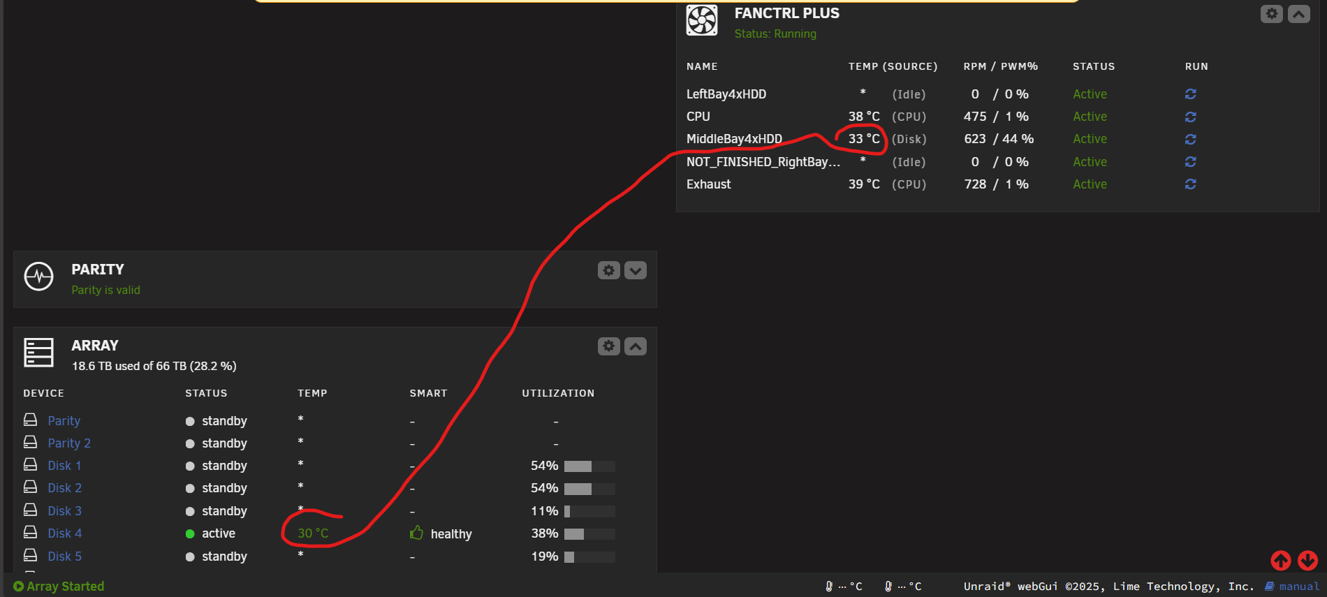

Somehow FanCtrlPlus reads (or calculate wrong) disk temperature. I have a fan job monitoring 4 disks, only one active at the moment and reporting 33°C but FC+ shows 33°C and PWM values are high. No change after clicking the run/refresh button on the Dashboard page.

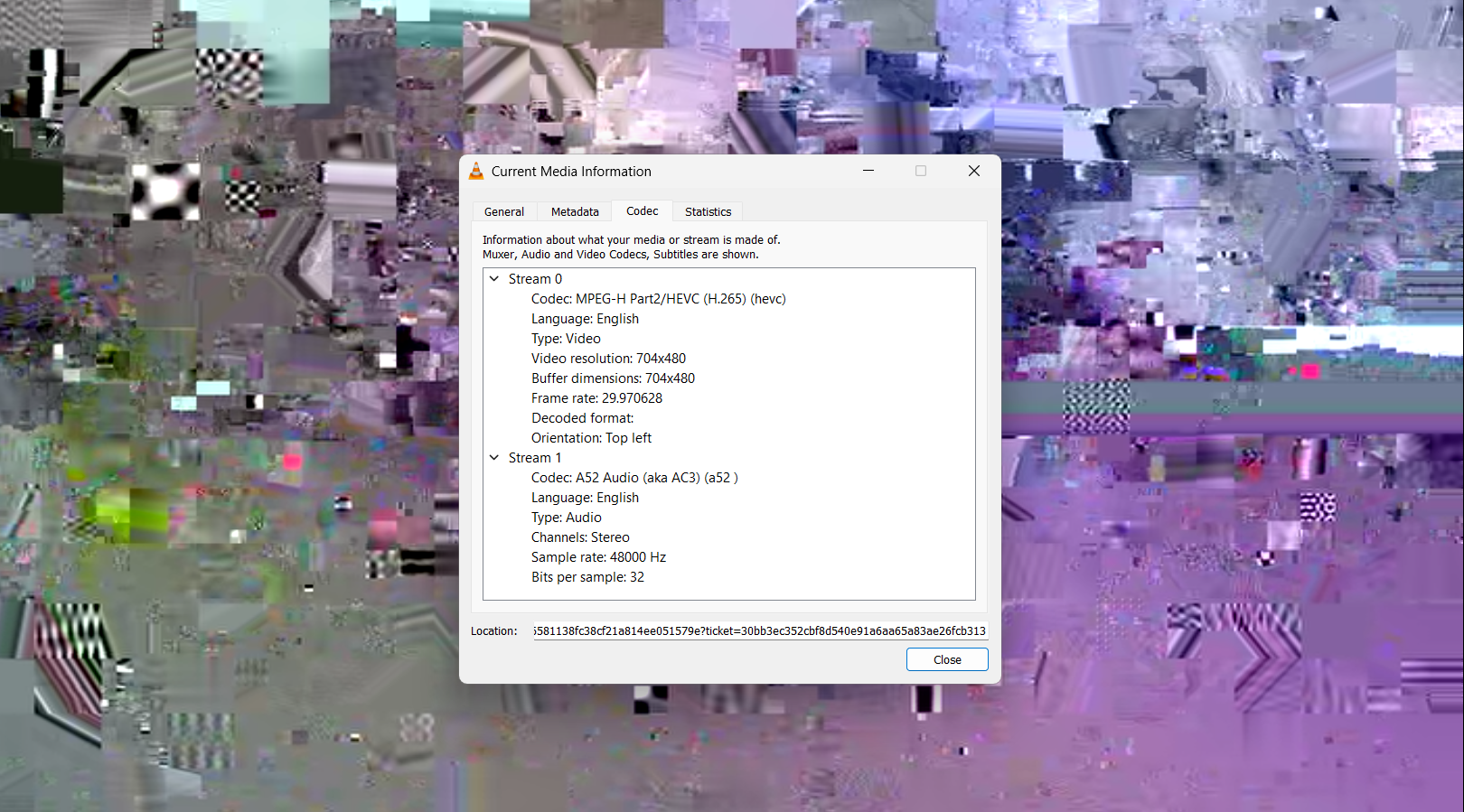

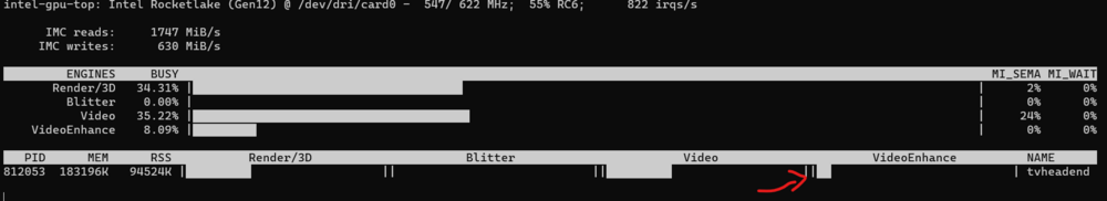

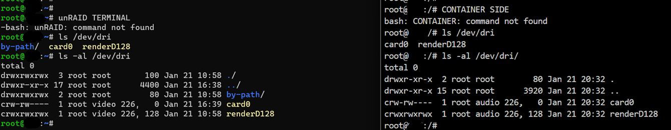

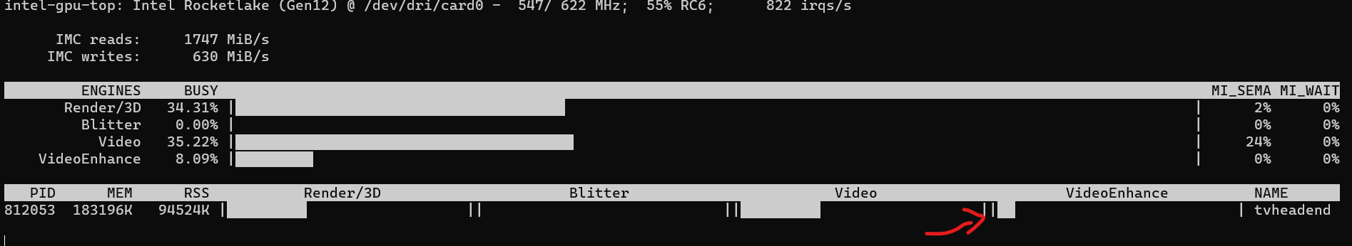

I recently updated hardware from i5-9600T (UHD 630 iGPU) to i7-11700t (UHD 750 iGPU) and also unRAID from 6.12 to 7.2.3. TVHeadend can no longer record with vaapi intel acceleration. I see with intel_GPU_top that it is using the device, but I only get proper audio with some scrambled color video blocks/blobs. When running 'ls -al /dev/dri' in the container terminal(right), I noticed it doesn't say video(just audio) like it say in the main unRAID terminal (left): Can someone that has VAAPI transcoding working please run the ls -al /dev/dri and give me the output from the TVHE container console? Any tips appreciated. I did see multiple reports of issues with 10th and 11th gen iGPU but they all seem to be from around 2021 and it seems should be fixed by now. This is what the video recording looks like:

This indicates that something is wrong with your transcoding settings or the passthrough to the container. It is not necessary but when I changed the permissions with chmod 777 /dev/dri/* I stopped getting the "No VA display/unable to find /dev/dri/renderD128 in TVHE docker log. Worth mentioning that original unRAID/TVHE setup was from ~2021. Wasn't there some plugin/docker permission handling change at some point?

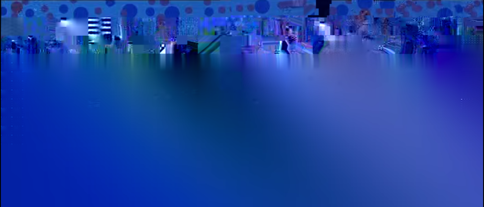

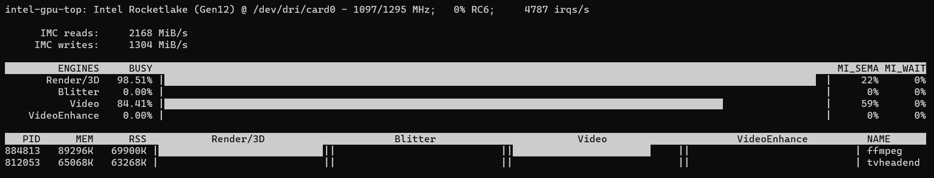

Having problems with TVHeadend/vaapi hardware encoding. I was running Unraid 6.12.5 with Intel i5-9600t (UHD 630 iGPU); In preparation for hardware upgrade to i7-11700t (UHD 750 iGPU) I updated unRAID to 7.2.3 ( incremental 7.0, 7.1. 7.2, 7.2.3), and updated all plugins including ich777's Intel GPU Top. Before this software update, TVHeadEnd was recording in h265 vaapi just fine, but the the Intel_GPU_Top I was running was probably couple years old. Unfortunately, and this is my fault, I didn't check (I did so many other things) if just the software components update broke this or not. Upgraded the hardware and it wasn't till late in the night to discover that TVHeadend records the audio but video is not usable by any player, pic: Surprisingly, Jellyfin transcodes with iGPU just fine. However, I did notice some differences - TVHeadEnd uses the "VideoEnhance" while the Jellyfin does not: Jellyfin (works): TVHeadEnd (no longer works): It is worth mentioning that the originally I stayed with the same TVHeadEnd docker container. When I first discovered the issue, in the TVHeadEnd docker log, I saw a warning that the read something of the sort "No VA Display, unable to find /dev/dri/renderD128. So googled a bit and executed this permissions command: chmod 777 /dev/dri/* This solved the no renderD128 error in TVHE log. However, the result are the same. I went down the rabbit hole searching for problems within TVHeadEnd - numerous reports of failed vaapi encoding. Spent a day on that, udapted to latest and dowgraded to older builds - no changes. Does this seem right for dev/dri list inside the container: root:~# sudo docker exec -it tvheadend ls -l /dev/dri total 0 crwxrwxrwx 1 root audio 226, 0 Jan 20 19:08 card0 crwxrwxrwx 1 root audio 226, 128 Jan 20 19:08 renderD128 Anyone has experience this or can at least point me to what should I do next?
