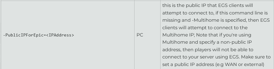

  1. Well..., it does not work (The server does not start-up), The IP that you can use with multihome needs to be a valid interface adress. https://github.com/arkmanager/ark-server-tools/issues/855
  2. Thats all i found, and here its mentioned as -Multihome
  3. OH, thats Genius, where did you get that parameter from, ive looked through the wiki etc and it isnt mentioned anywhere.

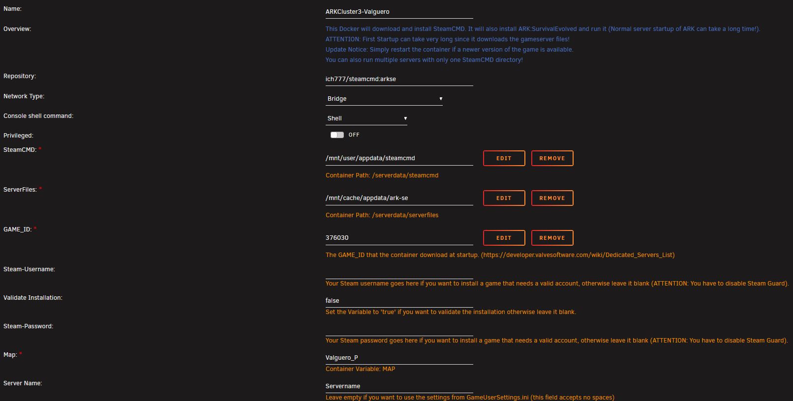

  9. Or was anything changed in the docker itself ? I think there were two updates since i last played
  10. Yeah it is, to speed up things i always start up one container, let it update the game, then start the second instance with validation set to true, let it validate and then start the last one.

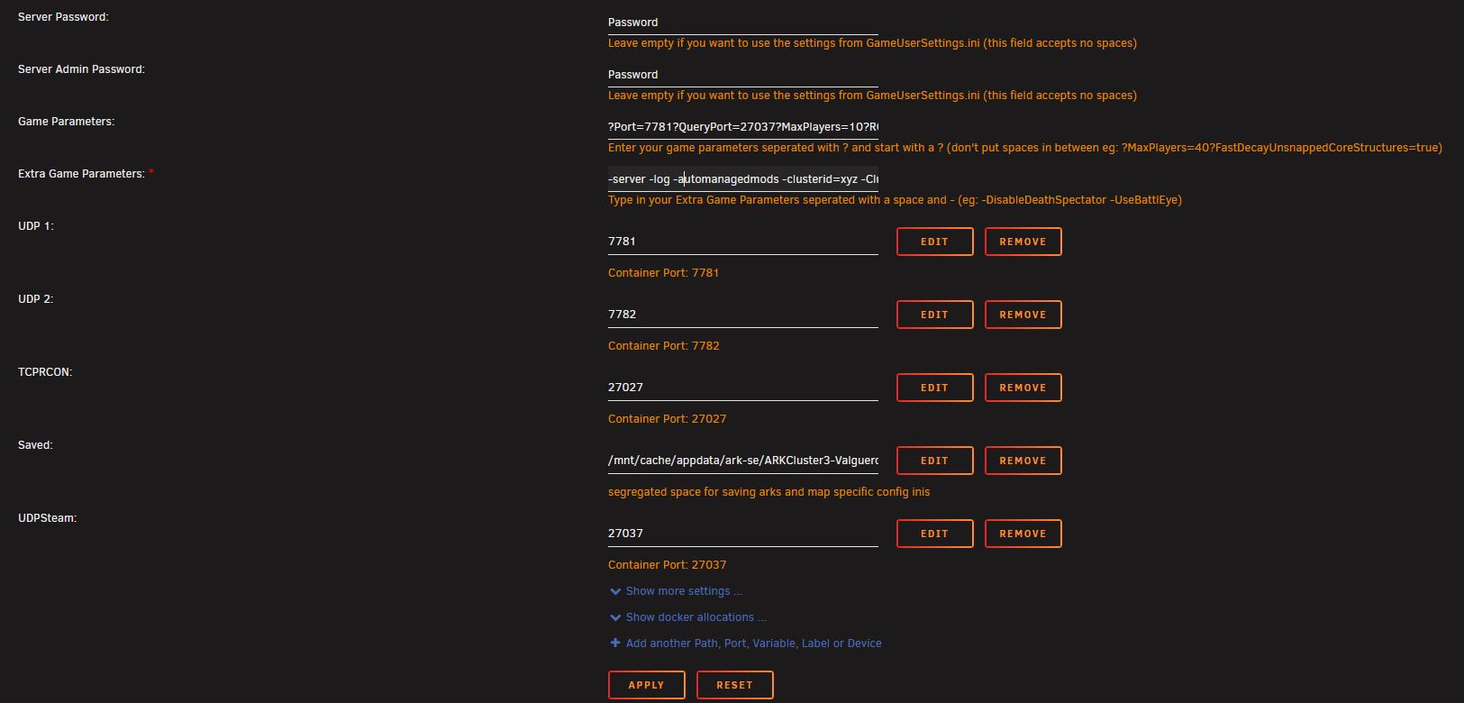

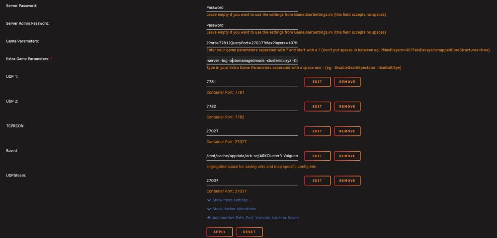

  11. Here is my config The whole config of GameParams: ?Port=7781?QueryPort=27037?MaxPlayers=10?RCONEnabled=True?RCONPort=27027 The whole config of ExtraGameParams: -server -log -automanagedmods -clusterid=xyz -ClusterDirOverride=/serverdata/serverfiles/clusterfiles -NoTransferFromFiltering -crossplay The ClusterID and Passwords are for obvious reasons not the real ones And when changing the ClusterID and starting up a docker no new clusterfolder for that id gets created
  12. Hi @ich777, I had an ARK-Cluster (3-Container) running until 4 Months ago. Me and my friend then paused and wanted to continue today. But after starting up the Servers again, it is impossible to transfer between servers (as if Ark doesn't recognize its in a cluster). So i rechecked my config and everything seems fine (same clusterid, the clusterfolder exists and is mapped to the servers) So according to the Post of @Cyd It should be up and running, as it was 4 months ago. Any ideas, what i am missing ?
