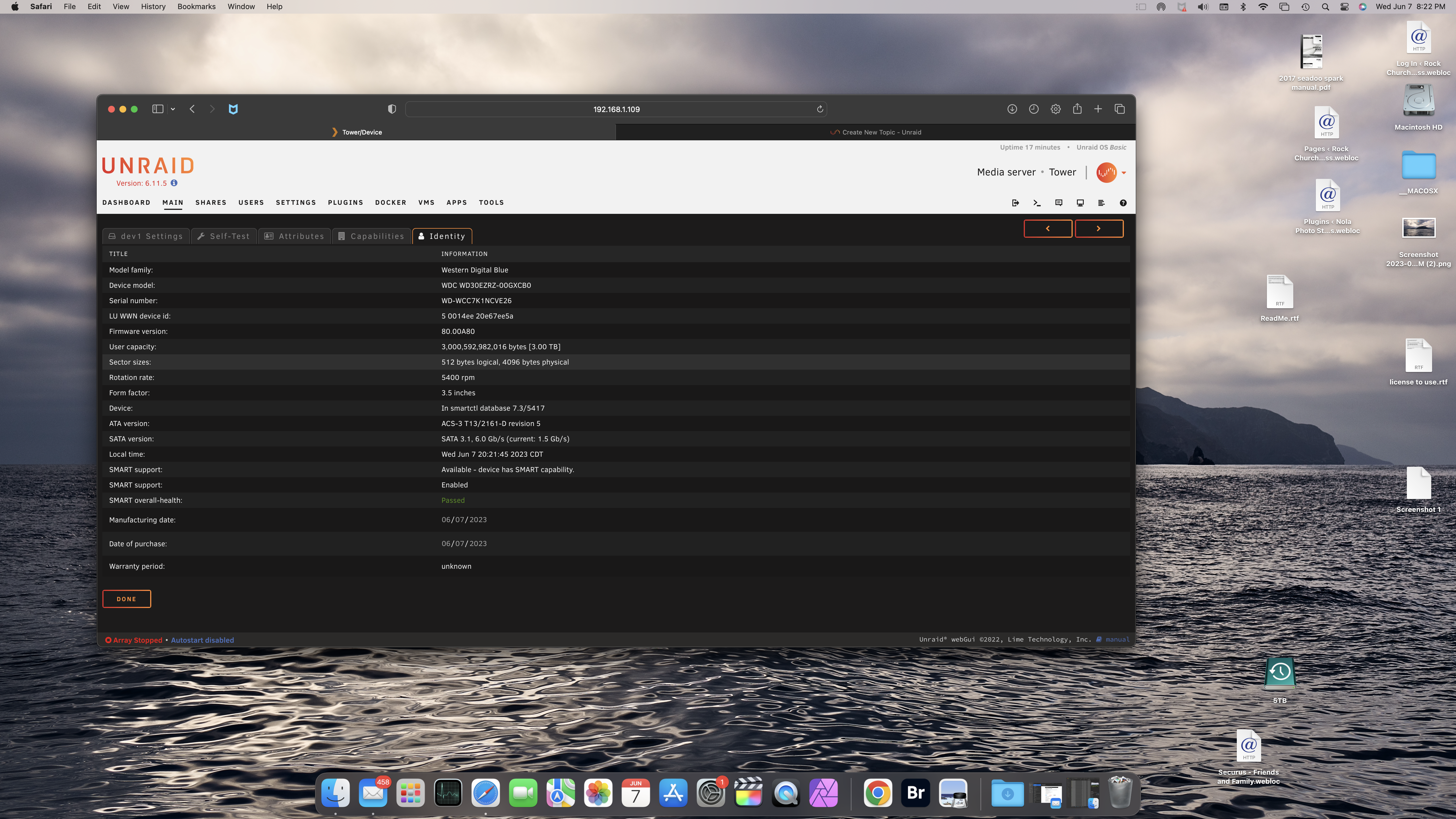

  5. Guys, I used to have this hard disk in my array and I removed it last week. I have it plugged up to an external case through a USB cable to test the drive. It is a 3 TB WD blue hard disk and it is showing that it has only 802 GB. Did the drive fail and or crash? I will include a screen show. Can options do I have? Is it possible to remove the partition and redo the partition and then a format? Thanks for your help.
