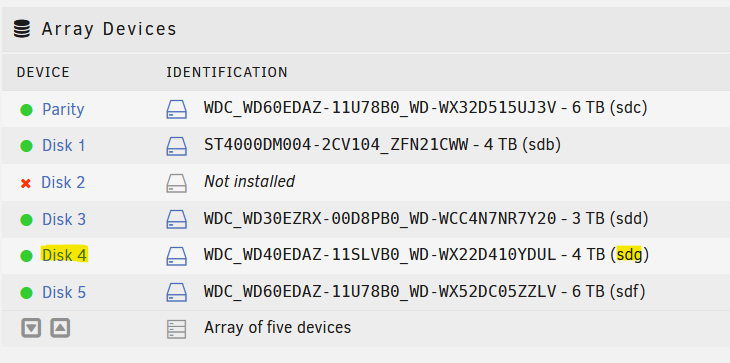

  5. This is the only odd thing I can find. When the array is started. Disk4 is unmountable. It's showing (sdg) which doesn't exist. # hdparm -I /dev/sdg /dev/sdg: No such file or directory The duplicate unassigned device (sde) does. # hdparm -I /dev/sde /dev/sde: ATA device, with non-removable media Model Number: WDC WD40EDAZ-11SLVB0 Serial Number: WD-WX22D410YDUL Any ideas what is causing that and how to fix it?

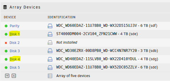

  6. Disk 2 is missing. So yes it's unmountable because of that. That's what started this for me. I had trouble replacing the drive because of slowness. It was stating that it was going to take 57 days to repair & the web interface was extremely slow. Pretty sure the SATA controller on the board is failing. Disk1 I was mistaken, it's mounted, but not sure why it's showing up as an Historical device. Disk4 is flipping around and showing up as sdc, sdf, sdg, sdh. I've run short & extended smart tests and it's not showing any errors but the array seems to think there are 2 read errors. The Mini SAS cables are brand new and seated well. Last night I tried to put them in the same order as they were before so they've been moved around and still same state. Just trying to get to a point that I can try and add the new replacement Disk2 and rebuild. Then I'll be replacing the motherboard.

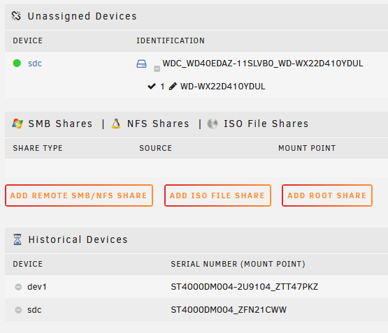

  7. I bought an LSI SAS 9210-8i card and moved my drives off the motherboard onto it. After putting the card in and cabling it up I have 2 drives that are showing as unmountable. (Disk1 & Disk4). When I start the array I see that: - Disk4 is also seen as an Unassigned Device (sdc) - Disk1 is seen as an historical device (sdc) When I stop the array I see that: - Both Disk1 & Disk4 show up as Historical Devices. Not sure how to resolve it. D iwursrv-diagnostics-20220320-1116.zip

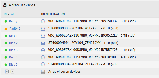

  12. Hi, I had a drive fail (disk5) and replaced it. Unraid did it's thing and completed this afternoon stating "Parity sync / Data rebuild finished (0 errors)" My PLEX docker is unable to run properly. Logs show "PMS: failure detected. Read/write access is required for path: /config/Library/Application Support/Plex Media Server". Same with DiskSpeed. Both won't open the WebGUI. I attempted to remove/reinstall Diskspeed but the install failed badly and it doesn't even start now. When I open the Plex user console, the /mnt directory is seen as empty. I also noticed this with disk5 (the new drive) while looking around trying to figure out what the problem is: drwxrwxrwx 3 nobody users 48 Mar 2 16:21 disk4/ d????????? ? ? ? ? ? disk5/ drwxrwxrwx 1 nobody users 244 Mar 2 16:21 user/ Any ideas what caused that or how to fix it? Would this likely be related to the Docker permissions problem? I'm thinking if I attempt to manually configure permissions on disk5 I could really break something or maybe lose data. Thanks.
