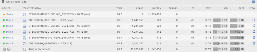

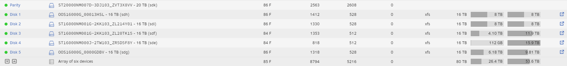

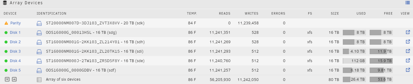

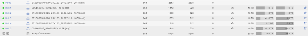

  3. ok, i just replaced all the cables from the power supply to the drives, i was able to remove 3 cables that were not needed after routing the wires again, so knock on wood .... i believe its working again. The only odd thing was after replacing the cables and booting the server, disks 1-5 were not listed and the array was empty, so i added each disk back the way they were before and i added the 20tb parity drive and so far no errors with Parity Sync!! i'm a little nervous about adding the other 3 disk so i might keep it like this for now and just add a 2nd 20tb parity disk in a few months Thanks to itimpi, JonathanM, and mathomas3 for helping me figure this out ... again, and to the other members that posted solutions!! Just wanted to add this site: it help me decide what powersupply to get based on what devices i want to add to the server https://outervision.com

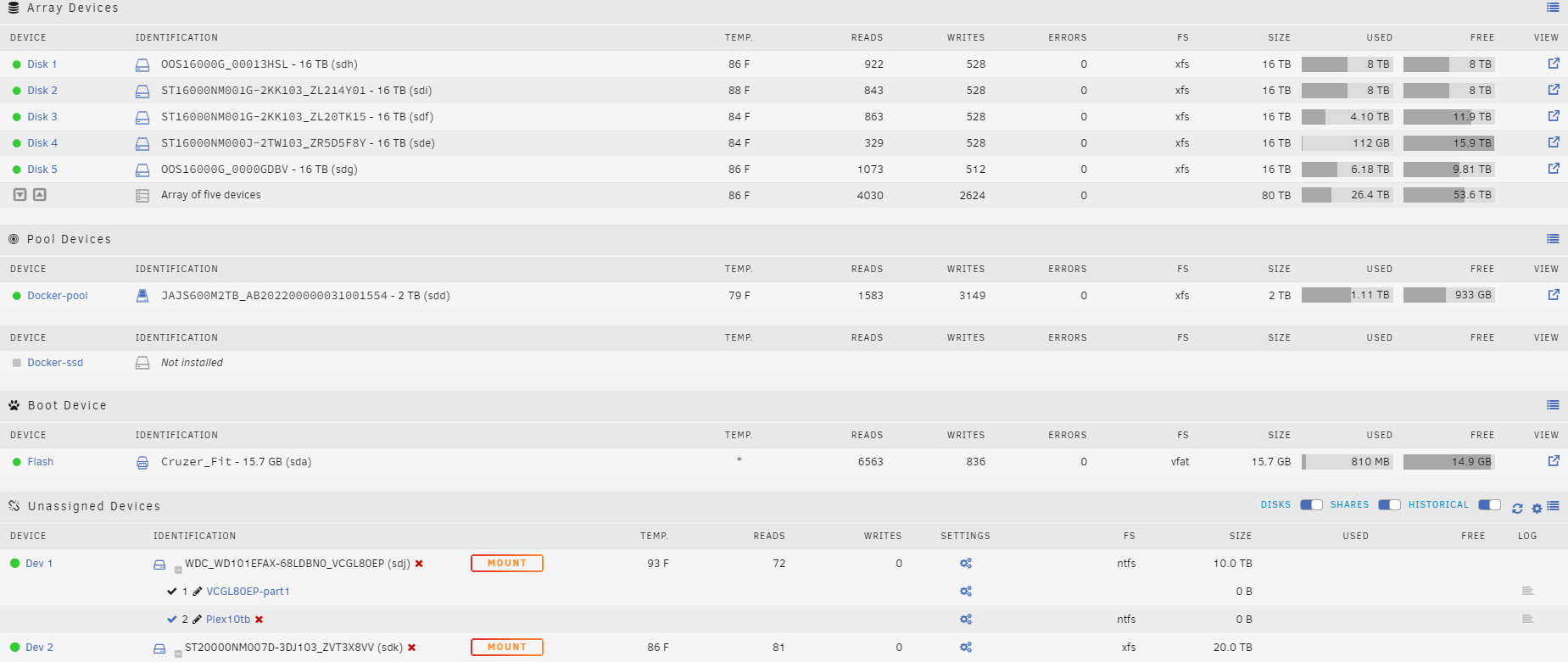

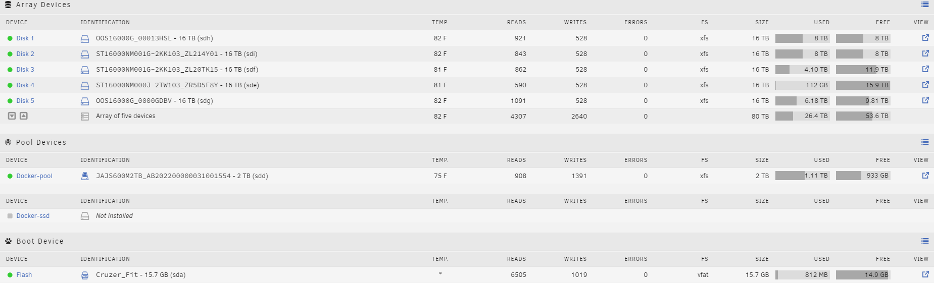

  5. I am using a LSI 9300-16i that i just bought, i also have a Asus Pike with 8 sata ports installed in the pike Slot on my Asus Board but i disabled it in Bios, since i had thought it could be a issue originally (Link below to new controller) https://www.amazon.com/dp/B0B23S57ZS?psc=1&ref=ppx_yo2ov_dt_b_product_details, i have all disk connected directly to my new power supply like the old one except i used the new power supply that has a 3rd sata power connection, to connect directly to disk #5 only , I thought adding a new power supply directly to drive #5 would have worked , so im going to trace everything down as suggested and put in new sata power cables. The person i bought this from has it wired up good so i'll need to figure it out as i go, I also thought about temporally taking my old power supply and plugging it in to the wall and run one of the sata power cables over at a time to see if it changes anything and test if having 2 power supplies at the same time solves the issue or shows which cable could be causing the issue but not sure if that is a good idea Thanks for the info time to order somethings on amazon !! also i had bought this cable below to replace one in the pc earlier that looked sketchy so i'm hoping these are of a good quality to get again https://www.amazon.com/gp/product/B012BPLW08/ref=ppx_yo_dt_b_search_asin_title?ie=UTF8&psc=1

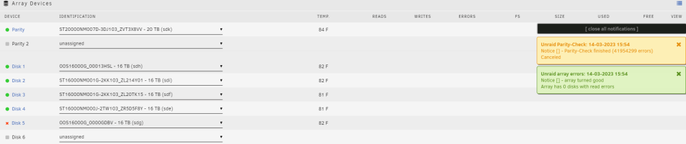

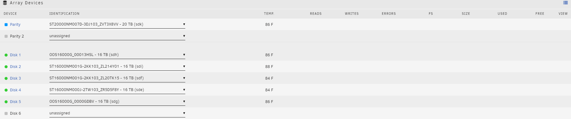

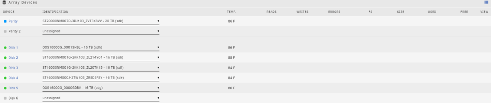

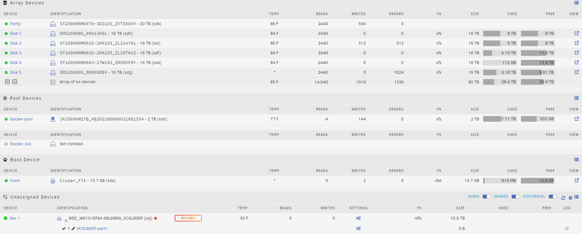

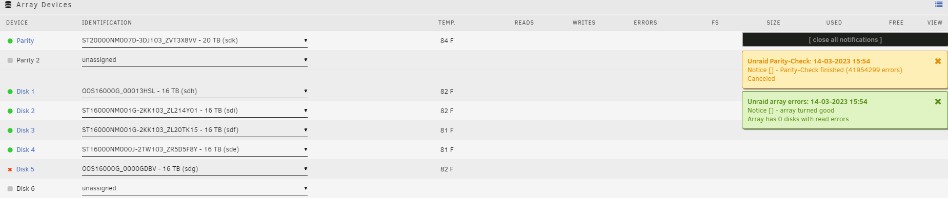

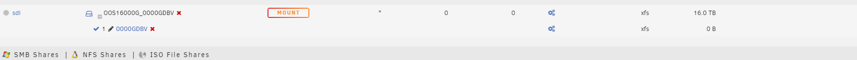

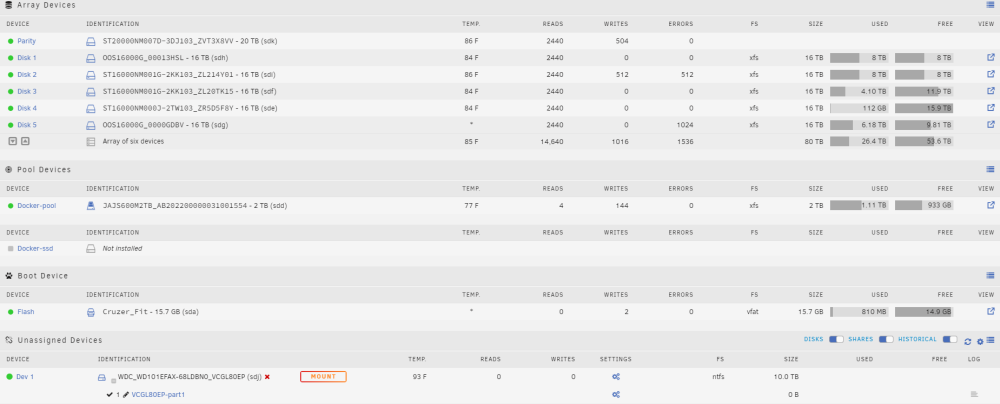

  6. Well i guess i spoke to soon,..... when i try to add my new 20tb drive for parity disk, The Disk #1 drops out or disk #2 reports errors. This goes away if remove the parity drive. The 20tb shows under unassigned devices without issue , so after new sata controller, new higher out power supply, and cables it allowed me to add the 5th drive but now i cant add a 6th drive, im really stumped now, i attached everything i can think of hoping the problem is found 5 added drives after new power supply adding 20tb as parity, then created new config, but this time i checked the box that said Parity was already Valid and no errors all disk added no errors Started Parity sync , has errors and shows a new 16tb drive in unassigned devices that matches the number of disk#5 and has errors this is the syslog, all errors were in red, text error warn system array login Mar 14 15:21:03 Colossus-Mark-2 kernel: md: disk5 write error, sector=18960 Mar 14 15:21:03 Colossus-Mark-2 kernel: md: disk5 write error, sector=18968 Mar 14 15:21:03 Colossus-Mark-2 kernel: md: disk5 write error, sector=18976 Mar 14 15:21:03 Colossus-Mark-2 kernel: md: disk5 write error, sector=18984 Mar 14 15:21:03 Colossus-Mark-2 kernel: md: disk5 write error, sector=18992 Mar 14 15:21:03 Colossus-Mark-2 kernel: md: disk5 write error, sector=19000 Mar 14 15:21:03 Colossus-Mark-2 kernel: md: disk5 write error, sector=19008 Mar 14 15:21:03 Colossus-Mark-2 kernel: md: disk5 write error, sector=19016 Mar 14 15:21:03 Colossus-Mark-2 kernel: md: disk5 write error, sector=19024 Mar 14 15:21:03 Colossus-Mark-2 kernel: md: disk5 write error, sector=19032 Mar 14 15:21:03 Colossus-Mark-2 kernel: md: disk5 write error, sector=19040 Mar 14 15:21:03 Colossus-Mark-2 kernel: md: disk5 write error, sector=19048 Mar 14 15:21:03 Colossus-Mark-2 kernel: md: disk5 write error, sector=19056 Mar 14 15:21:03 Colossus-Mark-2 kernel: md: disk5 write error, sector=19064 Mar 14 15:21:03 Colossus-Mark-2 kernel: md: disk5 write error, sector=19072 Mar 14 15:21:03 Colossus-Mark-2 kernel: md: disk5 write error, sector=19080 Mar 14 15:21:03 Colossus-Mark-2 kernel: md: disk5 write error, sector=19088 Mar 14 15:21:03 Colossus-Mark-2 kernel: md: disk5 write error, sector=19096 Mar 14 15:21:03 Colossus-Mark-2 kernel: md: disk5 write error, sector=19104 Mar 14 15:21:03 Colossus-Mark-2 kernel: md: disk5 write error, sector=19112 Mar 14 15:21:03 Colossus-Mark-2 kernel: md: disk5 write error, sector=19120 Mar 14 15:21:03 Colossus-Mark-2 kernel: md: disk5 write error, sector=19128 Mar 14 15:21:03 Colossus-Mark-2 kernel: md: disk5 write error, sector=19136 Mar 14 15:21:03 Colossus-Mark-2 kernel: md: disk5 write error, sector=19144 Mar 14 15:21:03 Colossus-Mark-2 kernel: md: disk5 write error, sector=19152 Mar 14 15:21:03 Colossus-Mark-2 kernel: md: disk5 write error, sector=19160 Mar 14 15:21:03 Colossus-Mark-2 kernel: md: disk5 write error, sector=19168 Mar 14 15:21:03 Colossus-Mark-2 kernel: md: disk5 write error, sector=19176 Mar 14 15:21:03 Colossus-Mark-2 kernel: md: disk5 write error, sector=19184 Mar 14 15:21:03 Colossus-Mark-2 kernel: md: disk5 write error, sector=19192 Mar 14 15:21:03 Colossus-Mark-2 kernel: md: disk5 write error, sector=19200 Mar 14 15:21:03 Colossus-Mark-2 kernel: md: disk5 write error, sector=19208 Mar 14 15:21:03 Colossus-Mark-2 kernel: md: disk5 write error, sector=19216 Mar 14 15:21:03 Colossus-Mark-2 kernel: md: disk5 write error, sector=19224 Mar 14 15:21:03 Colossus-Mark-2 kernel: md: disk5 write error, sector=19232 Mar 14 15:21:03 Colossus-Mark-2 kernel: md: disk5 write error, sector=19240 Mar 14 15:21:03 Colossus-Mark-2 kernel: md: disk5 write error, sector=19248 Mar 14 15:21:03 Colossus-Mark-2 kernel: md: disk5 write error, sector=19256 Mar 14 15:21:03 Colossus-Mark-2 kernel: md: disk5 write error, sector=19264 Mar 14 15:21:03 Colossus-Mark-2 kernel: md: disk5 write error, sector=19272 Mar 14 15:21:03 Colossus-Mark-2 kernel: md: disk5 write error, sector=19280 Mar 14 15:21:03 Colossus-Mark-2 kernel: md: disk5 write error, sector=19288 Mar 14 15:21:03 Colossus-Mark-2 kernel: md: disk5 write error, sector=19296 Mar 14 15:21:03 Colossus-Mark-2 kernel: md: disk5 write error, sector=19304 Mar 14 15:21:03 Colossus-Mark-2 kernel: md: disk5 write error, sector=19312 Mar 14 15:21:03 Colossus-Mark-2 kernel: md: disk5 write error, sector=19320 Mar 14 15:21:03 Colossus-Mark-2 kernel: md: disk5 write error, sector=19328 Mar 14 15:21:03 Colossus-Mark-2 kernel: md: disk5 write error, sector=19336 Mar 14 15:21:03 Colossus-Mark-2 kernel: md: disk5 write error, sector=19344 Mar 14 15:21:03 Colossus-Mark-2 kernel: md: disk5 write error, sector=19352 Mar 14 15:21:03 Colossus-Mark-2 kernel: md: disk5 write error, sector=19360 Mar 14 15:21:03 Colossus-Mark-2 kernel: md: disk5 write error, sector=19368 Mar 14 15:21:03 Colossus-Mark-2 kernel: md: disk5 write error, sector=19376 Mar 14 15:21:03 Colossus-Mark-2 kernel: md: disk5 write error, sector=19384 Mar 14 15:21:03 Colossus-Mark-2 kernel: md: disk5 write error, sector=19392 Mar 14 15:21:03 Colossus-Mark-2 kernel: md: disk5 write error, sector=19400 Mar 14 15:21:03 Colossus-Mark-2 kernel: md: disk5 write error, sector=19408 Mar 14 15:21:03 Colossus-Mark-2 kernel: md: disk5 write error, sector=19416 Mar 14 15:21:03 Colossus-Mark-2 kernel: md: disk5 write error, sector=19424 Mar 14 15:21:03 Colossus-Mark-2 kernel: md: disk5 write error, sector=19432 Mar 14 15:21:03 Colossus-Mark-2 kernel: md: disk5 write error, sector=19400 Mar 14 15:21:03 Colossus-Mark-2 kernel: md: disk5 write error, sector=19408 Mar 14 15:21:03 Colossus-Mark-2 kernel: md: disk5 write error, sector=19416 Mar 14 15:21:03 Colossus-Mark-2 kernel: md: disk5 write error, sector=19424 Mar 14 15:21:03 Colossus-Mark-2 kernel: md: disk5 write error, sector=19432 Mar 14 15:21:03 Colossus-Mark-2 kernel: md: disk5 write error, sector=19440 Mar 14 15:21:03 Colossus-Mark-2 kernel: md: disk5 write error, sector=19448 Mar 14 15:21:03 Colossus-Mark-2 kernel: md: recovery thread: exit status: -4 Mar 14 15:21:03 Colossus-Mark-2 kernel: mpt3sas_cm0: log_info(0x31110e03): originator(PL), code(0x11), sub_code(0x0e03) Mar 14 15:21:03 Colossus-Mark-2 kernel: mpt3sas_cm0: log_info(0x31110e03): originator(PL), code(0x11), sub_code(0x0e03) Mar 14 15:21:03 Colossus-Mark-2 kernel: sd 11:0:4:0: [sdi] tag#3273 UNKNOWN(0x2003) Result: hostbyte=0x0b driverbyte=DRIVER_OK cmd_age=0s Mar 14 15:21:03 Colossus-Mark-2 kernel: sd 11:0:4:0: [sdi] tag#3273 CDB: opcode=0x88 88 00 00 00 00 00 00 00 00 78 00 00 00 08 00 00 Mar 14 15:21:03 Colossus-Mark-2 kernel: I/O error, dev sdi, sector 120 op 0x0:(READ) flags 0x80700 phys_seg 1 prio class 0 Mar 14 15:21:03 Colossus-Mark-2 unassigned.devices: Disk with ID 'OOS16000G_0000GDBV (sdb)' is not set to auto mount. Mar 14 15:21:03 Colossus-Mark-2 unassigned.devices: Disk with ID 'OOS16000G_0000GDBV (sdc)' is not set to auto mount. Mar 14 15:21:03 Colossus-Mark-2 unassigned.devices: Disk with ID 'WDC_WD101EFAX-68LDBN0_VCGL80EP (sdj)' is not set to auto mount. Mar 14 15:21:03 Colossus-Mark-2 unassigned.devices: Disk with ID 'OOS16000G_0000GDBV (sdl)' is not set to auto mount. Mar 14 15:21:03 Colossus-Mark-2 kernel: sd 11:0:4:0: Power-on or device reset occurred Mar 14 15:21:03 Colossus-Mark-2 emhttpd: error: hotplug_devices, 1730: No medium found (123): Error: tagged device OOS16000G_0000GDBV was (sdg) is now (sdl) Mar 14 15:21:03 Colossus-Mark-2 emhttpd: read SMART /dev/sdl Mar 14 15:21:03 Colossus-Mark-2 kernel: emhttpd[6434]: segfault at 674 ip 0000559e173189d4 sp 00007ffce179a5a0 error 4 in emhttpd[559e17306000+21000] Mar 14 15:21:03 Colossus-Mark-2 kernel: Code: 8e 27 01 00 48 89 45 f8 48 8d 05 72 27 01 00 48 89 45 f0 e9 79 01 00 00 8b 45 ec 89 c7 e8 89 b1 ff ff 48 89 45 d8 48 8b 45 d8 <8b> 80 74 06 00 00 85 c0 0f 94 c0 0f b6 c0 89 45 d4 48 8b 45 e0 48 Mar 14 15:21:04 Colossus-Mark-2 kernel: mpt3sas_cm0: log_info(0x31110e03): originator(PL), code(0x11), sub_code(0x0e03) Mar 14 15:21:04 Colossus-Mark-2 kernel: sd 11:0:4:0: Power-on or device reset occurred Mar 14 15:21:04 Colossus-Mark-2 kernel: mpt3sas_cm0: log_info(0x31110e03): originator(PL), code(0x11), sub_code(0x0e03) Mar 14 15:21:05 Colossus-Mark-2 kernel: sd 11:0:4:0: Power-on or device reset occurred Mar 14 15:21:05 Colossus-Mark-2 kernel: mpt3sas_cm0: log_info(0x31110e03): originator(PL), code(0x11), sub_code(0x0e03) Mar 14 15:21:06 Colossus-Mark-2 kernel: sd 11:0:4:0: Power-on or device reset occurred Mar 14 15:21:06 Colossus-Mark-2 kernel: mpt3sas_cm0: log_info(0x31110e03): originator(PL), code(0x11), sub_code(0x0e03) Mar 14 15:21:06 Colossus-Mark-2 kernel: sd 11:0:4:0: Power-on or device reset occurred Mar 14 15:21:24 Colossus-Mark-2 flash_backup: adding task: /usr/local/emhttp/plugins/dynamix.my.servers/scripts/UpdateFlashBackup update Mar 14 15:30:00 Colossus-Mark-2 unassigned.devices: Removing configuration 'WDC_WD80EFZX-68UW8N0_R6GK332Y'. Mar 14 15:30:04 Colossus-Mark-2 unassigned.devices: Removing configuration 'ST16000NM001G-2KK103_ZL214Y01'. Mar 14 15:30:08 Colossus-Mark-2 unassigned.devices: Removing configuration 'ST16000NM001G-2KK103_ZL23E5CT'. Mar 14 15:30:24 Colossus-Mark-2 flash_backup: adding task: /usr/local/emhttp/plugins/dynamix.my.servers/scripts/UpdateFlashBackup update during shutdown Mar 14 15:43:10 Colossus-Mark-2 nginx: 2023/03/14 15:43:10 [error] 6814#6814: *30229 upstream timed out (110: Connection timed out) while reading response header from upstream, client: 192.168.1.184, server: , request: "POST /update.htm HTTP/1.1", upstream: "http://unix:/var/run/emhttpd.socket/update.htm", host: "192.168.1.33", referrer: "http://192.168.1.33/Main" Mar 14 15:44:59 Colossus-Mark-2 shutdown[32577]: shutting down for system reboot Mar 14 15:44:59 Colossus-Mark-2 init: Switching to runlevel: 6 Mar 14 15:44:59 Colossus-Mark-2 flash_backup: stop watching for file changes Mar 14 15:44:59 Colossus-Mark-2 init: Trying to re-exec init Mar 14 15:46:31 Colossus-Mark-2 root: Status of all loop devices Mar 14 15:46:31 Colossus-Mark-2 root: /dev/loop1: [2049]:11 (/boot/bzmodules) Mar 14 15:46:31 Colossus-Mark-2 root: /dev/loop2: [2097]:1073741961 (/mnt/docker-pool/system/docker/docker.img) Mar 14 15:46:31 Colossus-Mark-2 root: /dev/loop0: [2049]:9 (/boot/bzfirmware) Mar 14 15:46:31 Colossus-Mark-2 root: /dev/loop3: [2097]:2149437262 (/mnt/docker-pool/system/libvirt/libvirt.img) Mar 14 15:46:31 Colossus-Mark-2 root: Active pids left on /mnt/* Mar 14 15:46:31 Colossus-Mark-2 root: USER PID ACCESS COMMAND Mar 14 15:46:31 Colossus-Mark-2 root: /mnt/addons: root kernel mount /mnt/addons Mar 14 15:46:31 Colossus-Mark-2 root: /mnt/disk1: root kernel mount /mnt/disk1 Mar 14 15:46:31 Colossus-Mark-2 root: /mnt/disk2: root kernel mount /mnt/disk2 Mar 14 15:46:31 Colossus-Mark-2 root: /mnt/disk3: root kernel mount /mnt/disk3 Mar 14 15:46:31 Colossus-Mark-2 root: /mnt/disk4: root kernel mount /mnt/disk4 Mar 14 15:46:31 Colossus-Mark-2 root: /mnt/disk5: root kernel mount /mnt/disk5 Mar 14 15:46:31 Colossus-Mark-2 root: /mnt/disks: root kernel mount /mnt/disks Mar 14 15:46:31 Colossus-Mark-2 root: /mnt/docker-pool: root kernel mount /mnt/docker-pool Mar 14 15:46:31 Colossus-Mark-2 root: /mnt/remotes: root kernel mount /mnt/remotes Mar 14 15:46:31 Colossus-Mark-2 root: /mnt/rootshare: root kernel mount /mnt/rootshare Mar 14 15:46:31 Colossus-Mark-2 root: /mnt/user: root kernel mount /mnt/user Mar 14 15:46:31 Colossus-Mark-2 root: /mnt/user0: root kernel mount /mnt/user0 Mar 14 15:46:31 Colossus-Mark-2 root: Active pids left on /dev/md* Mar 14 15:46:31 Colossus-Mark-2 root: USER PID ACCESS COMMAND Mar 14 15:46:31 Colossus-Mark-2 root: /dev/md1: root kernel mount /mnt/disk1 Mar 14 15:46:31 Colossus-Mark-2 root: /dev/md2: root kernel mount /mnt/disk2 Mar 14 15:46:31 Colossus-Mark-2 root: /dev/md3: root kernel mount /mnt/disk3 Mar 14 15:46:31 Colossus-Mark-2 root: /dev/md4: root kernel mount /mnt/disk4 Mar 14 15:46:31 Colossus-Mark-2 root: /dev/md5: root kernel mount /mnt/disk5 Mar 14 15:46:31 Colossus-Mark-2 root: Generating diagnostics... Mar 14 15:46:42 Colossus-Mark-2 unraid-api[7197]: 👋 Farewell. UNRAID API shutting down! Mar 14 15:46:54 Colossus-Mark-2 avahi-daemon[32868]: Got SIGTERM, quitting. Mar 14 15:46:54 Colossus-Mark-2 avahi-dnsconfd[32879]: read(): EOF Mar 14 15:46:54 Colossus-Mark-2 avahi-daemon[32868]: Leaving mDNS multicast group on interface vethe82a48c.IPv6 with address fe80::b4f3:4fff:fed1:2b6d. Mar 14 15:46:54 Colossus-Mark-2 avahi-daemon[32868]: Leaving mDNS multicast group on interface docker0.IPv6 with address fe80::42:f1ff:feb4:a653. Mar 14 15:46:54 Colossus-Mark-2 avahi-daemon[32868]: Leaving mDNS multicast group on interface docker0.IPv4 with address 172.17.0.1. Mar 14 15:46:54 Colossus-Mark-2 avahi-daemon[32868]: Leaving mDNS multicast group on interface br0.IPv4 with address 192.168.1.33. Mar 14 15:46:54 Colossus-Mark-2 avahi-daemon[32868]: Leaving mDNS multicast group on interface lo.IPv6 with address ::1. Mar 14 15:46:54 Colossus-Mark-2 avahi-daemon[32868]: Leaving mDNS multicast group on interface lo.IPv4 with address 127.0.0.1. Mar 14 15:46:54 Colossus-Mark-2 avahi-daemon[32868]: avahi-daemon 0.8 exiting. Mar 14 15:46:54 Colossus-Mark-2 wsdd2[32834]: 'Terminated' signal received. Mar 14 15:46:54 Colossus-Mark-2 winbindd[32840]: [2023/03/14 15:46:54.138920, 0] ../../source3/winbindd/winbindd_dual.c:1957(winbindd_sig_term_handler) Mar 14 15:46:54 Colossus-Mark-2 winbindd[32840]: Got sig[15] terminate (is_parent=0) Mar 14 15:46:54 Colossus-Mark-2 wsdd2[32834]: terminating. Mar 14 15:46:54 Colossus-Mark-2 winbindd[32837]: [2023/03/14 15:46:54.139018, 0] ../../source3/winbindd/winbindd_dual.c:1957(winbindd_sig_term_handler) Mar 14 15:46:54 Colossus-Mark-2 winbindd[32837]: Got sig[15] terminate (is_parent=1) Mar 14 15:46:54 Colossus-Mark-2 winbindd[34527]: [2023/03/14 15:46:54.139941, 0] ../../source3/winbindd/winbindd_dual.c:1957(winbindd_sig_term_handler) Mar 14 15:46:54 Colossus-Mark-2 winbindd[34527]: Got sig[15] terminate (is_parent=0) Mar 14 15:46:54 Colossus-Mark-2 rpc.mountd[25821]: Caught signal 15, un-registering and exiting. Mar 14 15:46:55 Colossus-Mark-2 kernel: nfsd: last server has exited, flushing export cache Mar 14 15:46:55 Colossus-Mark-2 ntpd[1971]: ntpd exiting on signal 1 (Hangup) Mar 14 15:46:55 Colossus-Mark-2 ntpd[1971]: 127.127.1.0 local addr 127.0.0.1 -> <null> Mar 14 15:46:55 Colossus-Mark-2 ntpd[1971]: 216.239.35.0 local addr 192.168.1.33 -> <null> Mar 14 15:46:55 Colossus-Mark-2 ntpd[1971]: 216.239.35.4 local addr 192.168.1.33 -> <null> Mar 14 15:46:55 Colossus-Mark-2 ntpd[1971]: 216.239.35.8 local addr 192.168.1.33 -> <null> Mar 14 15:46:55 Colossus-Mark-2 ntpd[1971]: 216.239.35.12 local addr 192.168.1.33 -> <null> Mar 14 15:46:55 Colossus-Mark-2 rc.inet1: dhcpcd -q -k -4 br0 Mar 14 15:46:55 Colossus-Mark-2 dhcpcd[34664]: sending signal ALRM to pid 1831 Mar 14 15:46:55 Colossus-Mark-2 dhcpcd[34664]: waiting for pid 1831 to exit Mar 14 15:46:55 Colossus-Mark-2 dhcpcd[1832]: received SIGALRM, releasing Mar 14 15:46:55 Colossus-Mark-2 dhcpcd[1832]: br0: removing interface after reboot after removing parity drive and doing a new config, started the array and data disk are back to normal i attached diagnostics before taking the array off line and doing a reboot, i have to reboot the system to stop the parity process, The pause and stop buttons don't seem to work: colossus-mark-2-diagnostics-erros with parity i attached another after reboot and all drives are normal but no parity colossus-mark-2-diagnostics-afterreboot noParity colossus-mark-2-diagnostics-erros with parity.zip colossus-mark-2-diagnostics-afterreboot noParity.zip

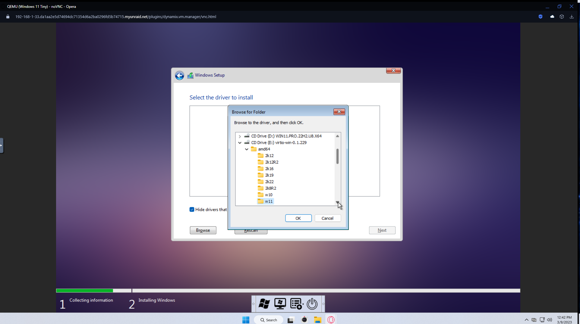

  13. This is what i did to get a network connection, you have to edit the VM and change the network model to e1000, This worked for me
  14. Yes i was able to install the virtio-win-guest-tools.exe but i had to set the Network Model e1000 so i could have access to the network and transfer the guest-tools over first.
  15. i just did this with ghoste spectre tiny 11 Virtio Files: https://fedorapeople.org/groups/virt/virtio-win/direct-downloads/archive-virtio/virtio-win-0.1.229-1/
