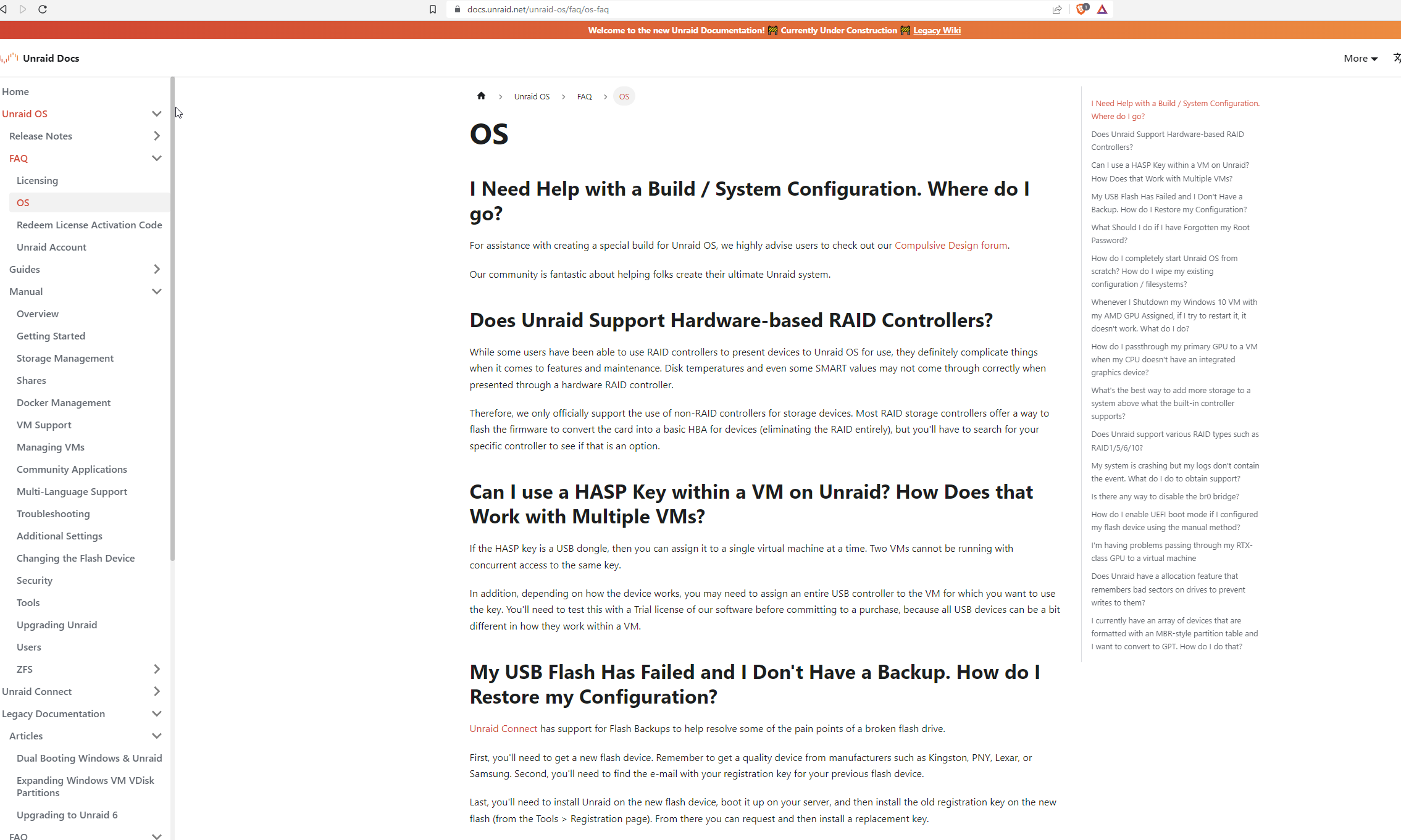

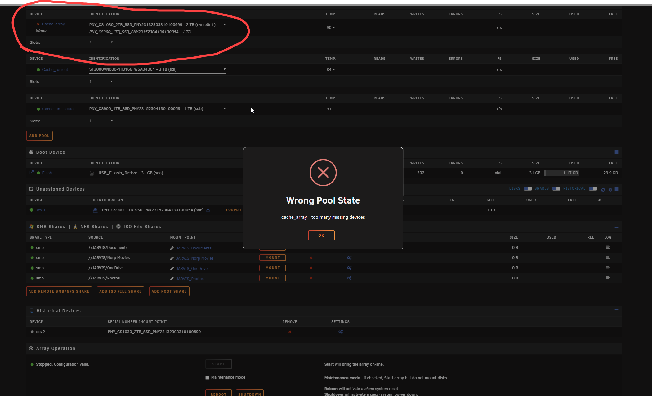

  1. See screenshot. I have looked through the FAQs and nothing there.. Not sure unRaid moved information or not. Can you send me a link to it? I misspoke about the "exact" same error. Let me clarify. All the videos I have watched has said " it replace an array disk, stop the array, removed the disk from the slot that you want to replace, power down, replace drive, power up, put the new disk in the slot, start array, and the array should rebuild." Every time I have done that i get an error to the effects of "wrong array state" too many missing devices" and array will not start.. I have post about this in the forum somewhere but by the time it was asked for the diagnostic file, I had already had a work around.. All I am saying is that it doesn't seem to be as easy as the videos or the step through guide that I found on the unraid "how tos". I am still new to unraid so it can be user error.. There seems to be some part of the process missing..

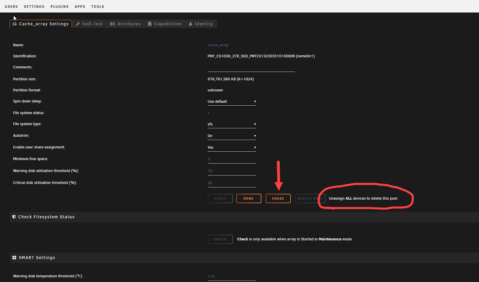

  2. I am having the same issue as the above poster. I always have this issue (with array or with a pool drive) when I go to replace a disk in the array with a larger one. It never works out like the guide instructions says. So far I have been able to work around it. But I would like to get to the bottom of it as one day I may not be able to do the work around. So when you say "erase" do you mean (see screenshots), actually click the erase button or do you mean go into the shares and remove all instances of the pool being called out there? I have exactly the same problem with an Array disk swap out. It seems to never work out as the instructions say it should be
