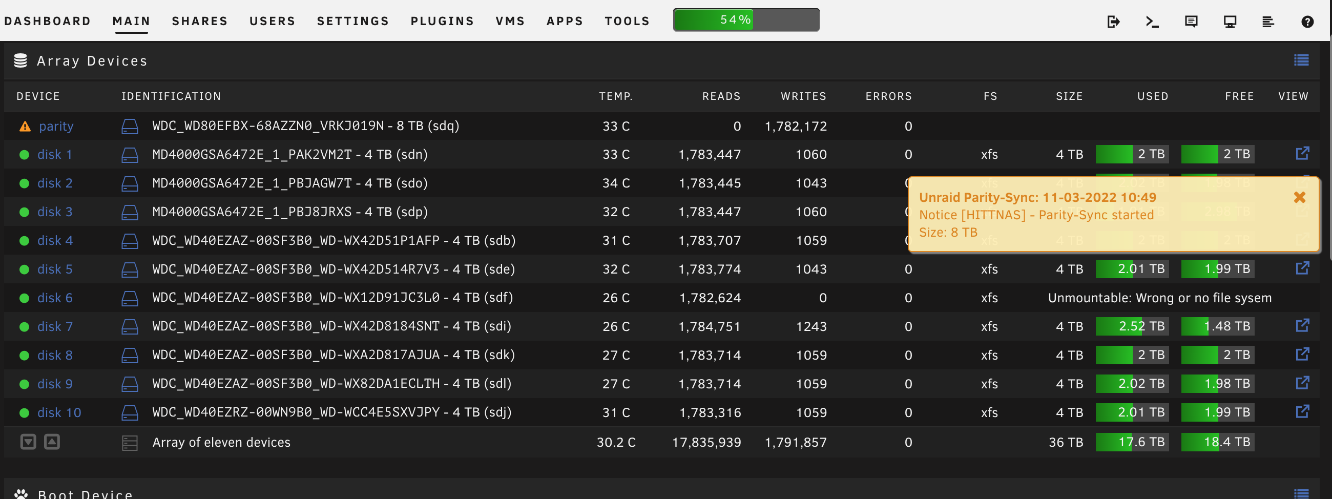

  10. Good morning! I had an issue yesterday that I thought I solved with communities help. Parity sync was running fine at 130 mb/s My house lost power during the parity sync. now power is back but sync is now only running at 6mb/s. diags are attached any further assistance would be appreciated! hittnas-diagnostics-20220312-0909.zip

  13. Thank you this is solved all my original issues parity sync is running at 130 mb/s and shows the correct size...the issue i have now is once i did the new config one my my drives is showing unmountable/ wrong or no file system. any insight on that? Again thank you for solving the other issues
  14. This may sound like my best course of action.. couple questions.. how do I start a new config? did not seem obvious to me. Will it keep all my docker settings?
  15. T Thank you.. so if i am understanding this correctly since the original parity was 4tb that is what it is rebuilding onto the new 8tb drive and i should not worry that the sync shows 4tb
