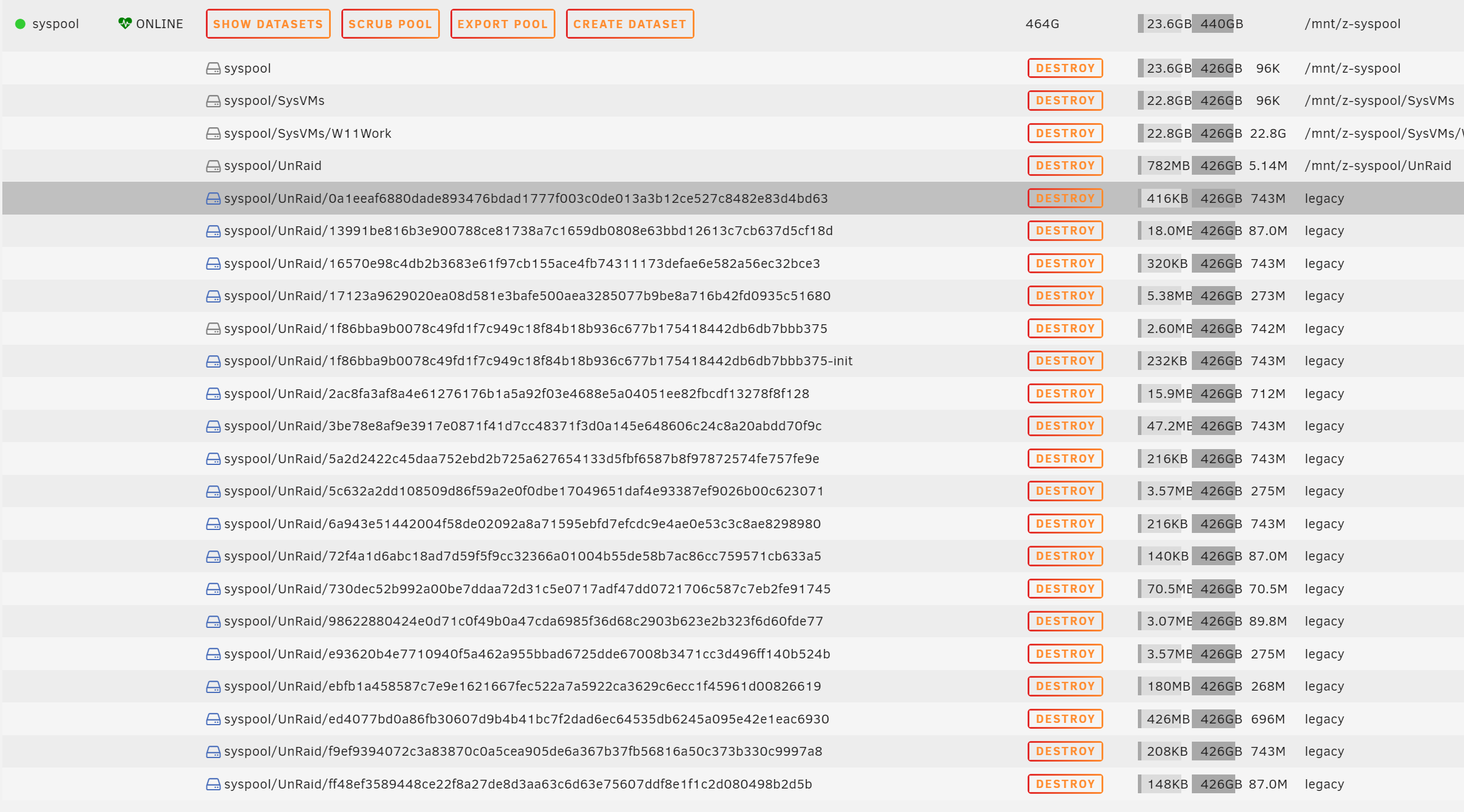

  7. @ich777 Just a quick question: After changing to "directory" instead of docker.img I see a lot of datasets created under my ZFS datapool. Do you see/have the same outcome?
  8. Hey ich77, yes I overlooked this line. Ok, now I understand why your Dockers are working... Because they are using the regular file system and are not mounted within a .img. That should be very fine with ZFS as well. Finally I'll switch to exactly this as I see no advantage of using an .img file for Docker compared to a directory. Regarding the shutdown you are right, one should use the given shutdown script which in this case is the powerdown cmd even though in fact it does nothing special. For me testing this system I actually don't need to care as my only intention is to bring down the system by any means... 😈 In the meantime I found an empty USB stick and tried what I said above. Did a clean zfs create without any special options and with testpool as its name. In short without further explanation or screenshots: Still didn't work this way. I believe it has something to do with the way UnRaid is writing to the docker.img file while this file sits on ZFS. First I thought it may additionally has to do with the btrfs filesystem inside the docker.img file which causes trouble when on ZFS, but trying XFS didn't work either. Hangs at the very same point. So for the moment this will be the end of my investigations because a working solution has been found which has no drawbacks in my opinion. Thanks to all for being with me, with best regards DaKarli

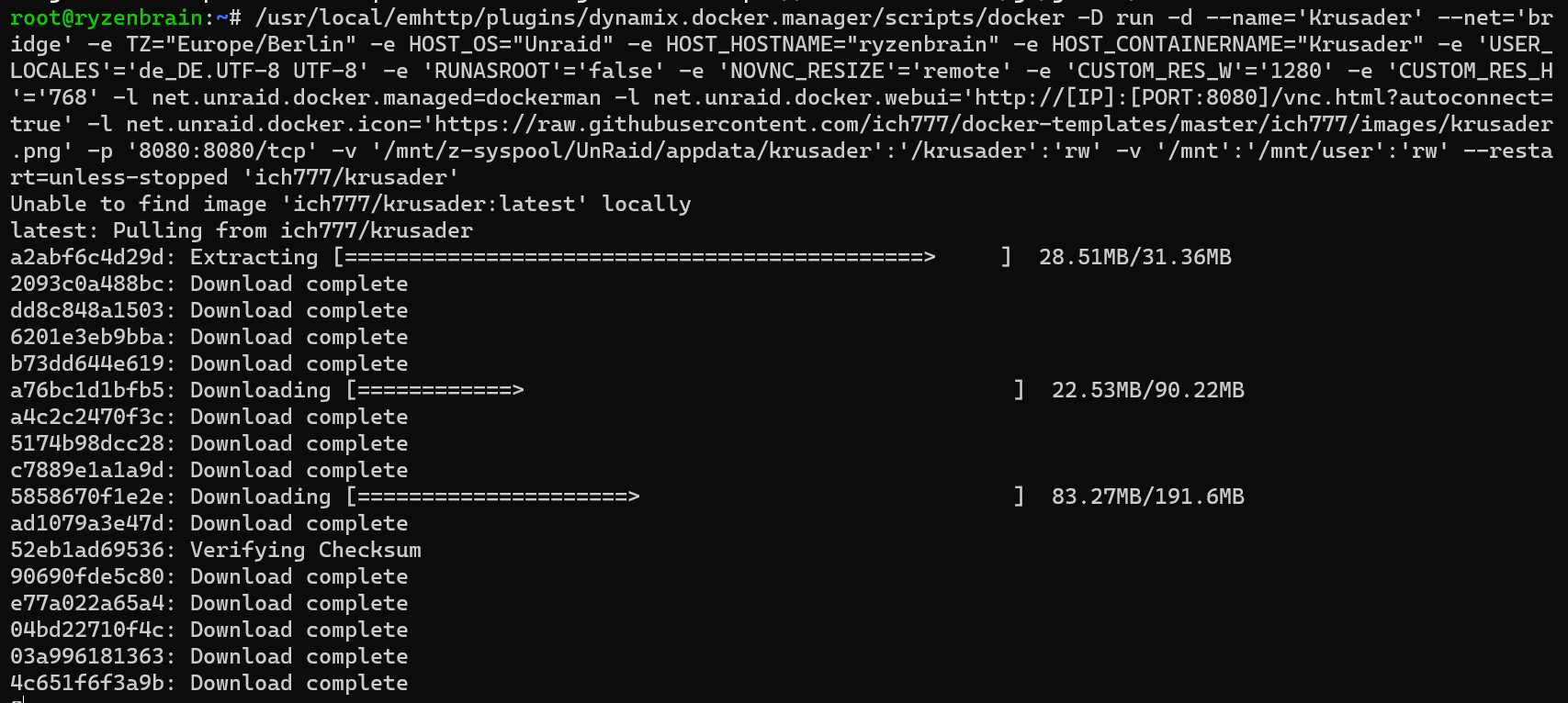

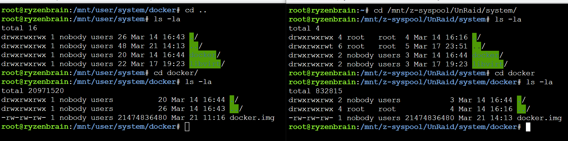

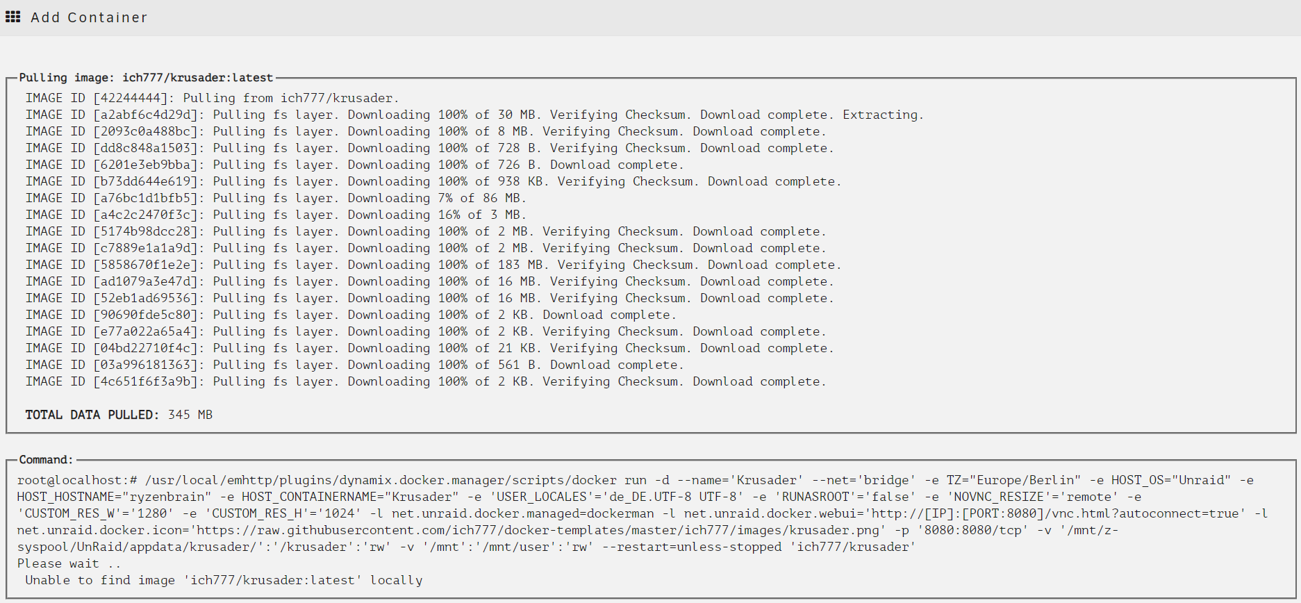

  11. Unfortunately, Docker on ZFS still gives me trouble (just tried again to confirm, see the following pictures and description). VMs on ZFS work, even with the libvirt.img residing on ZFS but as a security measure I still keep the libvirt.img in the standard folder to ensure it is not the .img which causes trouble. Setting Docker to a path on my ZFS pool the installation e.g. for Krusader fails/hangs at the shown point and the GUI does not respond anymore. I can only access the machine on the host terminal and even shutdown -r -n now does not work, so a hard-reset is necessary. I tried to install Krusader withContainer Path = /mnt/z-syspool/UnRaid/appdata/krusader/ My docker.cfg looks like this: The docker.log: The error.log (IP addresses and names have been "x"ed): By the way, the same error could be seen with IPv4 so IPv6 is not the reason. File permissions also look ok on the regular share and on the ZFS share: Acccording to the error.log, I'd say it is not a problem with the .img files themself but more of a problem somewhere in the way PHP is accessing these files? If there is something else you want me to try, just drop me a line. Regards DaKarli. ..
