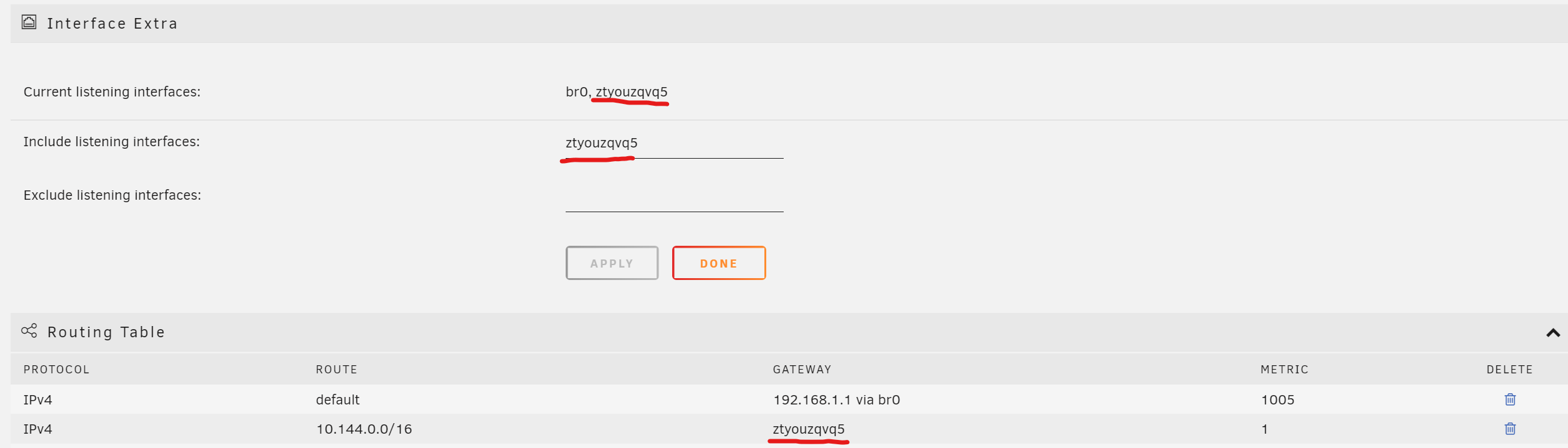

  4. For anyone looking for a solution, I was able to connect to my unraid 6.12.2 from a phone on zerotier 1.10.6. Just go to settings -> Network Settings. In Routing Table section find your zerotier ip and copy interface name from gateway column. Paste the interface name into "Include listening interfaces" field under Interface Extra section, hit apply, and it should all be working.
