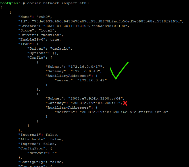

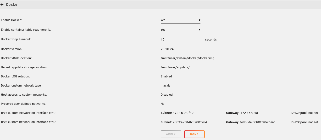

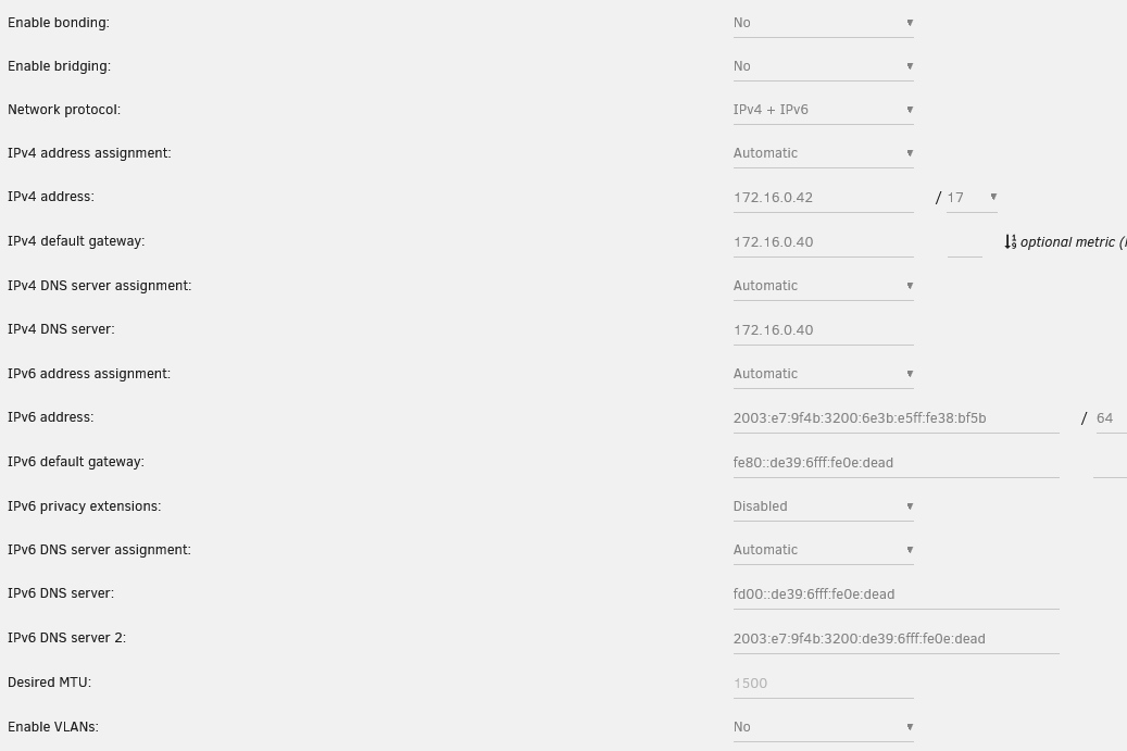

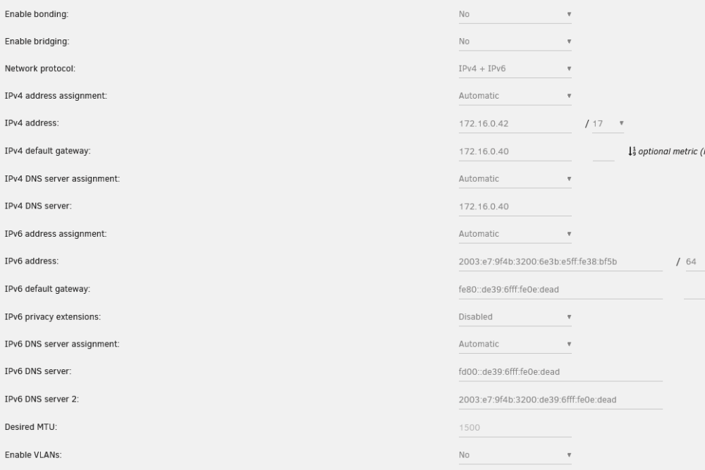

  6. Hi! I use Unraid Version: 6.12.6. The only router on the LAN is AVM Fritz!Box 7590 with dual stack and dynamic IPv4/ipV6 and it advertises my LAN-IPv6-prefix and DNS to the LAN. Unraids network-config sets just IPv4+IPv6 and eth0, no bonding and no bridging. My docker-config sets macvlan and bind it to eth0 with NO dhcp set: My docker containers get two global IPv6 addresses, one from the container by SLAAC with the advertised prefix and the other one (red cross) seems to comes from docker. Docker configures also a wrong gateway-address. IPv4-addresses are okay. So, why does docker assign IPv6 addresses to containers even though dhcp pool is disabled and also why does docker assigns a wrong gateway? In addition to this, if the IPv6-prefix of my LAN changes, docker does not update its IPv6-subnet on the fly. The SLAAC-address in the containers are updated as expected. So, how is it possible to disable dockers DHCPv6?
