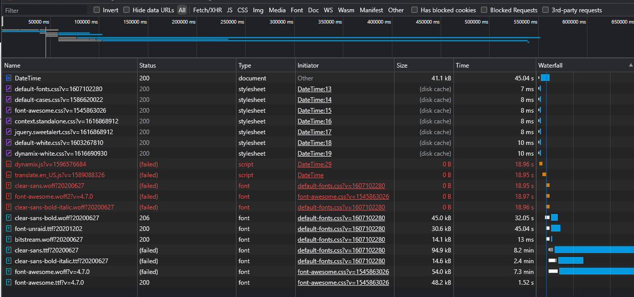

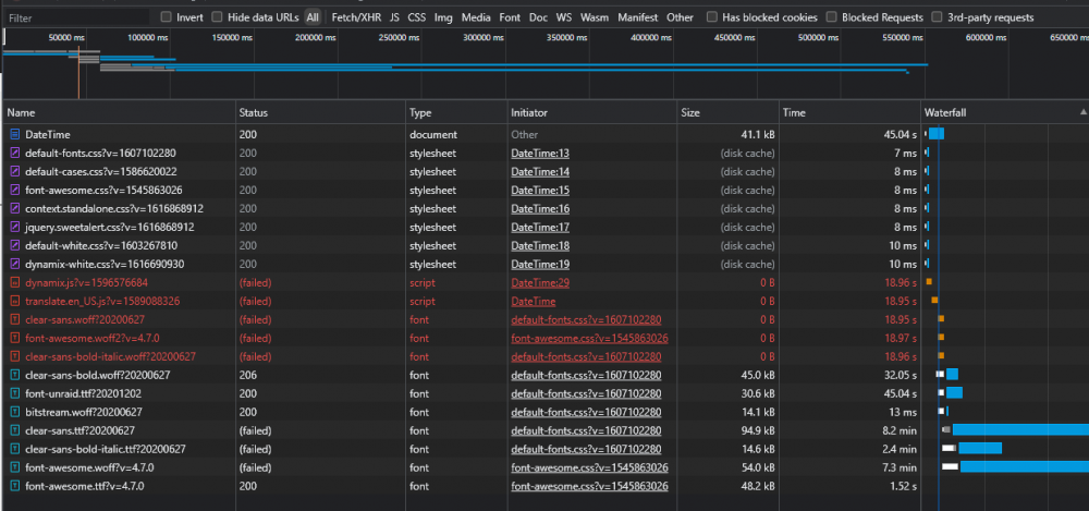

anyone ever had a similair problem? ive tried searching this forum, but most people seem to have problems with accessing webui by name or outside lan. Or they have lost connection completely, but for me the connection isnt completely dead, but its just super duper slow, see picture above, took me 550sec to load a webui and iirc it was still spinning/loading
[SOLVED] WebUI is super slow (or doesnt load at all) but GUI mode is working fine

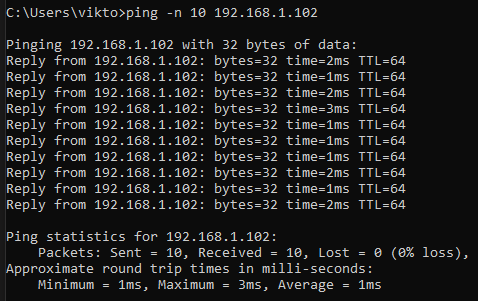

Yesterday i started my server like normally but the login site took forever (more like 3 minutes) to load, and even then the site was still loading but i could see the login form. When i then got to /Main thats when i realized how bad it was. I initially thought that there was something wrong with the internet connection to my unraid server, but after testing GUI mode it worked completely fine in the box. 250mb up and down, 10ms ping, was able to ping 8.8.8.8 and google.com etc. I can also access my plex library from a plex client, thought it only allows 720p and it shows the server as being "indirectly" even thought im on the same network. But when i try to access any WebUI, it either just loads till timeout or it loads partially (see network activity image attached). but everything was accessable in GUI mode. so this got me thinking it must be somthing locally. The weirdest part is that i can succesfully ping my server (192.168.1.102) from my pc (see image below) and it doenst seem to have any issues at all. ive also tried changing the IP of my server but it didnt solve my problem. Im not sure where to go from here, so any suggestions on what i should try is highly appreciated. also wanna say that downloading syslog and diagnostics file is also super slow so its not only connected to webuis, will be uploading those too once theyve finished downloading syslog
