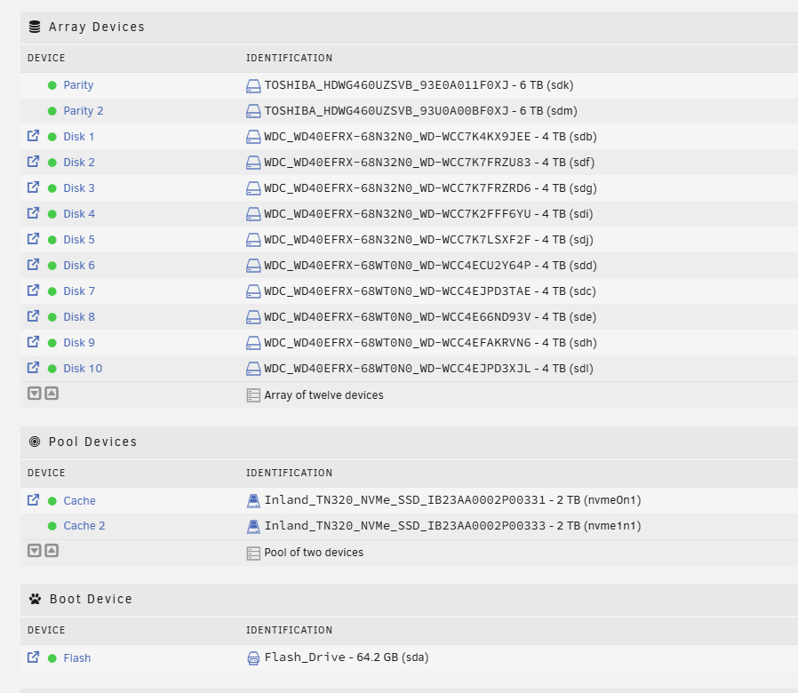

  4. I recently rebuilt my Unraid box in a Rosewill 12-bay hot swap rack mount case. Replaced motherboard, processor, added more RAM, added mirror parity and mirror cache and array. It seems that about every 4 or so days I go to login and end up having to restart the server (which of course starts the parity sync all over on a pair of 6 TB drives). Where can I look to find historical logs as to what the issue possible could be? I am still using the same USB stick from the last 4+ yrs - should that be the first thing I replace and migrate my activation key? If so - what is a good recommended brand/size? Thank you in advance.

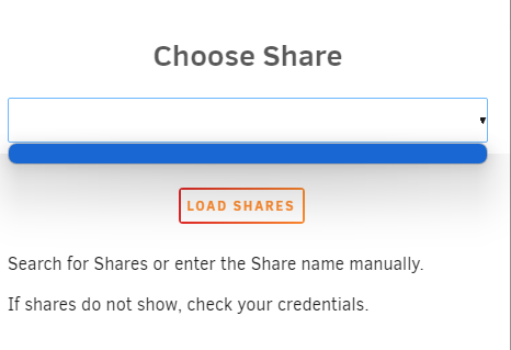

  8. Rebuilt my UnRaid box (6.12.6) to make it bigger and stronger (heftier CPU, 64 gb ram, dual drive cache, dual nvme drive pool, and 10 drive array). Wanting to transition it as my main NAS now instead of the backup. I wish to create drive mappings from UnRaid to my OMV (Open Media Vault) NAS to set up rsync between the 2. If I start the wizard to add a remote NFS share within UD Plus - it finds the OMV server, but when I try to scan for shares - or add them manually, I get nothing. It says it may be a permission error, but no where am I prompted for any credentials. Am I just being obtuse and missing some obvious step? TIA
  9. Thank you. I thought that might be the case - but wanted to double check. This is a backup NAS for my primary NAS - so I will not lose anything - rsync will do its nightly run and it will just take awhile to replace any missing files.
