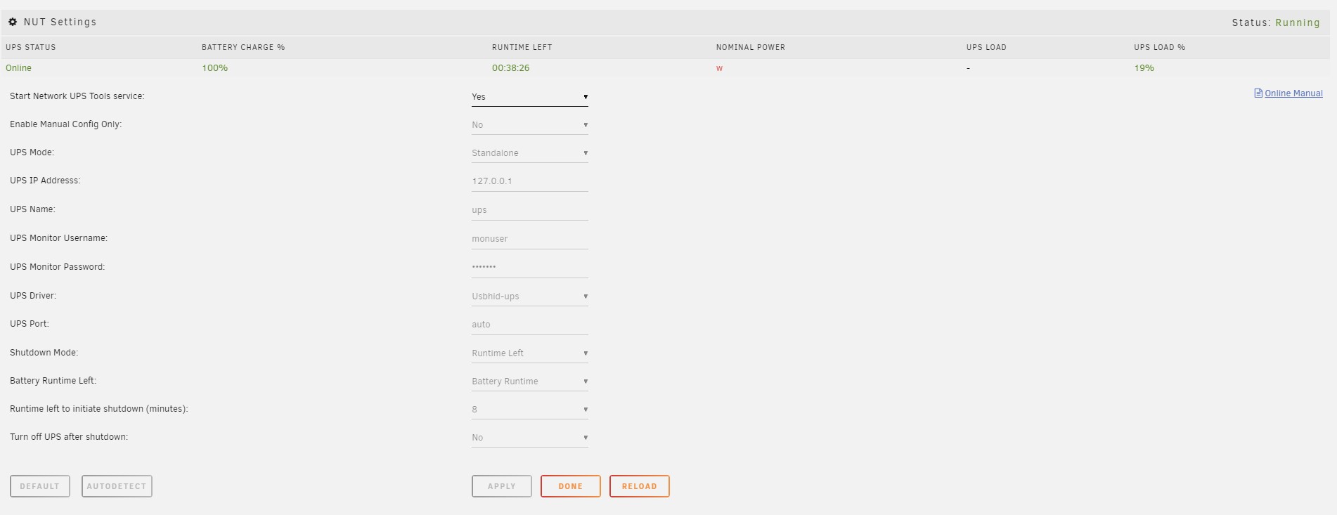

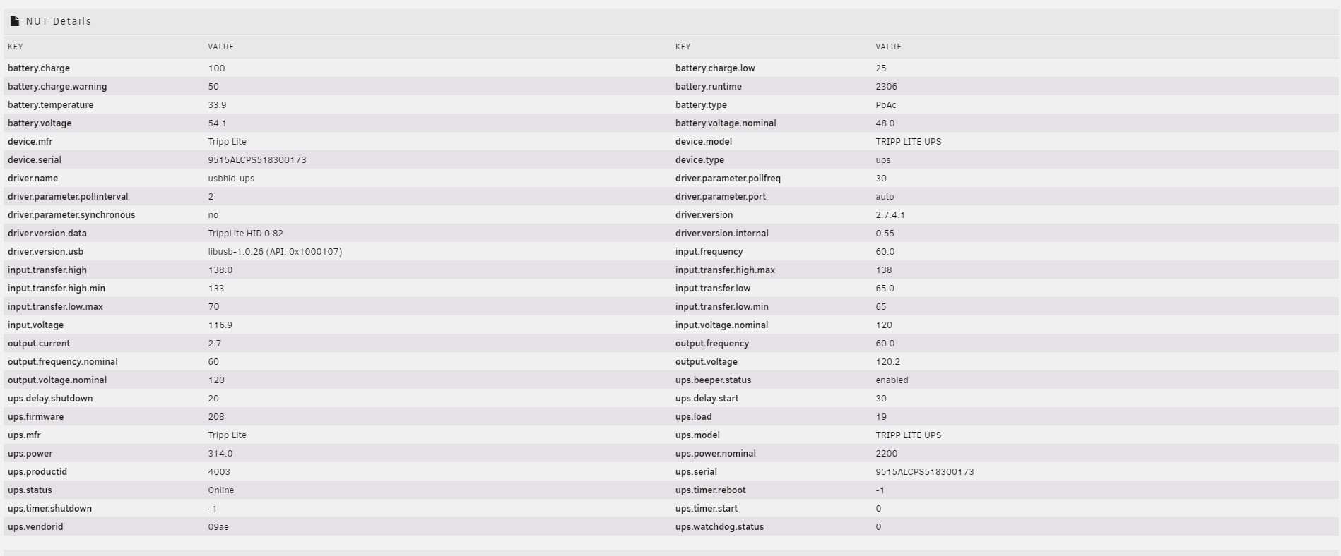

  1. APCUPSD doesn't connect. It stays in a state of "Lost Communication". When I ran into that issue I gave NUT a try and it detected and appeared to work fine with my UPS until I discovered this issue.
  2. I'm having an issue I'm hoping someone can point me in a direction to diagnose. I have a Tripp Lite SU2200RTXL2UA connected via USB to my Unraid server. It recognizes the UPS and appears to be working. The issue is that it is flipping between on battery and on line power frequently. The front panel of the UPS is indicating that its staying on line power even when the plugin is detecting the switch to battery. My log is filling with these messages; May 10 09:44:46 Unraid upsmon[4878]: UPS [email protected] on line power May 10 09:45:11 Unraid upsmon[4878]: UPS [email protected] on battery May 10 09:45:26 Unraid upsmon[4878]: UPS [email protected] on line power May 10 09:45:36 Unraid upsmon[4878]: UPS [email protected] on battery May 10 09:45:46 Unraid upsmon[4878]: UPS [email protected] on line power May 10 09:46:06 Unraid upsmon[4878]: UPS [email protected] on battery May 10 09:46:16 Unraid upsmon[4878]: UPS [email protected] on line power May 10 09:46:36 Unraid upsmon[4878]: UPS [email protected] on battery May 10 09:46:46 Unraid upsmon[4878]: UPS [email protected] on line power May 10 09:47:06 Unraid upsmon[4878]: UPS [email protected] on battery Any help on this is appreciated
