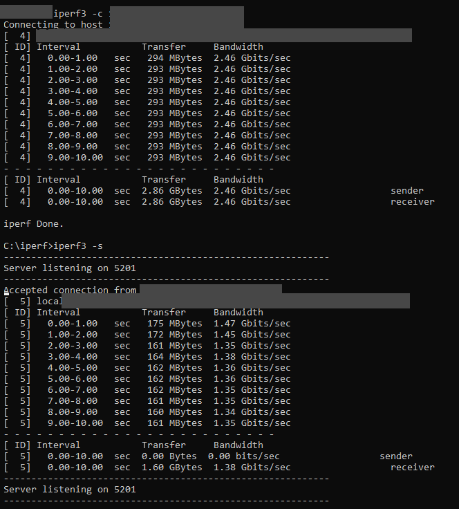

  5. Updated Bios, redid dhcp stuff, turned off bonding and bridging. Something fixed it, network is maxing out on both read and write. Reading/Moving files from Unraid at 190-210mbytes now, acceptable and fast enough for ffmpeg.
  6. First time using Iperf and it definitely seem network related. Iperf speeds match my transfer speeds. What could cause it?
