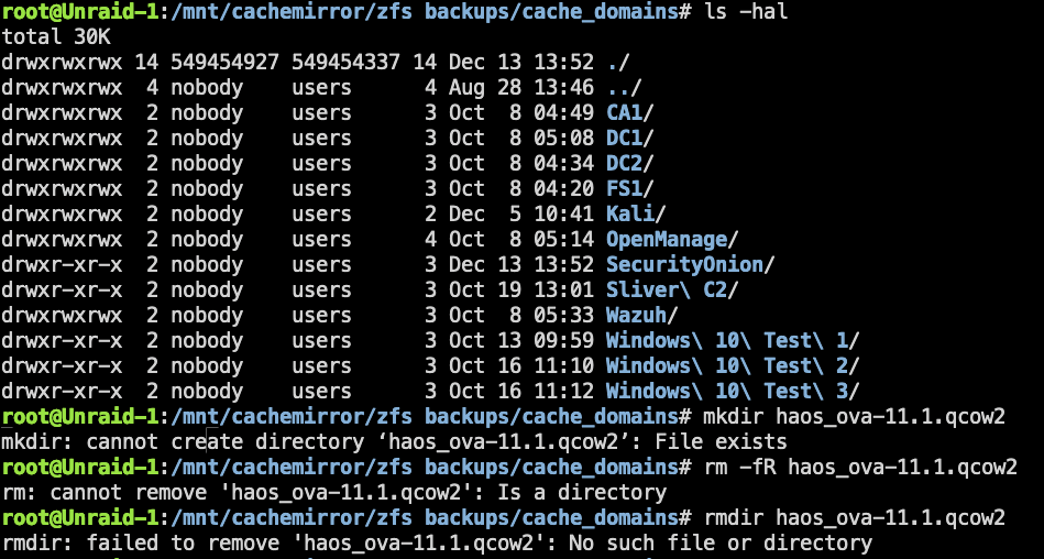

  4. I have 3 ZFS datasets that I can not destroy. ZFS Master shows them as being "greyed-out" and when I try to destroy them, I get this error: "Destroy Result   cachemirror/zfs backups/cache_domains/haos_ova-11.1.qcow2: Operation not permitted". If I go into the cli, this directory no longer is viewable, but if I try to re-create it, I am told that it already exists. But if I try to rmdir it, I am told "No such file or directory". It appears that I am in a catch-22 here. There has to be a way to remove this, but I cannot figure it out. There are no snapshots of these datasets either, so I am not sure what thinks they still exist?
