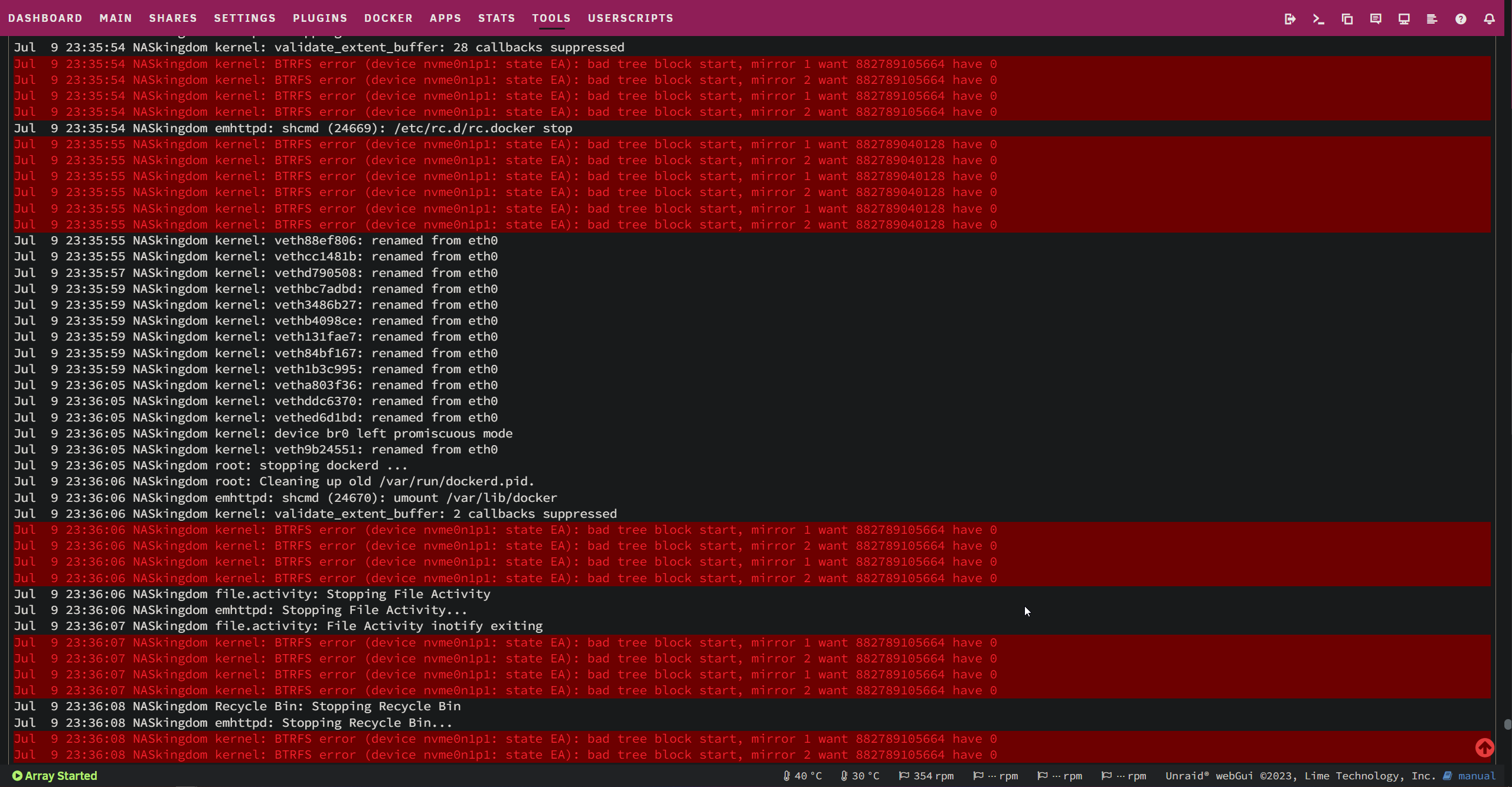

  3. So after changing MACVLAN to IPVLAN all my containers lost connection to the router (ISP provided one) I could access them from my computer but they could not talk to the internet. So I followed This guide by bonienl on how to fix that and added a second NIC (USB one for testing) it seems to have gotten rid of the MACVLAN errors but docker still crashed and the server got unresponsive It didn't crash completely as I could still access the console on the physical machine. Edit: disks aren't mounting anymore even after reboot edit2: It seems to be my SSD's they are formatted with ZFS whole system locks up after trying to mount them syslog1600.txt naskingdom-diagnostics-20230715-1628.zip

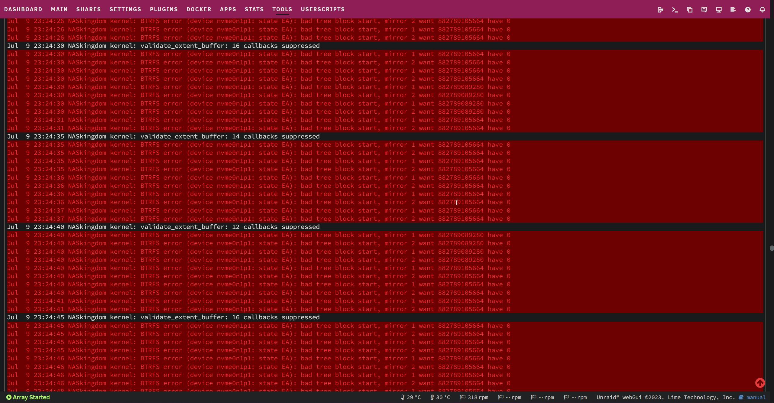

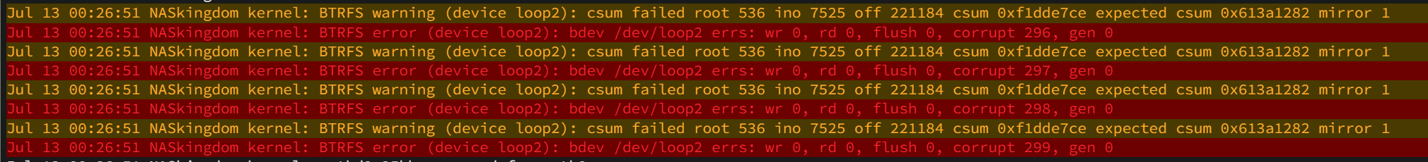

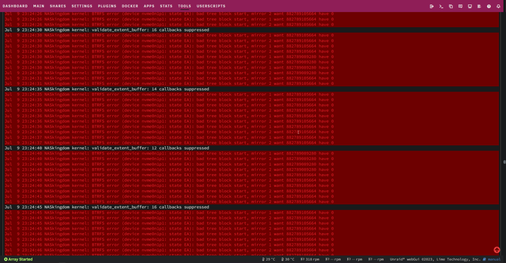

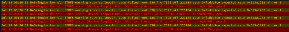

  5. Docker broke again yesterday and the system refused to shutdown. After that I ran MemTest for the longest possible duration and no errors found. Booting up the system first the disks refused to mount. After reboot that works again but my docker image is corrupt and 2 of my cores are also pinned at 100% usage MemTest86-20230714-232052.log syslog.txt
  6. I've tried everything I could think of but I can't figure it out. In random intervals either docker just stops working and containers refuse to launch or the server freezes completely this can happen multiple times a day sometimes its just individual containers but the rest usually follow shortly. These issues started happening after an upgrade Things that changed went from 3 array disks and 2 SSDs to 6 array disks with 2 SSDs added PSU SATA power splitter cables and obviously SATA data for the new drives Changed the case (didn't take off the cooler nor the RAM) installed the appdata backup plugin (particularly after this I started seeing this behavior) before this I also didn't have a parity disk What I tried one of the drives was throwing reading errors so I unplugged it. bad SMART status because its old my NVME SSD (crucial P3) with cache and docker was also throwing read errors and systemlog said something about corrupt data I put docker on a different disk didn't help So I replaced the SSD with 2 new ones in mirror ZFS (970 evo plus 1TB) it seemed to happen less often after this I deleted my docker.img and reinstalled my docker containers multiple times via the "previous apps tab" even tried XFS docker.img once I deleted non essential files for some of my docker appdata folder I turned off XMP ran prime 95 for 30~ min ran a quick memtest 15~ min (I know I should have ran this longer) Reinstalled UNRAID on my USB and moved only the config back Other Info I have multiple days of syslog's and diagnostics in case that's useful I've attached the most recent ones but can upload all of them Server is plugged into a smart power plug for power usage measurements My CPU's box was opened when I received it MOBO: Asrock B660m Legend Steel CPU: i5 13500 RAM: Mixed ram kit 24GB 2x 8GB (from old gaming PC) 2x4GB (from office PC) PSU: Seasonic S12III 500W Case: Antec P101 Silent Hope someone can help me as I don't know what to do anymore naskingdom-diagnostics-20230713-1845.zip naskingdom-syslog-20230713-1645.zip
