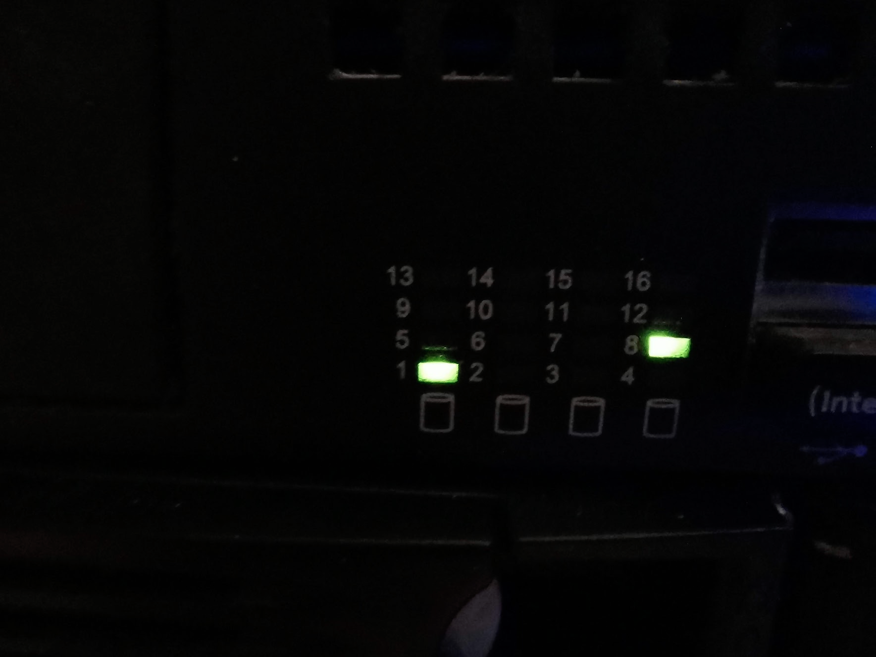

  2. Hi guys, I'd like to ask for your recommendation regarding a PCIe3 HBA. The Hardware I currently have is: Core i3-7100 Supermicro X11SSL-F 32 GB Single-bit ECC Chenbro RM41416 16-bay rackmount case 2 parity disks 11 HDDs, some 3TB but most 4TB 2 Sata SSD as a redundant cache pool and what I am looking to replace: 2 LSI SAS2008 HBAs which connect to the chenbro backplane which has the 11 array HDDs and the 2 parity HDDs. The reason for wanting to replace the two PCIe2 HBAs for one PCIe3 HBA is mainly the attempt to optimize the HDD performance of the arrays. Also, which is a minor thing, is that the Chenbro case's drive LEDs only work for the first 8 HDDs, not the remaining 8. I suspect this is because of the two HBAs. So, I would love to hear your recommendations regarding which HBA to get. Thank you!

  5. Hey guys, maybe my setup is not that uncommon, given how widespread LSI HBAs are while Chenbro enclosures can be picked up cheap. So, I am using two LSI 9220-8i (both in IT mode, of course) in a 16-bay Chenbro RM-41616. It is a minor detail but I am missing the second card's drive activity LEDs on the front (drives 9 to 16). I know that the LEDs do work because prior to the dual 9220, I was using one 9220 in IT mode with a IBM 46M0997 16port SAS Expander. Here, all drive activity LEDs were working. Sadly the SAS expander cause read I/O errors, so I switched it for a second 9220. Does anyone have a similar setup and encountered the same problem and found a solution? Also, sort of off-topic but would a more modern, PCIe 3 16-port HBA give any performance benefits? If so, any recommendations on one? Cheers and thanks, Alex
