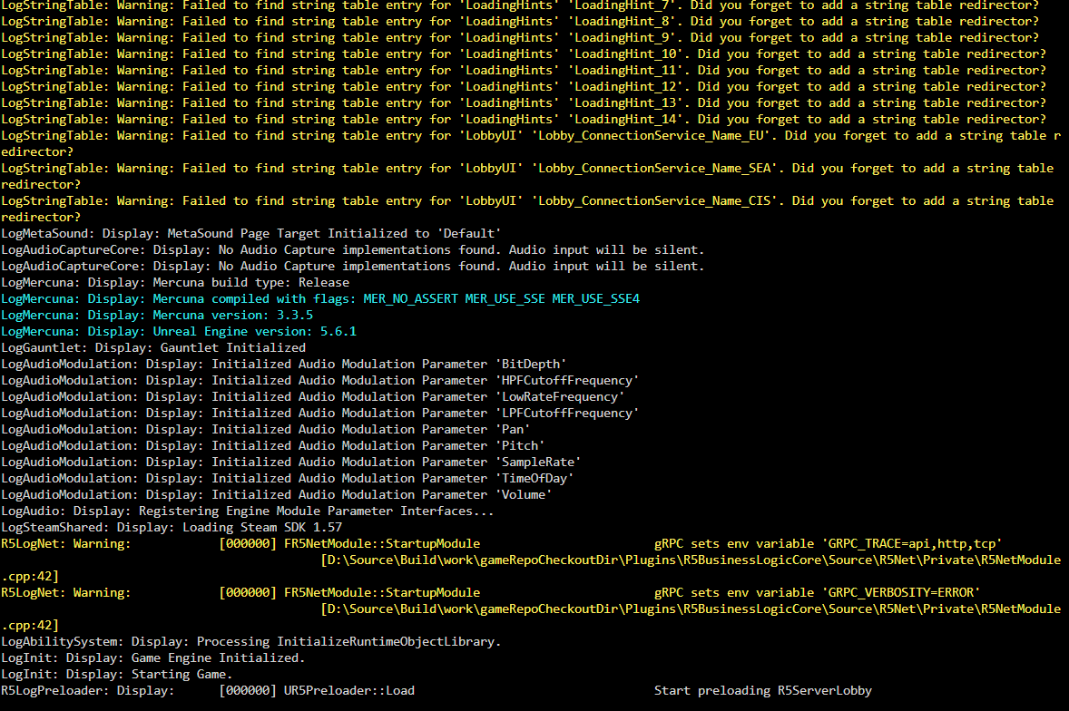

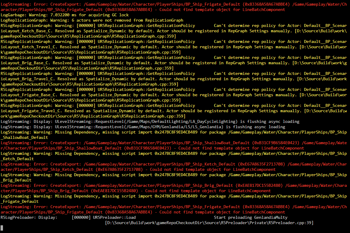

  1. I am struggling to get this working. I followed all of the directions, but when I run it for the second time after copying the files and making the changes I get these errors: When I try to load into the world it loads the character, but the world has a blank map and none of the buildings are built. In the worlds folder it has now created a new world ID and has changed the World ID to that one in the ServerDescription.json Any ideas? Thank you!

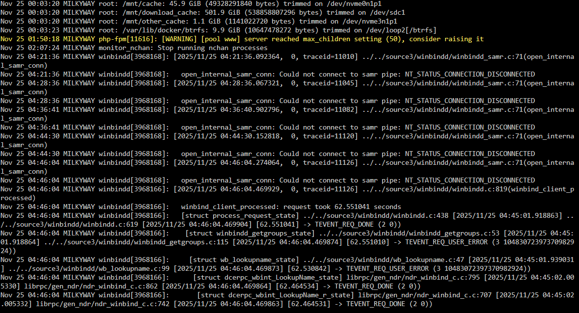

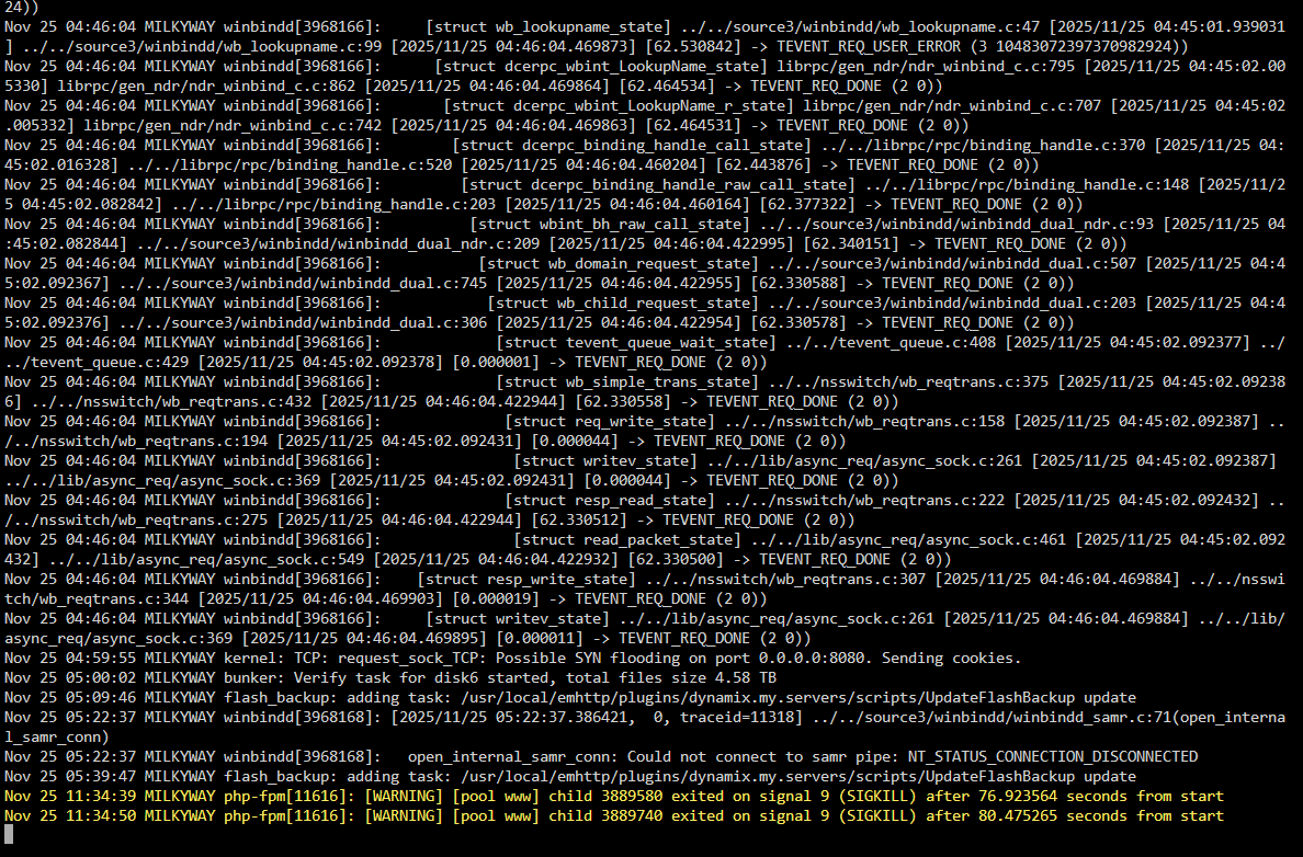

  2. After restarting the server and all my containers I was gone fora couple days. I get up this morning to the GUI being barely responsive, and my container services not being reachable. Using the GUI I was able to confirm that the services are still running and pull a fresh diagnostics. I also included 2 screenshots of the log screen. This was right when I got to the server this morning and what I was seeing. THe CPU on the dashboard also shows as pegged at 100%. I have no idea if any of this is related. Edit: After stopping and restarting docker the CPU usage dropped back to normal and the GUI became responsive again. Unraid seems to have gotten less stable for me and I am at a loss as to why. Thank you again for your help! milkyway-diagnostics-20251125-1146.zip
  3. After I restart everything seems to run fine for some period of time. After 12 hours or more typically the GUI no longer responds and all my docker services drop offline. I was able to pull a diagnostics. Hoping to get some help to see wha tmight be causing the issues. Thank you! milkyway-diagnostics-20251123-1148.zip
