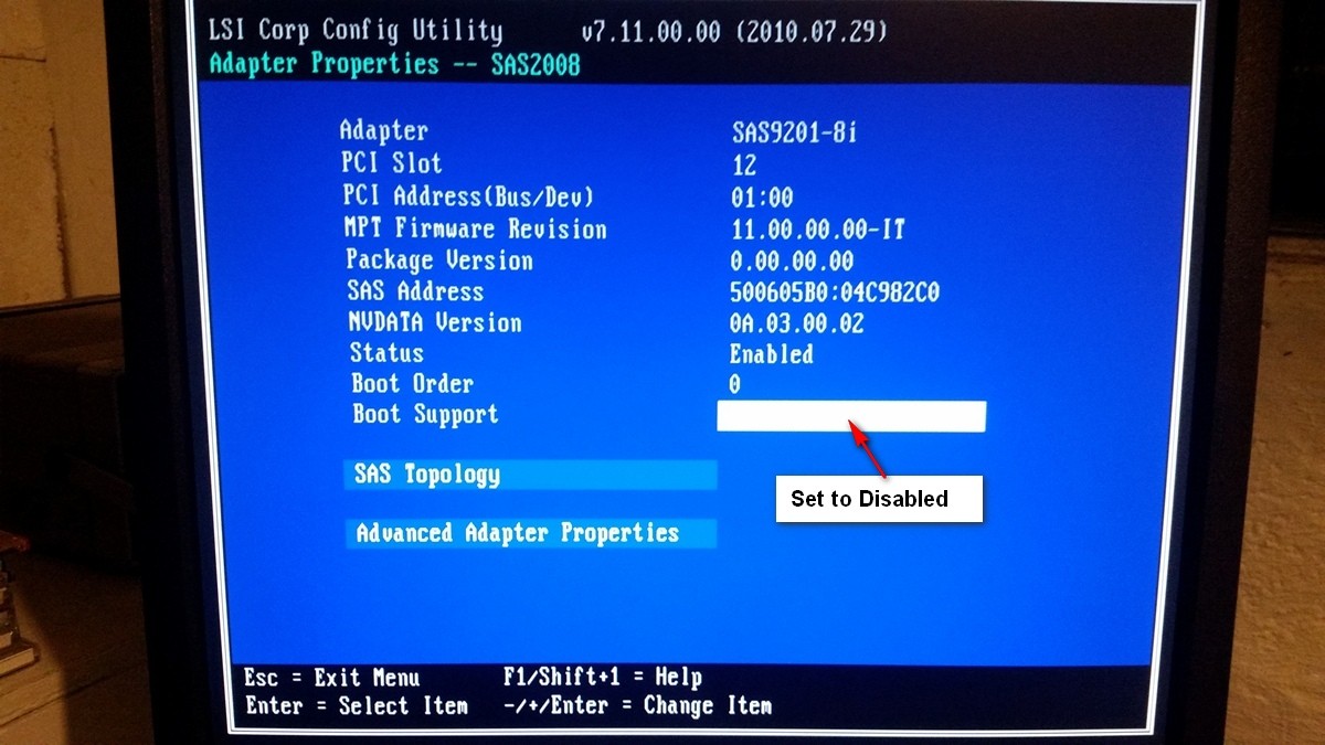

  1. Home Run! After erasing the bios on both cards the system booted without any issues and unRAID immediately recognized all drives. The only thing I needed to do was re-assign my cache drive. This is absolutely perfect and will serve my needs very well. I can't thank you enough johnnie.black for your suggestions and guidance, and SSD for the education on PCIe speeds. It's members like you both that help make unRAID a wonderful operating system! Thanks again - I hope I can return the favor!
  2. I've made some progress - both LSI cards have been flashed to firmware version 20.00.07 (and bios 7.39.2 which I disabled). I'm getting a similar bios error so I will go ahead and erase the bios to see if this fixes the issue (thanks for the reference to your post johnnie.black). When I erase the bios - Is it possible to re-flash the card at a later date to utilize the bios again? (e.g. if I ever decide to sell the cards due to an upgrade). Or is this a "one-time" shot? Thanks again!
  3. Thank you johnnie.black - I greatly appreciate the information. I've seen numerous comments about bios version 20 - but thought that they only pertained to cards that were not natively in IT mode. This is great to know - my knowledge is growing in baby-steps I will definitely try this over the weekend - thank you again!
  4. Well...the plot thickens I tried installing the second LSI card in the x4 PCI slot only to receive the following error message: MPT BIOS Fault 10h encountered at adapter PCI (07h,00h,00h) Press any key to continue... What is strange, however, is that both cards work fine in the main x8 slot - no issues at all. It is only when I add both cards to my system (regardless of the order) that I receive the same error message. I have a feeling my motherboard will not accept two cards. During the process of troubleshooting I did disable the Boot Support for both cards. I did some further research and found many references to resolving the matter by flashing the bios/rom for these cards (for the non-IT versions). However, since they are both SAS9201-8i cards they are already in IT mode. I reviewed the unRAID support page for Crossflashing Controllers but none of this appeared to be relevant in my case. I was also not able to find bios information specific to the 9201-8i (only the 9201-16i). Would anyone mind looking at my attached LSI Card Screenshot and let me know if this bios is considered outdated? I don't want to risk damaging the card if the bios is fine and my motherboard is the culprit. If this is an old bios that should be updated - can someone recommend the bios version that I should be using? I greatly appreciate any suggestions! As an aside, I have found a few used/refurbished AMD 990fx motherboards that presumably have dual x16 and/or x8 support. If it does turn out that my motherboard does not like having cards installed - I may be better served going this route. Thank you again for any suggestions!
