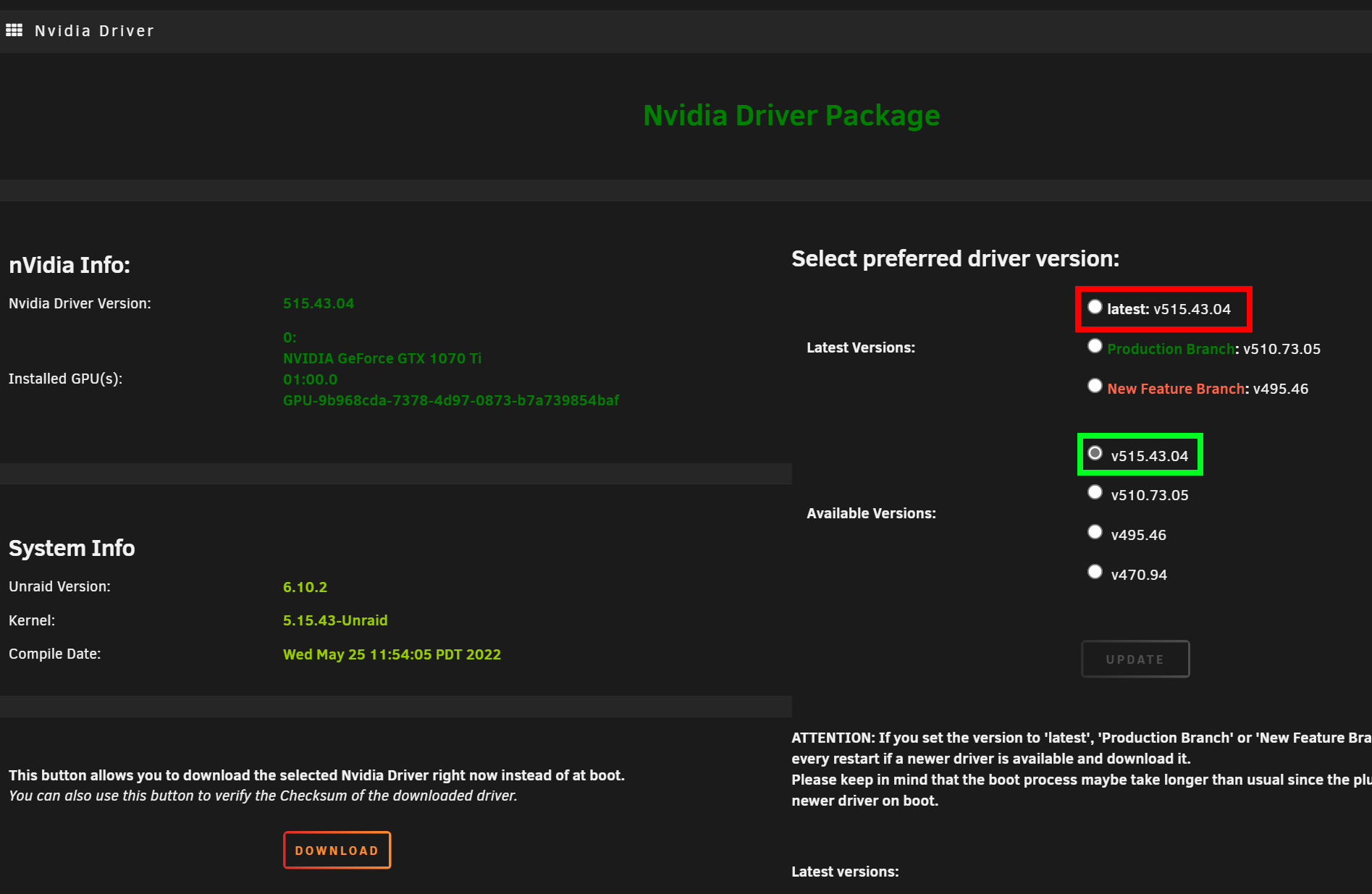

  2. Further to the previous comments, once the plugin is installed successfully, leaving it on Latest causes failures with server reboot, however if you set it to the version then it works without issue after reboot:

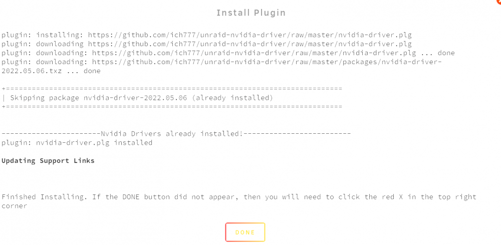

  9. Hi, I believe I have figured out my issue, after 3 attempts (6 reboots) at following the below steps: Remove the plugin from failed installations plugins tab Execute command "rm -rf /boot/config/plugins/nvidia*" (without double quotes) Reboot Pull a fresh copy from the CA App I was consistently met with the screen shot below and never moving beyond this point when installing the plugin. What I then tried was the following: In my server I have multiple Nvidia GPU's one of which was bound (vfio) for passthrough, I unbound this card, and then followed the steps above and the plugin and driver installed without any issue, dockers using acceleration immediately started working however VM did not. I then rebound the GPU (vfio) and rebooted and all dockers and VM's returned to the working state that had existed in 6.9.2. I hope this is helpful, but definitely solved the issue for me on 6.10.0.
