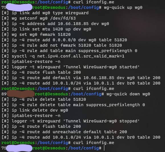

  2. Yeah I have the VPN setup and I can turn it on... BUT... there is no wg0 interface?? i.e. new containers cannot bind to network type wg0
  3. Also is wg show all supposed to return anything? The output is nothing for me

  7. Just the default config from my provider, nothing that stands out to me as troublesome: [Interface] PrivateKey = XXXXXXXXXXXXXXXXXXXXXX Address = 10.67.169.119/32,fc00:bbbb:bbbb:bb01::4:a976/128 DNS = 10.64.0.1 [Peer] PublicKey = XXXXXXXXXXXXXXX AllowedIPs = 0.0.0.0/0,::0/0 Endpoint = 89.45.224.145:51820

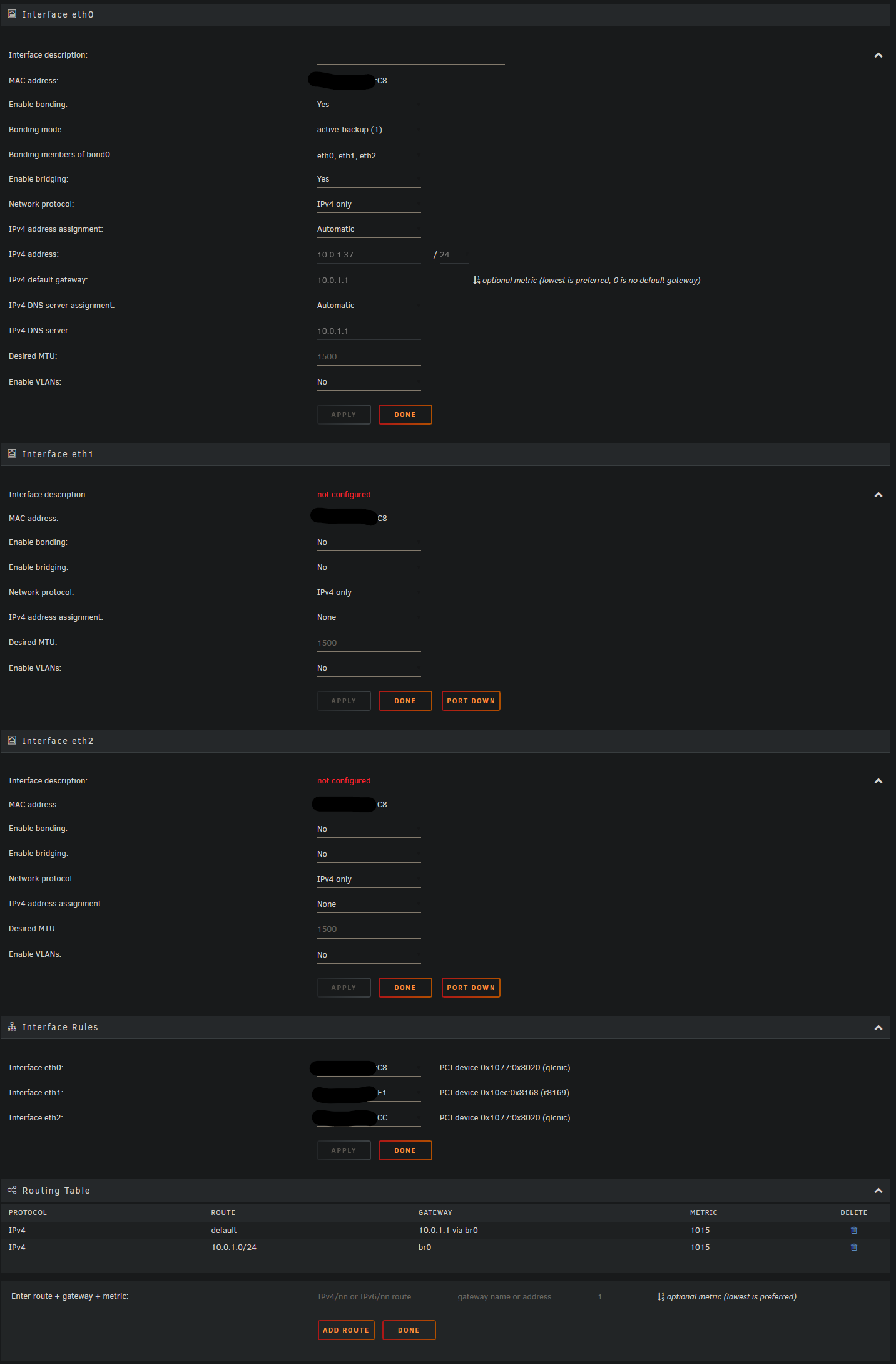

  8. Unraid is using any VPN marked as "for Docker" for all network traffic. This issue popped up randomly a few weeks ago. Short video demonstrating me adding the VPN, turning it on, and seeing the IP the OS uses change: Screenshot of my network settings: Any Advice? At this point I'd settle for just reinstalling Unraid if there is an easy way to do that?
  9. My network config: Video of me setting up VPN from scratch:
  10. I have a Wireguard tunnel configured as "VPN Tunneled Access for Docker", and randomly within the last 24hrs my server decided to use it for all connections. I noticed this when I couldn't connect to my VPN which uses a DDNS pointing to my LAN, and I noticed it was resolved to my VPN's IP. Confirmed with `curl ifconfig.me` returning the VPN IP as well. `wg0` isn't mentioned in the Networks Settings page at all, so I'm unsure how to debug this. LMK what screenshots and printouts might be helpful. ifconfig.txt
