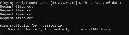

  8. Hi, as of this morning i been having issues with the unraid-api giving me errors and half the UI is pretty much just blank for 10minutes if im doing anything to it, the dockers and everything else seems to work fine but it points it to DNS error to wanip4.unraid.net is not reachable, when i try to ping it from my main mahcine its also not reachable but using "is it down home page" it seem to be able to connect to it somehow, i run adguard home on my pi and checked the logs there and its not blocking it even tryed to turn of the protection to check and no change, this is how my main array page looks like for about 10 minutes just as i try to scroll around the ui and then all the drives pops back again but still with unraid-api down, doesnt work to enter the terminal to do unraid-api restart doesnt do anything and only a restart seems to fix it for a while then it just back into this state again just to add, this issue came somehere in the night as it was working fine w/o any issue when i went to bed so somehere under the night the api went awol and its not the first time this seems to be happening where i can have it running fine for months on the end and then out of the blue i have api errors for some hours to a week even and then it just fine w/o me touching anything
  9. seems everything is fixed now after swapping to the Basler AG NIC and setting up 2 cables for unraid for the 802.1ad link aggreation instead of the active backup mode
