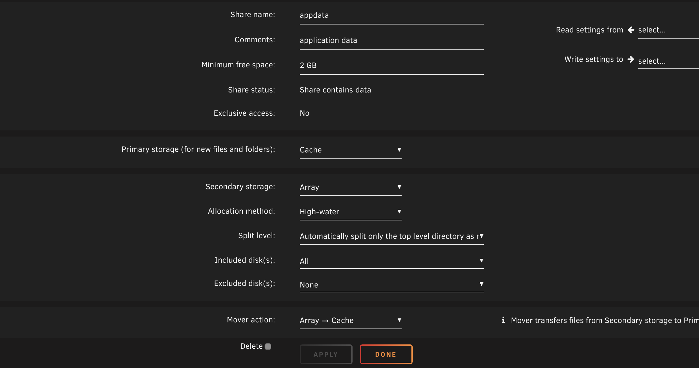

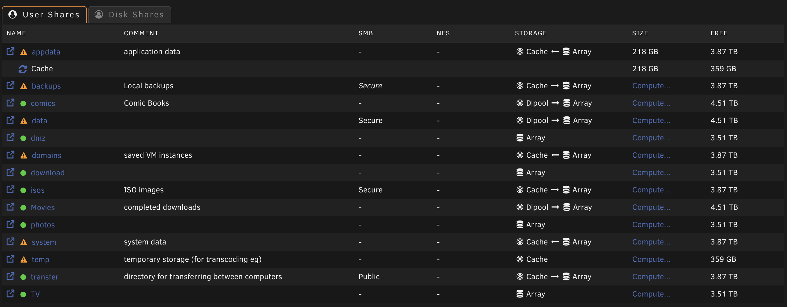

  10. A few of my Docker containers recently stopped working and when i check their logs, i see that i am getting errors due to no space left on device. Here is the log from Postgres 12.5: 2025-12-22 22:46:38.262 EST [1] LOG: listening on IPv4 address "0.0.0.0", port 5432 2025-12-22 22:46:38.262 EST [1] LOG: listening on IPv6 address "::", port 5432 2025-12-22 22:46:38.481 EST [1] LOG: listening on Unix socket "/var/run/postgresql/.s.PGSQL.5432" 2025-12-22 22:46:38.535 EST [1] FATAL: could not access status of transaction 0 2025-12-22 22:46:38.535 EST [1] DETAIL: Could not open file "pg_notify/0000": No space left on device. 2025-12-22 22:46:38.544 EST [1] LOG: database system is shut down 2025-12-23 11:04:19.285 EST [1] FATAL: could not create lock file "postmaster.pid": No space left on device All of my shares, including appdata have free space in them, including free space on the cache drive. If i try to create the postmaster.pid file manually, i get the same error message: root@dachora ~ # touch /mnt/cache/appdata/postgres/data/postmaster.pid touch: cannot touch '/mnt/cache/appdata/postgres/data/postmaster.pid': No space left on device root@dachora ~ # df -h /mnt/cache/appdata/* Filesystem Size Used Avail Use% Mounted on /dev/nvme0n1p1 932G 597G 335G 65% /mnt/cache df reports the correct free space Here are the settings for my appdata share Any ideas what else i can try to troubleshoot this issue?

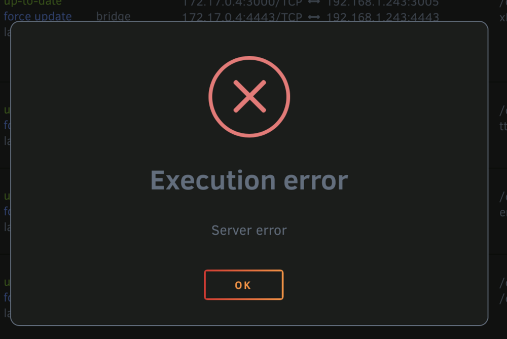

  13. I didn't mean zombie process in the traditional sense, I just couldn't think of a better way to describe docker-proxy reserving the port for a container/process that isn't running. I'm running cloudflared-tunnel and Plex-Media-Server in host mode. Is there something wrong with having these configured this way? I made a little bit of progress on my own. Before, I'd mentioned other users on different operating systems reporting success by stoping docker, deleting /var/lib/docker/network/files/local-kv.db, and starting docker. A few weeks ago, I tried this and noticed the entire /var/lib/docker directory is empty when Docker isn't running. I decided to pursue this a little further today and tried deleting local-kv.db *before* stopping Docker, and when I restarted it, it was no longer reserving port 9117 when starting up and I was able to start Jackett on that port! I'm guessing Unraid manages /var/lib/docker differently than other systems and its directory is unmounted when not running. However, I have one issue that came up after doing this. My wireguard vpn network isn't an option in Docker anymore, I onlly have the options Bridge, Host, None, and br0. I wasn't sure how to add it back, but I went into Unraid's VPN settings and just re-applied the settings and it appeared. However, while the containers using the wiregurd network are able to obtain IP addresses. I'm unable to connect to their web addresses and from one of the container's shell, i'm not able to ping any Internet or local IP addresses. I ended up deleting and recreating the tunnel and now everything is working, phew.
  14. Thanks for the suggestions! I updated to 6.12.13 and am still experiencing the issue. I'd like to avoid changing the port because I use the URL of the Jackett container in the configuration of all my other containers and would need to update all of those. Maybe this should be my impetus to set up an internal reverse proxy, but that's another story. I tried changing Jackett to another port to see if that would somehow free up the original port. Jackett started fine of course but the old port remained in use. Switching back to the original port and it wouldn't start as expected. I tried running nmap to see if I could get any more information and it reported that the port was closed. I'm kind of resigned to changing the port and reconfiguring, but having a port permanently occupied by some sort of zombie process doesn't sit right with me.
  15. Hello, I'm currently using UNRAID 6.12.10. Recently I started getting an Execution error whenever I try to start a particular container (Jackett). If I start it from the command line, I get a little more details: # docker start jackett Error response from daemon: driver failed programming external connectivity on endpoint jackett (c416528d960abb5b43aeba21188ba5e9a1ed0f6bbd47bb78569cfe80b29a71e2): Bind for 0.0.0.0:9117 failed: port is already allocated Error: failed to start containers: jackett So I check to see what is using the port, and it's docker-proxy: # sudo ss -tunlp | grep 9117 tcp LISTEN 0 4096 0.0.0.0:9117 0.0.0.0:* users:(("docker-proxy",pid=9917,fd=4)) tcp LISTEN 0 4096 [::]:9117 [::]:* users:(("docker-proxy",pid=9924,fd=4)) I don't see these ports in use when I do docker ps. If I kill these processes, it doesn't seem to actually free the ports, as the Jackett container still can't start. I searched online for similar issues and saw people having trouble with docker-proxy occupying a port and preventing a container from starting, and the resolution was to stop the docker service and delete the file /var/lib/docker/network/files/local-kv.db and restart docker, but this didn't help in my case. Does anyone have any suggestions on something I can do to find out why docker-proxy is hanging onto that port and how to stop it?
