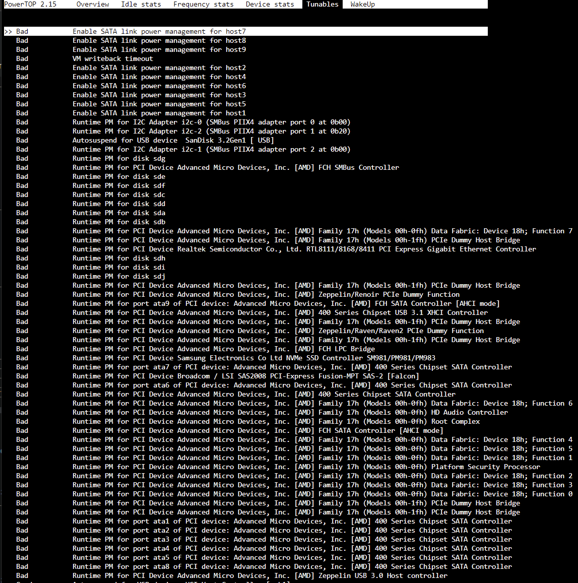

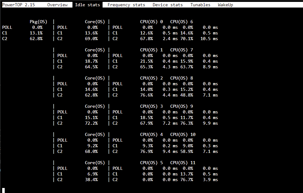

  1. Hey, I am not sure if it is safe to use for me to use powertop --quiet --auto-tune because I have a SAS controller? This is my current setup: ASRock B450M Pro4 AMD Ryzen 5 2600 Corsair RM White Series™ RM850 (2021) LSI® SAS 9211-8i (Chipset LSI SAS2008 PCI-Express Fusion-MPT SAS-2 [Falcon] (rev 03)) This is my powertop output, it looks diffrent than the one in the example, only 2 C states and Pkg(OS) instead of (HW):
