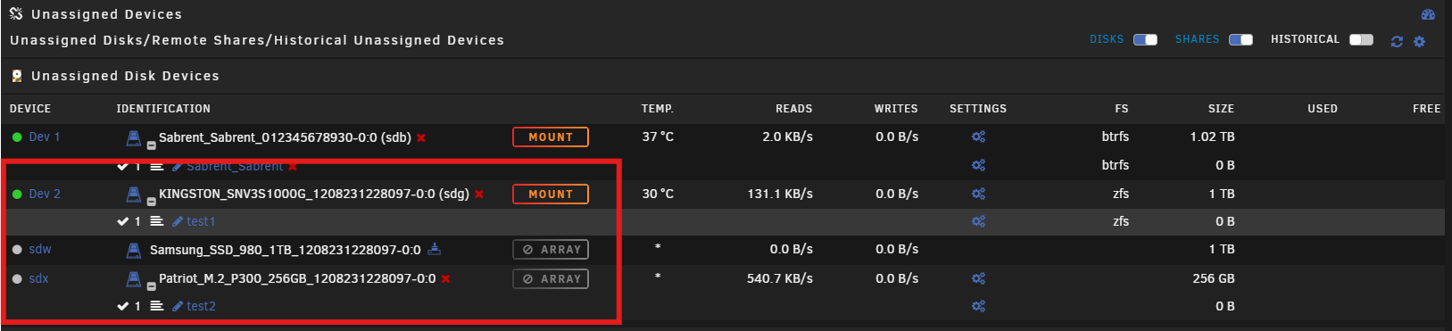

  1. For anyone stumbling on this in the future, there is a firmware fix for my specific device (Terramaster D8): https://forum.terra-master.com/en/viewtopic.php?t=6748 This fixed the problem and I can now use each m.2 drive.
  2. Hello folks, I have a Terramaster D8 USB 3 enclosure that can house 4 3.5" drives (via SATA) and 4 m.2 nvme drives. When full of drives and connected to Unraid, all 4 3.5" disks show up as individual disks and work fine (can be added as pool devices, etc). However, when there are 3 m.2 drives (and I assume 4, I just don't have 1 more to test) hooked up, only one seems to work at a time. I can only mount 1 at a time or use 1 at a time as a pool device. The others show up in Unassigned Devices but I can't do anything with them: Is this an issue with the device I'm using, or an Unraid limitation, or something incorrect with my configuration? Thanks for the thoughts! orthanc-diagnostics-20250121-1719.zip
