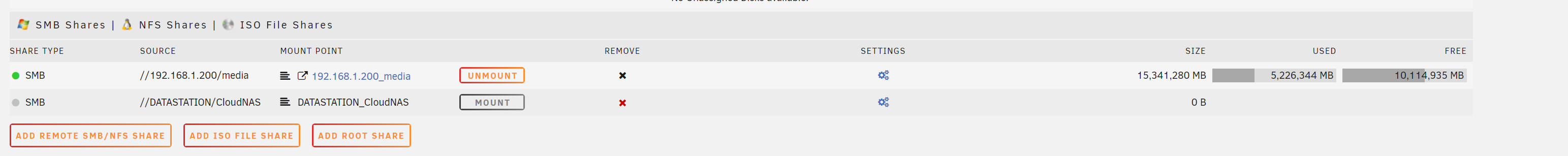

  15. Sorry, I found that the remote share I mounted wasn't working, so I deleted it. This might be the reason why you didn't see it in the logs. Following your advice, I used the IP address instead of the name found by the 'SEARCH FOR SERVERS' button to define the Synology server, and surprisingly, it worked. Below is a screenshot. Could you please tell me the reason? Is there a bug in the UD plugin when using names? The corresponding screenshot and log are attached. ud_diagnostics-20240511-173517.zip

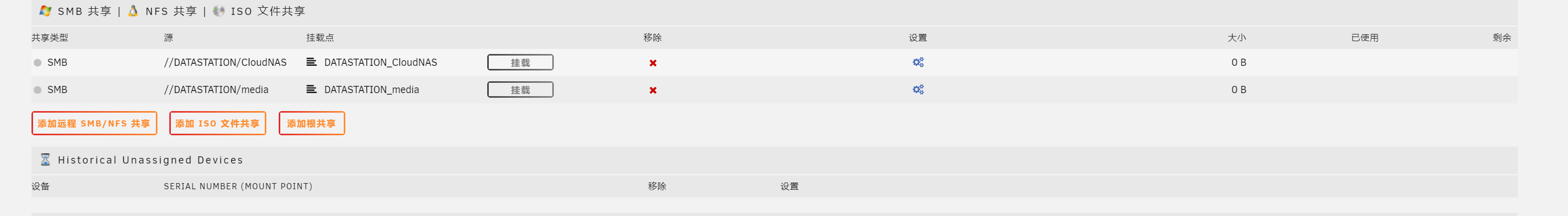

  17. I upgraded to version 6.12.10 as per your suggestion. After the upgrade, I encountered an issue where I couldn't mount two shared folders via SMB. The 'Mount' button is grayed out, indicating that the remote server is offline (as shown in the screenshot). However, I'm certain that my Synology NAS shared folders are online. I've tried restarting Unraid, uninstalling and reinstalling Unassigned Disks, deleting the mounts and setting them up again, but nothing worked. I still can't mount the Synology folders via SMB. Is there something wrong with my settings?
