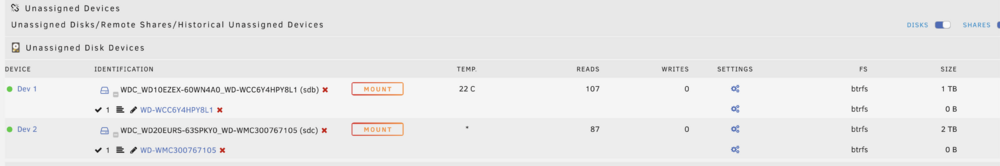

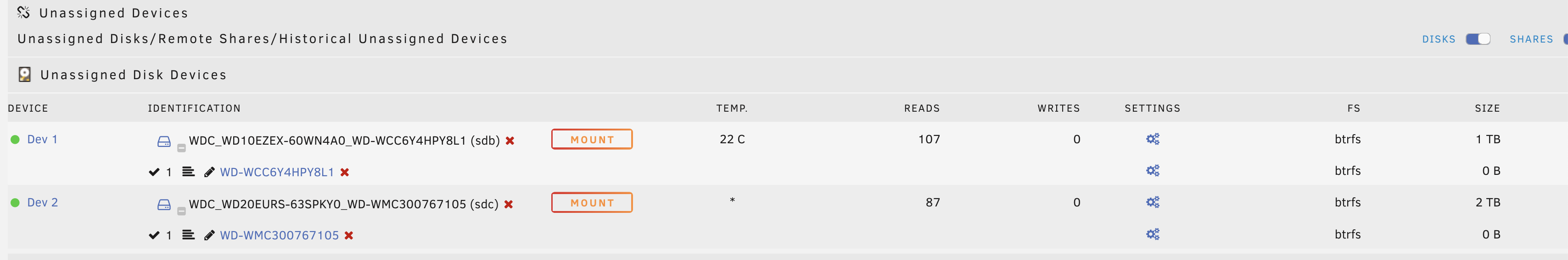

  2. Sorry, I'm little bit too nervous root@EryingAIO-NAS:~# btrfs fi show Label: none uuid: 3a54dcd8-7ff4-4ca7-a67f-fbcda98cc6b1 Total devices 1 FS bytes used 267.16GiB devid 1 size 931.51GiB used 276.02GiB path /dev/nvme0n1p1 Label: none uuid: a5964ab5-1bd5-48fa-a993-e3523cb675ea Total devices 1 FS bytes used 18.87GiB devid 1 size 40.00GiB used 27.52GiB path /dev/loop2 Label: none uuid: 3033ad3f-2386-493d-a0f7-e184d47bb3cd Total devices 1 FS bytes used 2.05MiB devid 1 size 1.00GiB used 126.38MiB path /dev/loop3 Label: none uuid: 5299a408-bd1a-4fae-b0fa-6a44f0cd39f0 Total devices 2 FS bytes used 464.65GiB devid 1 size 1.82TiB used 509.05GiB path /dev/sdc1 devid 2 size 931.51GiB used 123.03GiB path /dev/sdb1 I also noticed these drives appeared to be mountable in the unassigned devices.

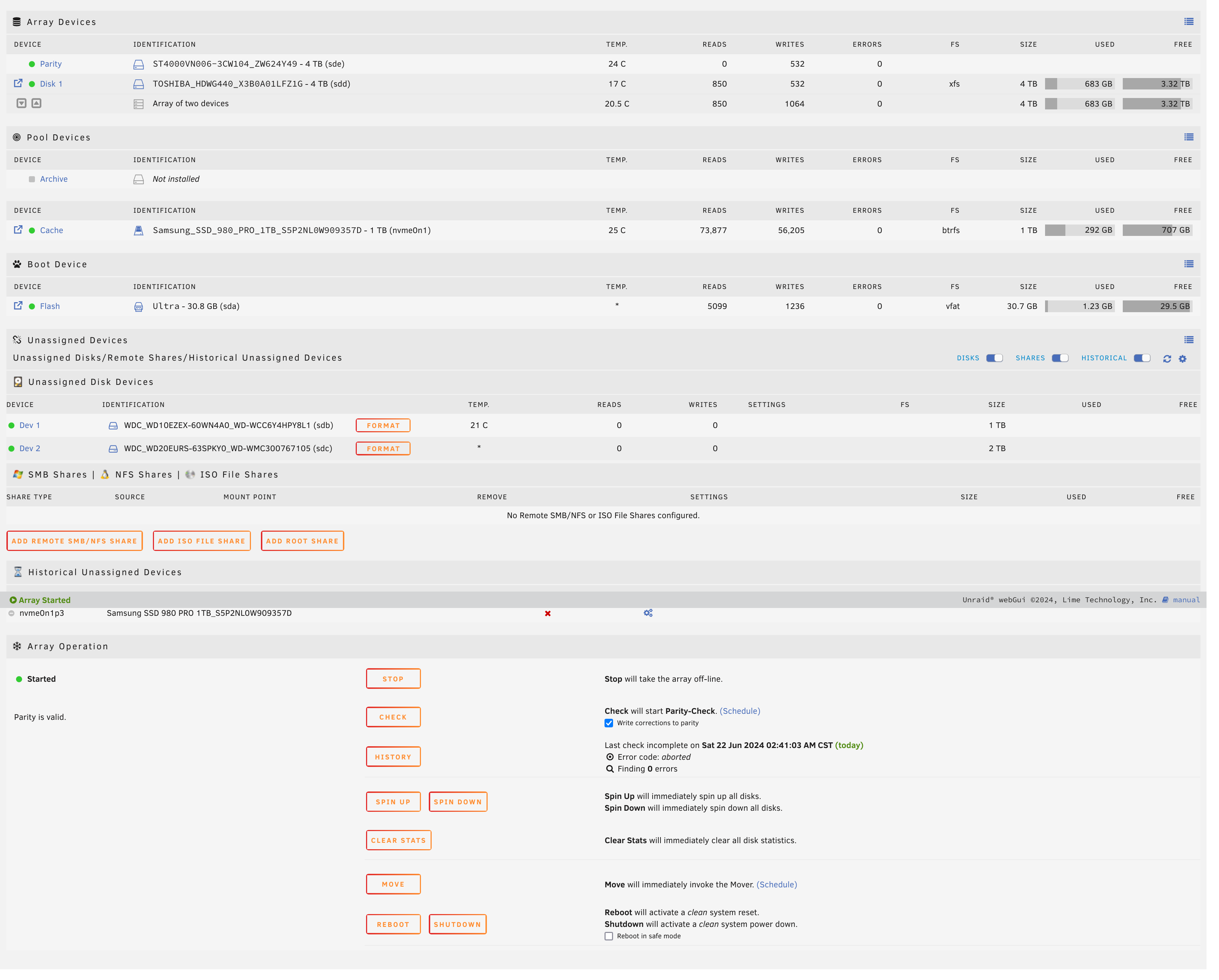

  6. Probably not. I added the second disk not long ago and it should follow default settings.
