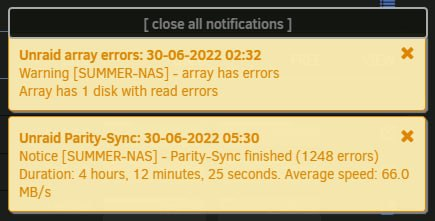

  10. So I'm trying out unraid and one of the random hard drives I had chosen to use failed on me. I grabbed another random drive, checked out SMART (healthy no errors or warnings) in a windows computer and I did a hdtune surface scan in a windows machine, drive seemed to pass but apparently not. I put it in my unraid box to try and rebuild and the drive I chose to rebuild to failed about 30% into the rebuild and died (I'm having terrible luck here) So I bought a brand new drive to replace it and put that in then completed the rebuild fine. But now that the rebuild actually completed I see this message that the array has errors. And indeed several of the files I expected to be there just actually aren't there at all / Deleted / Poof missing. So how do I recover from this? How do I repair these errors and restore the files? Does unraid have any way to do this? To be clear: I had 4 drives in the array. The other 3 drives never failed. The only thing that failed during the rebuild was the replacement drive I was trying to rebuild to. The other 3 drives were still there before, during, and after the rebuild process. I did not lose an additional drive out of the array during the rebuild. Which I could understand would lead to total data loss but that's not what happened. I'm really sad and at a loss now. I was excited to use unraid but if there's no way out of this situation to get my files back then I don't think I'll be able to rely on it if unraid is going to randomly delete files from the array just because the replacement drive we installed dies during the rebuild process. That's a common thing that can happen. EDIT: I do have all of the data stored in this unraid system backed up on a second machine, which most of it was just copied into unraid while I explore, test, and learn about unraid. So I haven't actually lost anything. But at the same time.... this sucks and means unraid is unreliable for real usage as a file server I think? Unless someone can enlighten me to something I'm missing.
