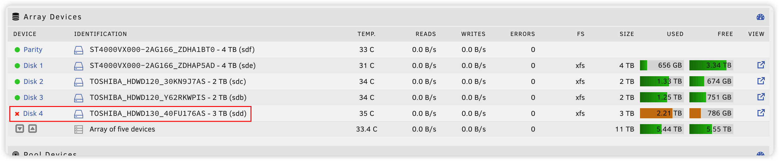

  4. I also suspected the problem of the power supply, but the theoretical power of my power supply is 400w, which should be enough for six hard drives. This problem caused me to lose dozens of G of important data lenas-diagnostics-20230605-0316.zip
  5. As a non-native English speaker, looking at SMART reports makes me dizzy, and I would really appreciate any help in analyzing the cause of the problem. One extra problem, when my hard drive is doing parity check, the speed of one of the hard drives suddenly decreases with a 'dada' sound. After a period of time, this hard disk will be disabled. Even if this hard drive is a new hard drive just bought
  6. Disk 4 is suddenly disabled, I'm not sure why, the following text files are SMART reports, in two hours. TOSHIBA_HDWD120_Y62RKWPIS-20230605-0128 disk3 (sdb).txtTOSHIBA_HDWD130_40FU176AS-20230605-0236.txt
