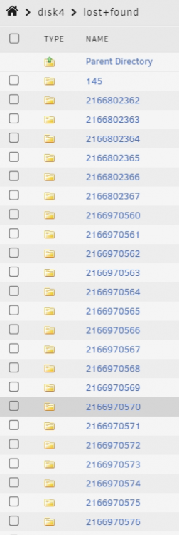

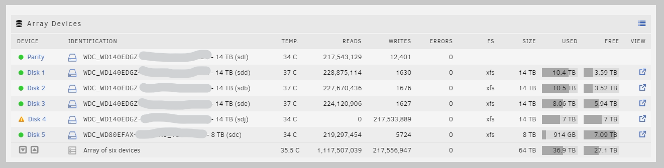

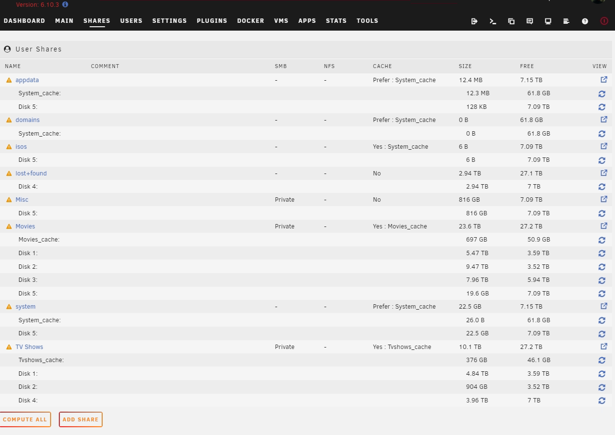

Okay, I'll allow it to rebuild to the spare new drive, that makes a lot of sense. I do have the original Disk 4. I plugged it into my Linux Mint box and it has all the files. I can see now all the files that should be in the lost+found folder. I found an old ext HDD and I'm making a backup of about 8TB of data onto another drive. After the rebuild is completed, can I? Delete everything in the lost+found folder? Mount spare HDD Copy the bad data to Disk 4 from my spare HDD?

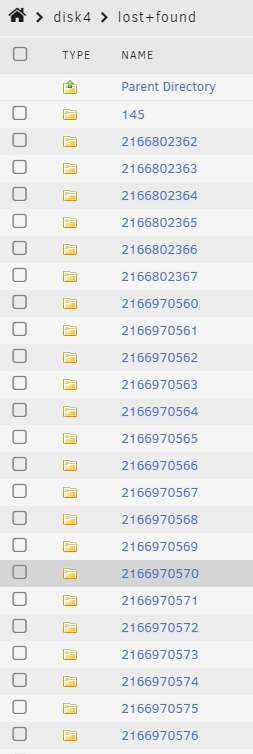

That lost+found folder looks like this, ton of folders with numbers but no files? 1092 objects: 1092 directories, 0 files (0 B total) Yes I do.
[6.10.3] UNRAID reported read errors on existing Drive 4 - Replaced it and now I have read errors on many more drives?

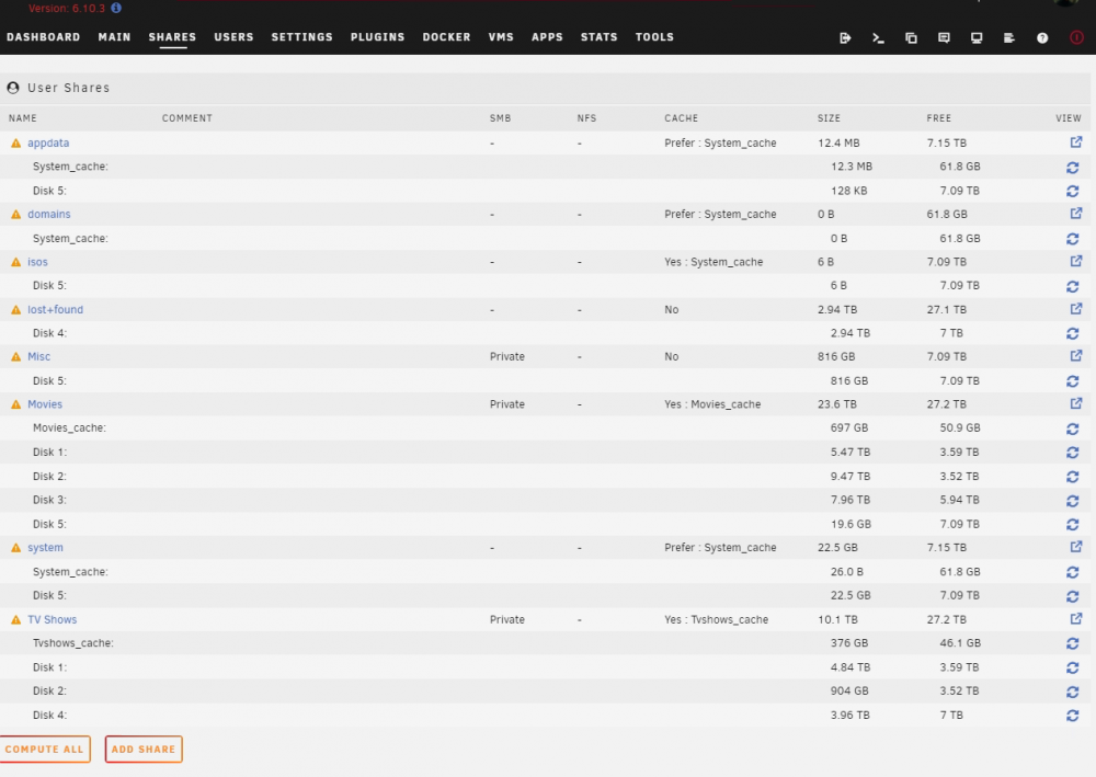

Yes, well not the original Disk 4 but a brand new replacement - that was having the mounting issue. Compute screenshot

After starting the array, it looks like it is rebuilding now, Disk 4 is mounted and no errors so far Should I still do the Compute thing?

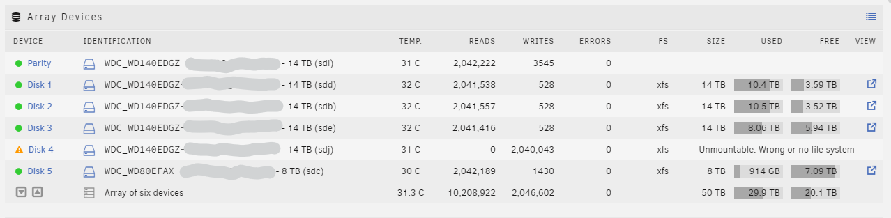

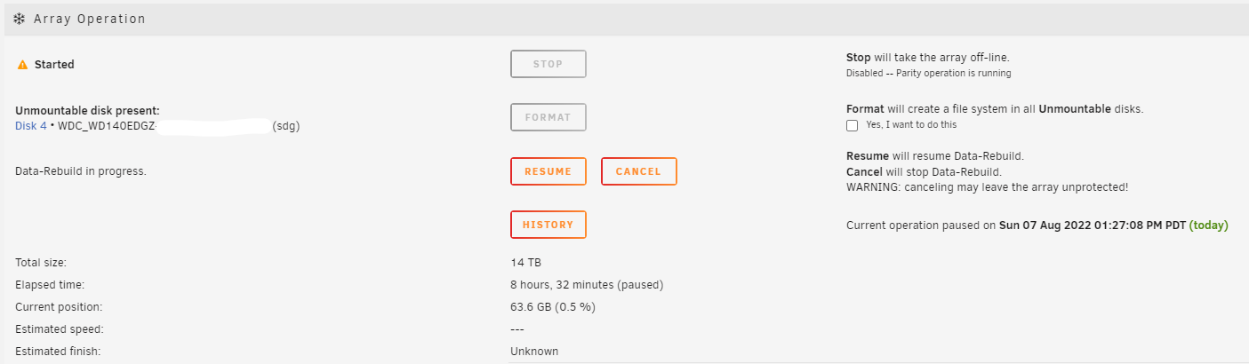

Disk 4 is a new disk. Does it have to be precleared before adding to the array? Does it have to be formatted? I'm getting this message while Disk 4 is being rebuilt? "Unmountable: Wrong or no file system" fresh daigs attached taflix-unraid-diagnostics-20220807-1424.zip I unplugged and reseated all data and power cables. Looked like it was running well for about 30 seconds but Disk 2 is still getting errors? Should I allow the rebuild process to continue or stop? I'll pause it for now.

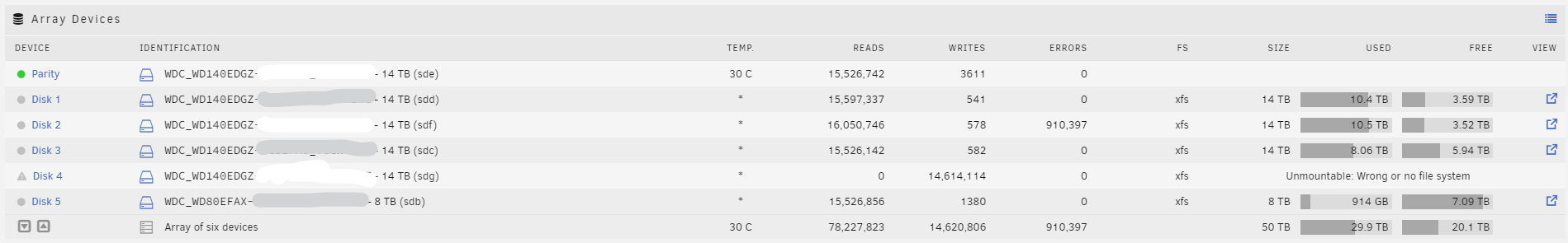

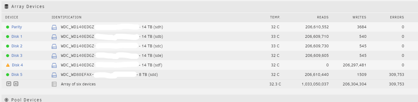

I sort of just started doing everything all at once. I've since turned off the machine. Reseated the cables. That fixed the issue with Disk 2. However Disk 5 is still showing tons of errors: What should I do? It's currently rebuilding.

Disk 4 started rebuilding after I assigned it to the array. However, UNRAID reported read errors from 2 additional drives, please help! Diagnostics attached. taflix-unraid-diagnostics-20220803-1841.zip Short self tests on drives 2 and 5 show:
