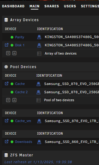

Hi, I just notice that after I upgraded to version 7. And removed my Array disk(SSD) and moved them to Pool Device, I still have the "Spin down" mark. The "Spin down" functions should only be available on normal spin disks?

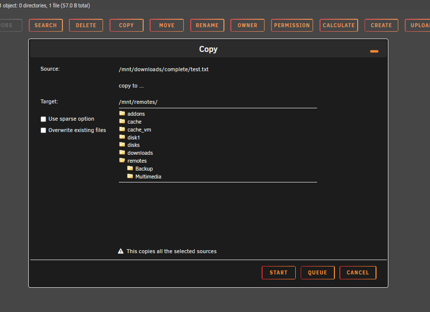

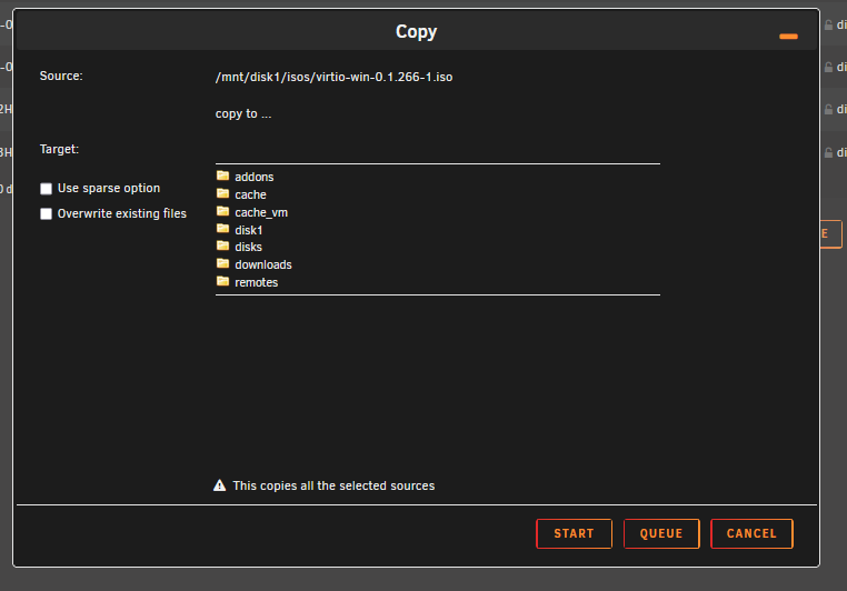

Yes that was from my download pool SSD disk... I can try from Array this is from Array disk: Copy iso file to ... And you can still see remotes

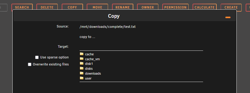

Yeah, It may be confusing, but I'm telling you that I could copy/move files from the File Manager before. And like you say, now I need to type the /mnt/remotes/ manually since I can't pick that anymore for my containers. Is this a bug or it going to be like this now?
total 0 drwxrwxrwt 4 nobody users 80 Jan 13 09:27 ./ drwxr-xr-x 12 root root 240 Jan 13 09:05 ../ drwxrwxrwx 2 nobody users 0 Apr 6 2023 Backup/ drwxrwxrwx 2 nobody users 0 Dec 20 20:10 Multimedia/ Nice to see this is some kind of bug with the picker like you say has been changed in version 7. Just let me know if you like me to roll back.
@dlandon You like me to roll back to 6.12.14 ?

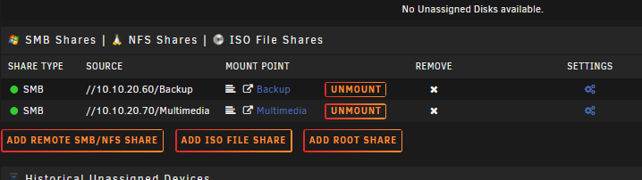

Should be there when you add a "add remote smb/nfs share" Like I have two remote NAS. Then it but the shares under automatic /mnt/remotes/ The mount point was automatlic added under the share/mount point /mnt/remotes/ like this: /mnt/remotes/Backup and /mnt/remotes/Multimedia They both are gone from File Manager and from all the containers that i like to point to remote share. All gone after upgrading to unraid 7.
Hmm, well this mean I have to roll back to 6.12.14 from 7. I hope this now crash anything on my system. So I can show you that i had access ti /mnt/remotes from "File manager" and also same path i can choose from my containers also. This is gone, but like I wrote earlier is working under the hood. So that's why I didn't notice this issue until I was going to copy some files over to my NAS (remote)
I had it on version 6.12.14. Just gone in v.7.0.0 I could copy/move files from my download disk to /mnt/remotes/.........

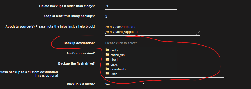

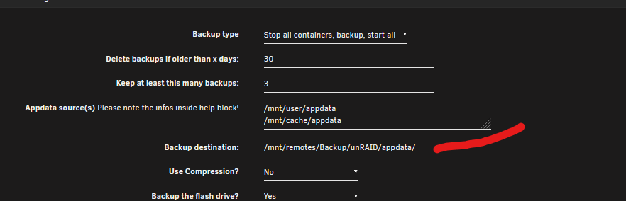

Yes please, I hope you come out with a solution here. This is going to be problems with some containers that need a valid path. For some reason all my ....arr's and Plex are still working. But if you remove the path and try to add it again, It's gone. So you need to remember your remote patch... /mnt/remotes/media/ I have to NAS, one BACKUP and MEDIA. Let's hope the backup is working, I'm using "Appdata Backup" And if I remove the destination, I can't choose my remote backup location

Same problem, I just notice that i was going to copy some files from unraid over to my NAS i couldn't fine the remote folder "remotes" So no way to copy. I'm glad the share is working under the hood. B'cos I do have Plex, and lot of arr's that are using /mnt/remotes/............ etc. Look at the image, the remotes folder is gone. And here i'm trying to cope a file from unraid to my NAS that was located under the remotes folder. Is now gone. Any idea how to fix this?
