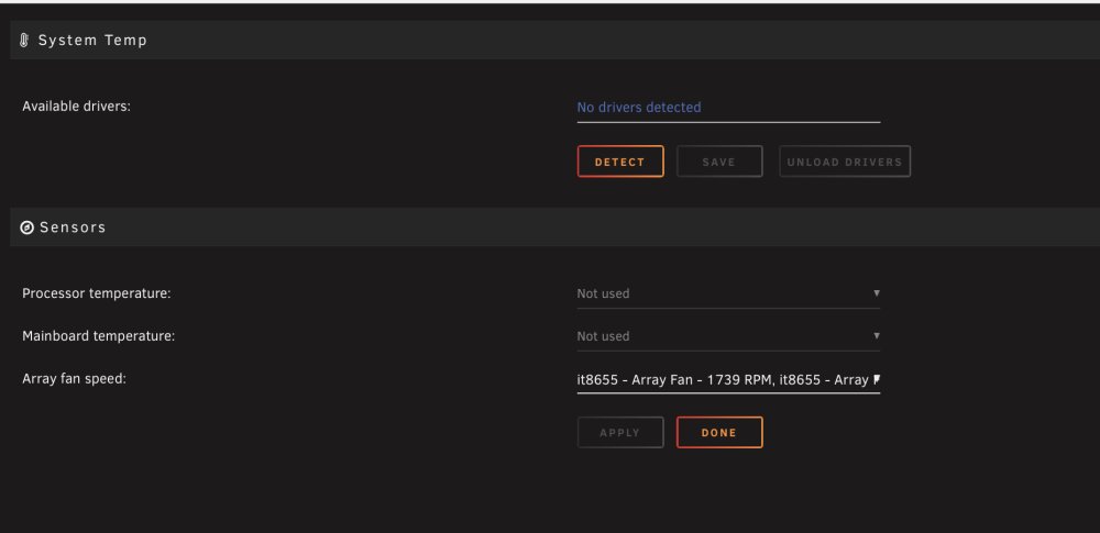

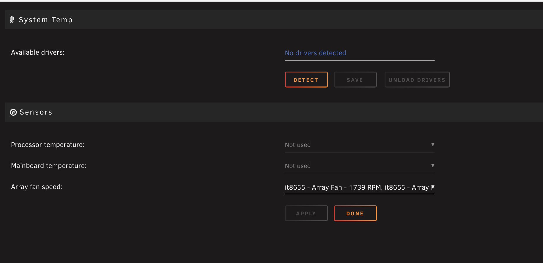

Yeah, that's why I was a bit confused. It looks like the Dynamix temperature plugin's script may be broken, or it might be getting confused because `sensors-detect` claims that the driver for the ITE IT8655E chip does not exist yet (`to-be-written`), which might be tripping up the detection in the plugin? Just a guess. Manually loading the driver by editing the configuration file fixed it. Thanks!
[Support] ich777 - AMD Vendor Reset, CoralTPU, hpsahba,...
Finally managed to get the temperature to show up in the plugin. Turns out the "detect" button is broken and does not scan available drivers properly. Following this comment: I had to create a `drivers.conf` file in `/boot/config/plugins/dynamix.system.temp` and add the following two lines: it87 k10temp Then once I went back to the temperature plugin settings I was able to select the CPU/MB temperature from the dropdown. One thing to note – already mentioned in the linked comment but just to make sure – don't click on "Detect" or else it will wipe out your changes and you'll have to start over. The commenter in the link had to do the `modprobe force_id` thing, but I didn't have to thanks to this plugin. You probably shouldn't need it if you have this it87 plugin installed.

@ich777 thanks for the reply. Great to hear mainlining is being worked on! The plugin does work and I'm able to see the sensors when I run `sensors`. The problem is the temperature plugin from Dynamix still says "No drivers detected" when I press the "Detect" button. Here's the output of `sensors`: it8655-isa-0290 Adapter: ISA adapter in0: 861.00 mV (min = +1.33 V, max = +1.40 V) ALARM in1: 2.52 V (min = +1.97 V, max = +2.19 V) ALARM in2: 2.05 V (min = +1.72 V, max = +0.28 V) ALARM in3: 2.03 V (min = +2.38 V, max = +0.63 V) ALARM in4: 2.03 V (min = +0.22 V, max = +0.32 V) ALARM in5: 1.94 V (min = +2.43 V, max = +2.75 V) ALARM in6: 2.03 V (min = +1.75 V, max = +0.28 V) ALARM 3VSB: 3.36 V (min = +1.40 V, max = +4.84 V) Vbat: 3.33 V +3.3V: 3.38 V Array Fan: 1776 RPM (min = 76 RPM) Array Fan: 1500 RPM (min = 43 RPM) temp1: +55.0°C (low = -77.0°C, high = -57.0°C) ALARM temp2: +47.0°C (low = -47.0°C, high = +28.0°C) ALARM sensor = thermistor temp3: +45.0°C (low = -9.0°C, high = +79.0°C) sensor = thermistor temp4: +45.0°C (low = -102.0°C, high = -25.0°C) ALARM sensor = thermistor temp5: +45.0°C (low = -74.0°C, high = -75.0°C) ALARM sensor = thermistor temp6: +45.0°C (low = +54.0°C, high = +11.0°C) ALARM sensor = thermistor intrusion0: ALARM k10temp-pci-00c3 Adapter: PCI adapter Tctl: +55.0°C amdgpu-pci-0800 Adapter: PCI adapter vddgfx: 1.38 V vddnb: 1.08 V edge: +45.0°C slowPPT: 4.00 mW Here's what the temperature plugin currently looks like once I press detect: The plugin does show the array fans (which is awesome by itself) but I'd like to get the processor and mainboard temperatures working as well if possible. I've tried typing in "it87", "it8655", and "it8655-isa-0920" into the "Available drivers" field and then pressing "Detect" again. It still results in the "No drivers detected" message. Any ideas?
