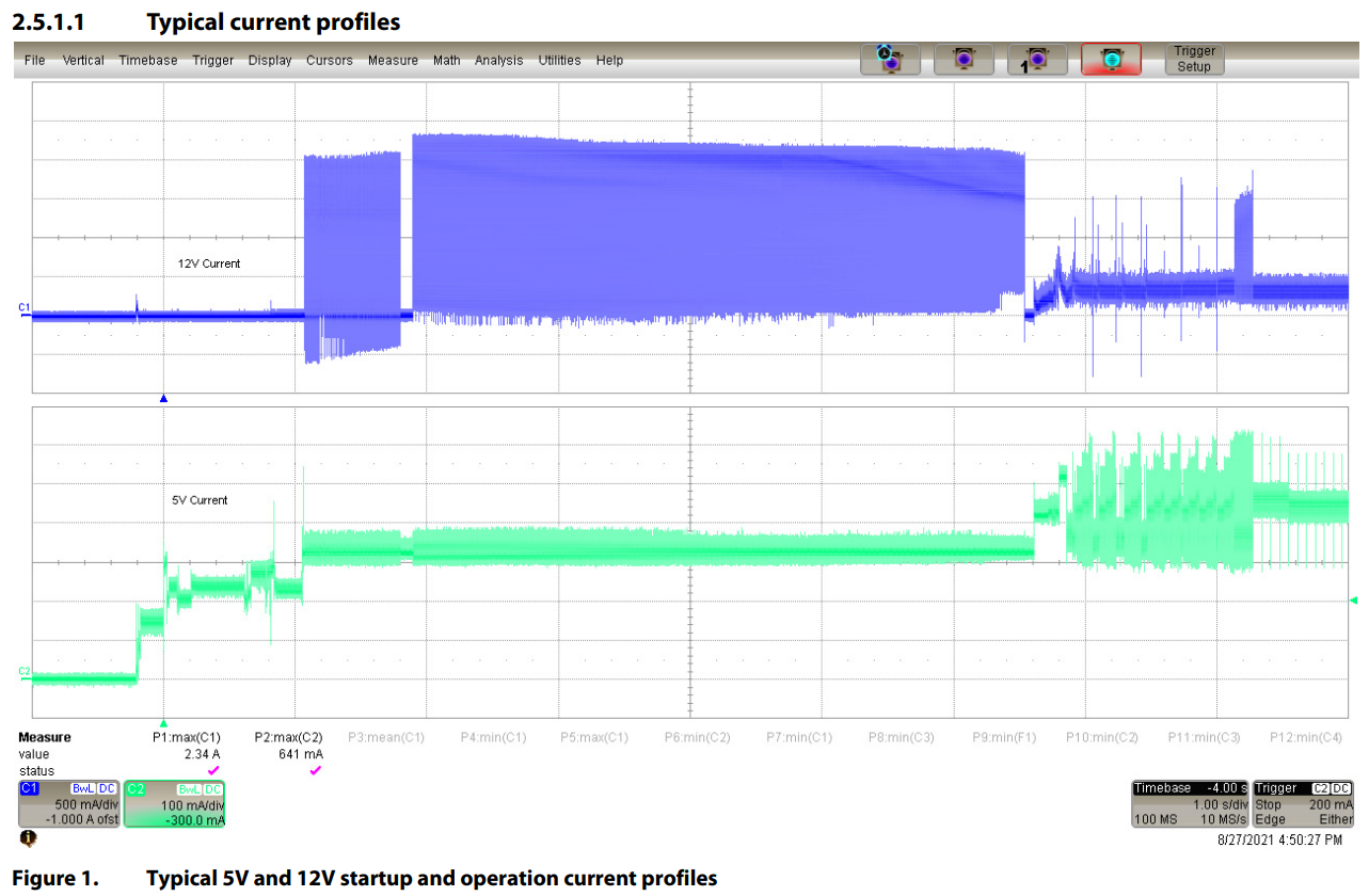

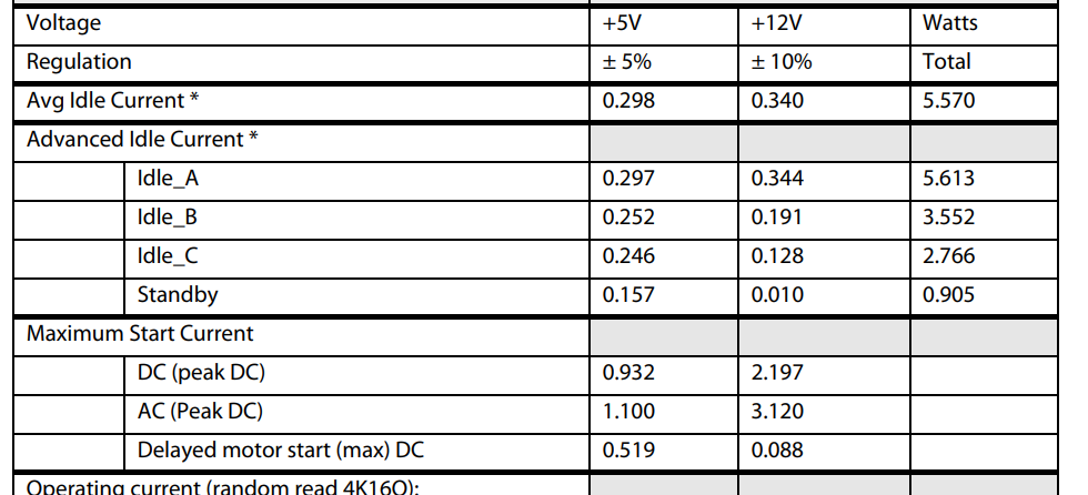

  13. Full datasheet has it. https://www.mouser.com/datasheet/3/47/1/96HD20T-ST-SG7KE_datasheet20230308183452.pdf?srsltid=AfmBOoqGB8-fDhFlNpufHzNxngKCPyYokATutRDfNKTAoscWDC0wOanv
