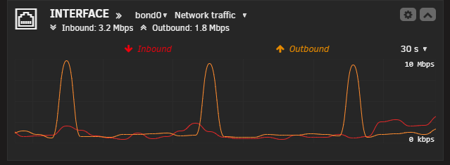

  5. This thing causes massive network spikes every time it refreshes even when nothing has changed And on my main system manages the incredible feat of freezing not only the browser (chrome) for about 3 seconds each time it does so (see below, I'm scroling continuously, the stops are due to it) but the entire OS (win11), can't switch windows and the mouse gets sluggish whenever the dashboard page is open. Also why a tiny font instead of the same as everything in the UI? Enregistrement 2026-03-14 205030.mp4

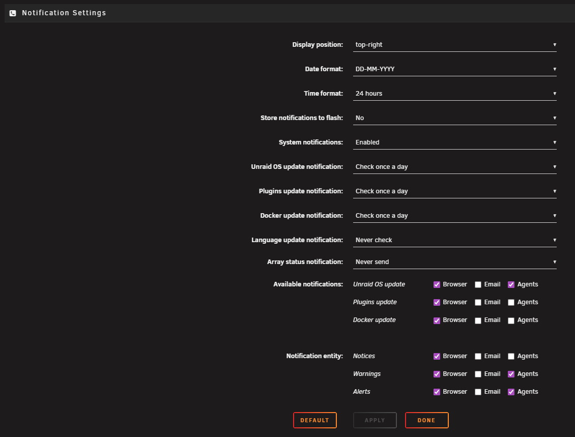

  7. Maybe post your notification settings
  8. Are the notifications actually showing in the unraid ui?

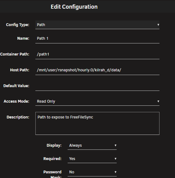

  21. path1 is by default set to read-only, if that is OK i.e. you're only going to modify the right side/path2 then just ignore that warning. If you want write access to both edit the access mode in the template.
