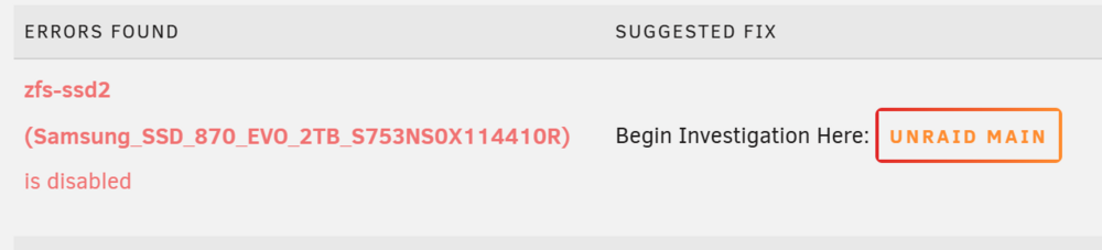

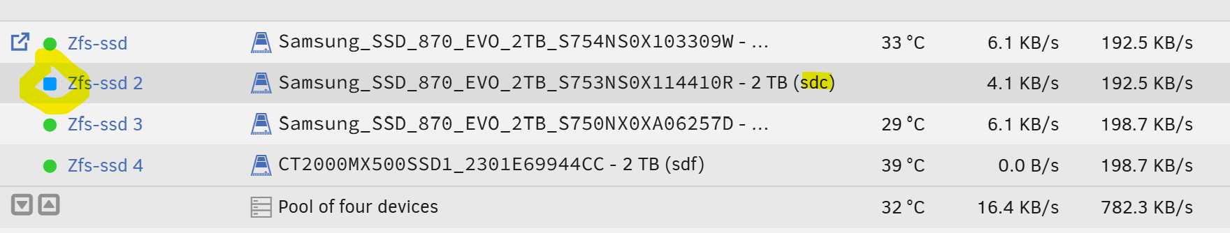

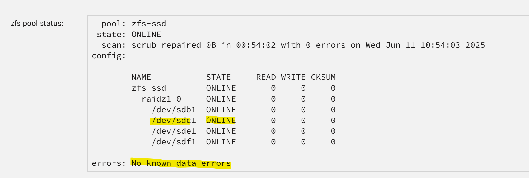

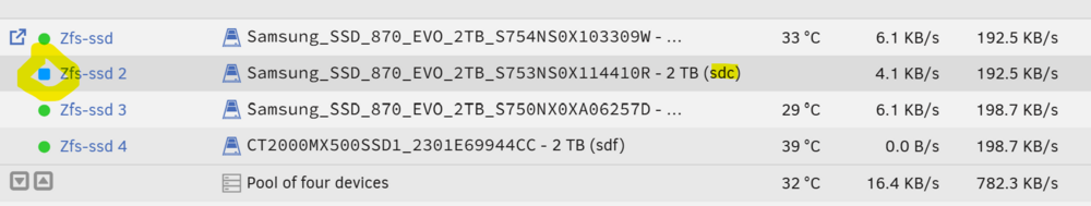

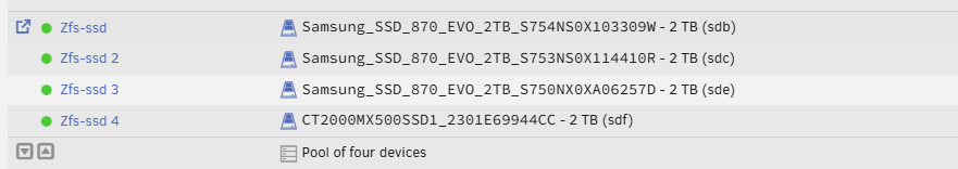

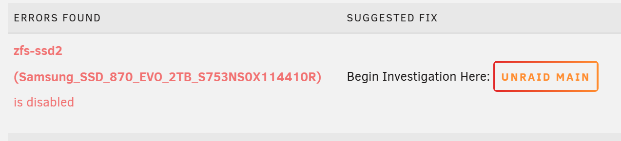

  2. I have had a 4 disk zfs cache setup for a while and I encourntered an issue with a cable on one disk. The cable is now fixed, the cache re-silvered but the unraid UI lists a blue square next to the disk ('new device'): Fix common problem plugin reports the disk is 'disabled': The pool status appears to be okay (it has been running like this for a couple of weeks without issue) I have tried stopping/starting the array to see if it would rebuild the disk. Even tried stopping, unallocating disk, starting, stopping, re-allocating disk and starting the array again. Everything is working fine except for what is reported in the Unraid UI or fix common problems plugin. Any ideas on how to rectify? Full diagnostics attached in case it helps. vault-diagnostics-20250613-1416.zip
