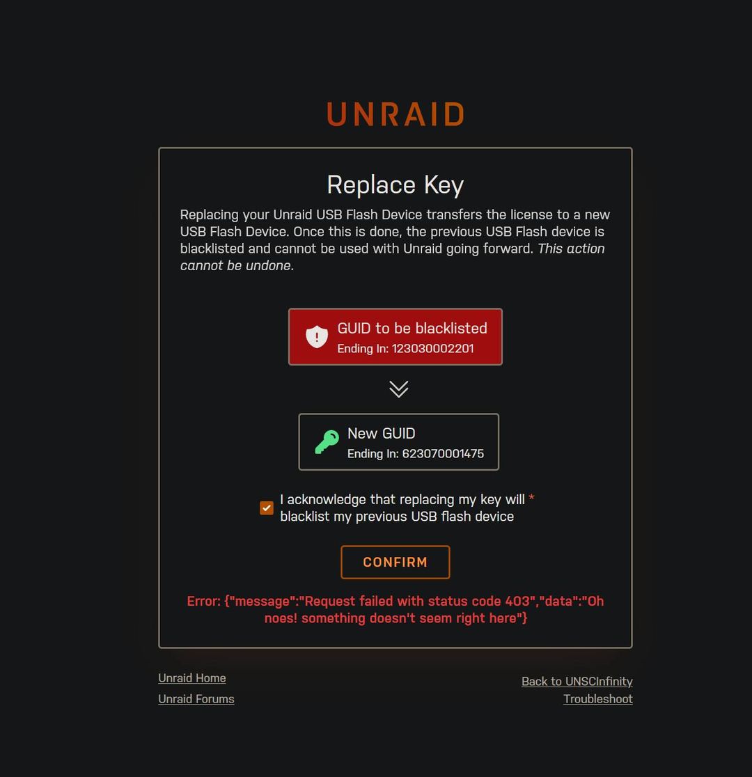

  4. Having issues with my UNRaid build, replaced core hardware and have since been having issues - been getting alerts around USB not being read/write. Hence wanting to replace the USB; however I get the below error when trying to activate. Can you provide a solution for me? I've seen quite a few support forum posts about issues with auth, however none have been helpful to resolve.
