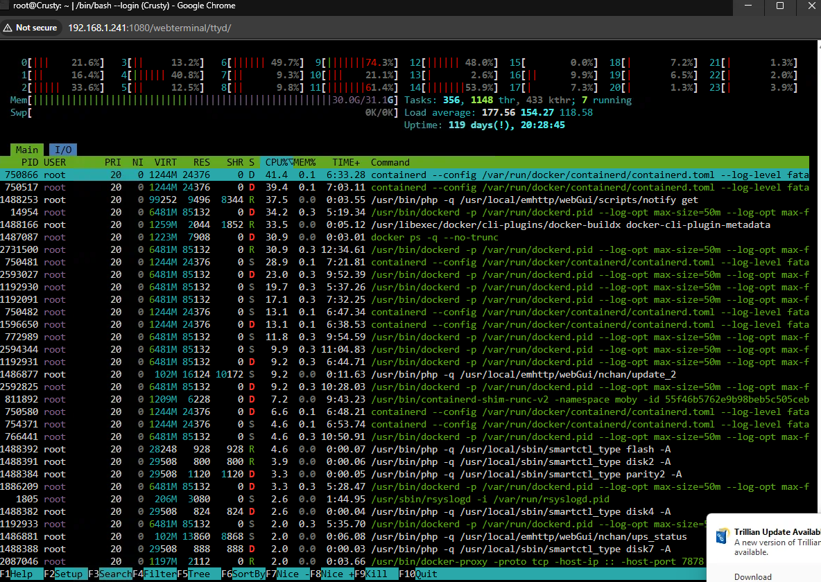

Over the weekend my server became unresponsive. It eventually opened the gui and i saw the CPU was 100%. I was able to run htop and this is what it showed. I tried to restart but it never came back up. Seems the USB drive is dead. I tried downloading the Boot Device Backup from Connect, first coupel times it gave me an error. Then it downloaded a backup, but when i used it to create the USB, it didn't install any data. Theres just an empty "syslinux" folder and the normal files on the root of the usb. No Config folder nor EFI folder. Does unraid connect have a bad backup? it says its from just 3 days ago.- Started noticing BTRFS errors on NVME cache. drive showing as missing/unassigned.

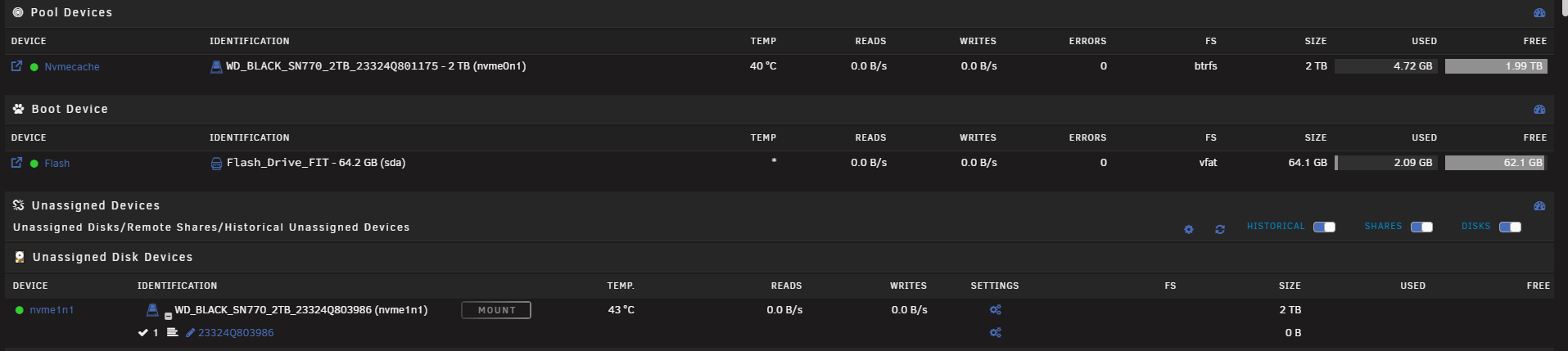

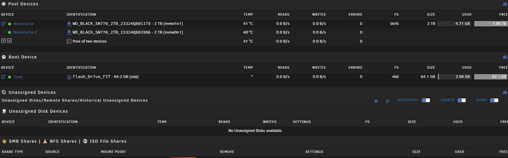

root@Crusty:~# blkdiskcard -f /dev/nvme1n1 bash: blkdiskcard: command not found Tried that and got the above? I'm just typing that in the terminal window you get to from the >_ button at the top right? Edit: I found what you meant- blkdiscard* did the rest and attached diag. looks like that worked to me! Thanks for your help with this! crusty-diagnostics-20260217-0937.zip- Started noticing BTRFS errors on NVME cache. drive showing as missing/unassigned.
ok, i did that and then removed the pool, readded the pool with 1 slot and added nvme0n1, it started and seems fine. crusty-diagnostics-20260216-1523.zip- Started noticing BTRFS errors on NVME cache. drive showing as missing/unassigned.

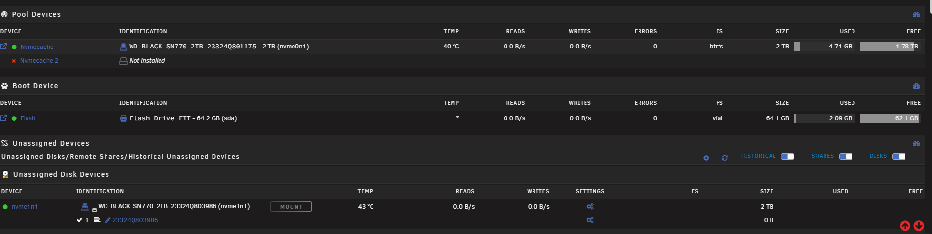

OK i believe I did that as instructed. even though i made it 1 slot it still says its not an uninstalled nvme2? crusty-diagnostics-20260216-1107.zip- Started noticing BTRFS errors on NVME cache. drive showing as missing/unassigned.

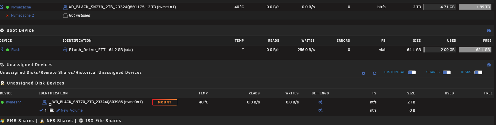

ok i did, seemingly, the same thing again, and this time it seems to have formatted the drive when i started the array. i think I'm good to go. gonna post diagnostics again if you could check if everything is looking ok. crusty-diagnostics-20260212-1634.zip- Started noticing BTRFS errors on NVME cache. drive showing as missing/unassigned.

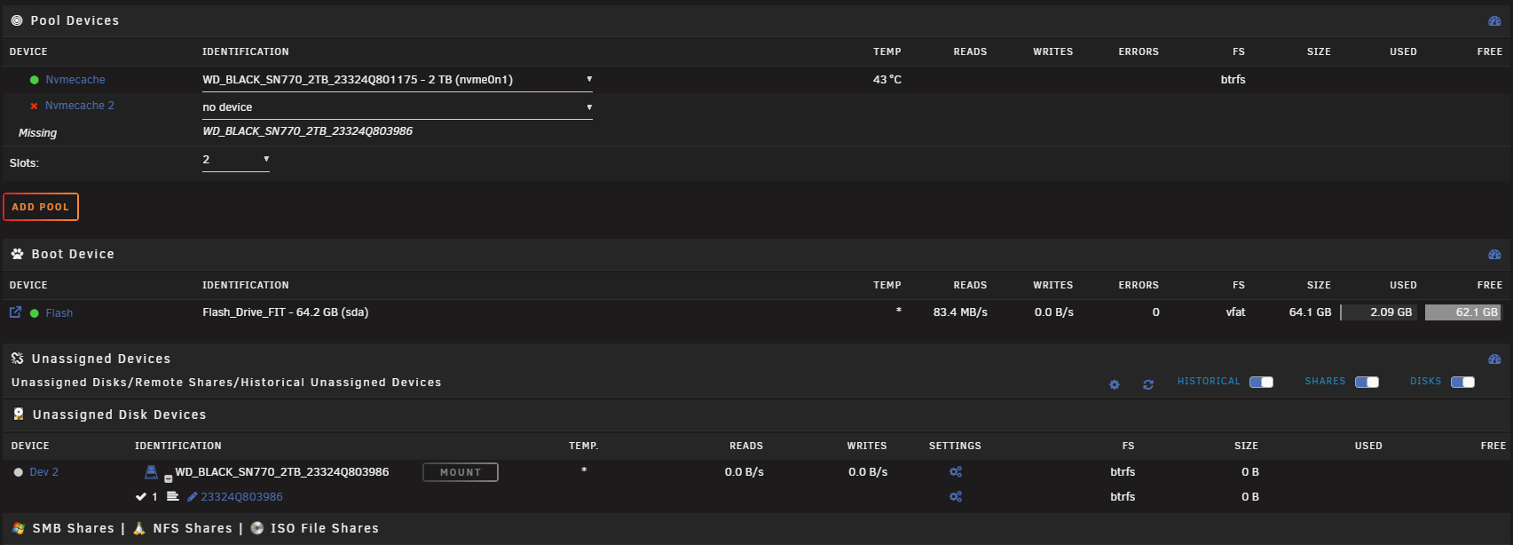

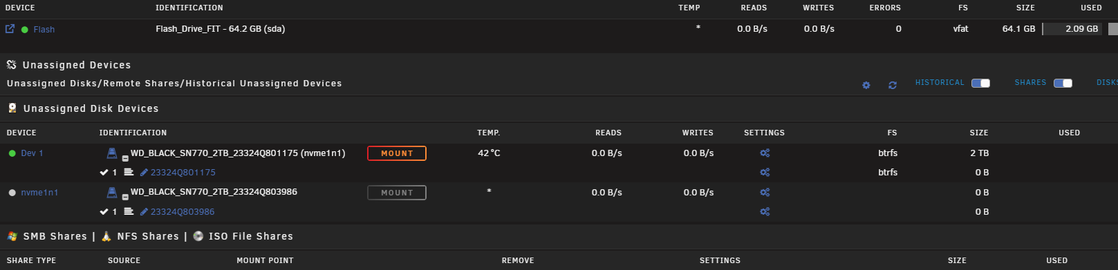

ok, I got the ssd onto a windows machine, deleted the volume in disk management and recreated a new NTFS volume. I installed it into the server and Its now showing up as mountable. my problem now is I'm not sure how to make unraid reformat the drive to use BTRFS so i can add it to my cache? screenshot+diag attached crusty-diagnostics-20260212-1612.zip- Started noticing BTRFS errors on NVME cache. drive showing as missing/unassigned.

I took the drive that wasn't working and swapped it to a 3rd m.2 port on my mobo. still not showing. (the other drive is under some "ssd armor" under the cpu heatsink, would be a pain to get to) i double checked that the new m.2 slot's lanes aren't being used for other sata ports. I'm gonna take the drive out and see if i can see it in windows i guess. new diag attached crusty-diagnostics-20260212-1240.zip- Started noticing BTRFS errors on NVME cache. drive showing as missing/unassigned.
