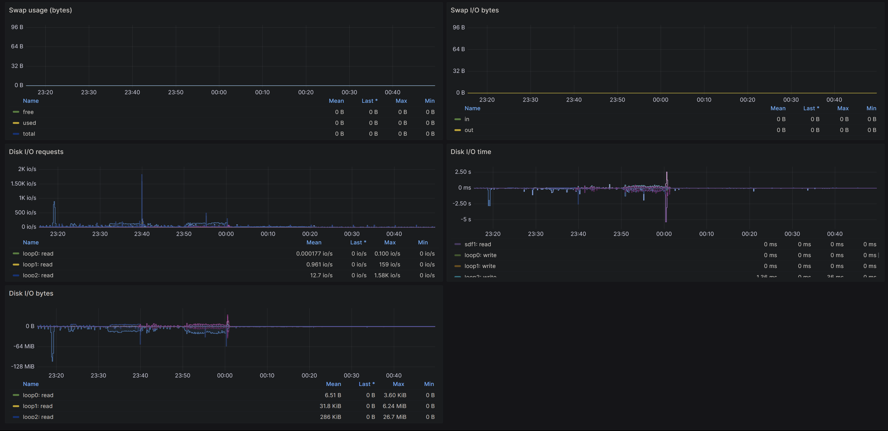

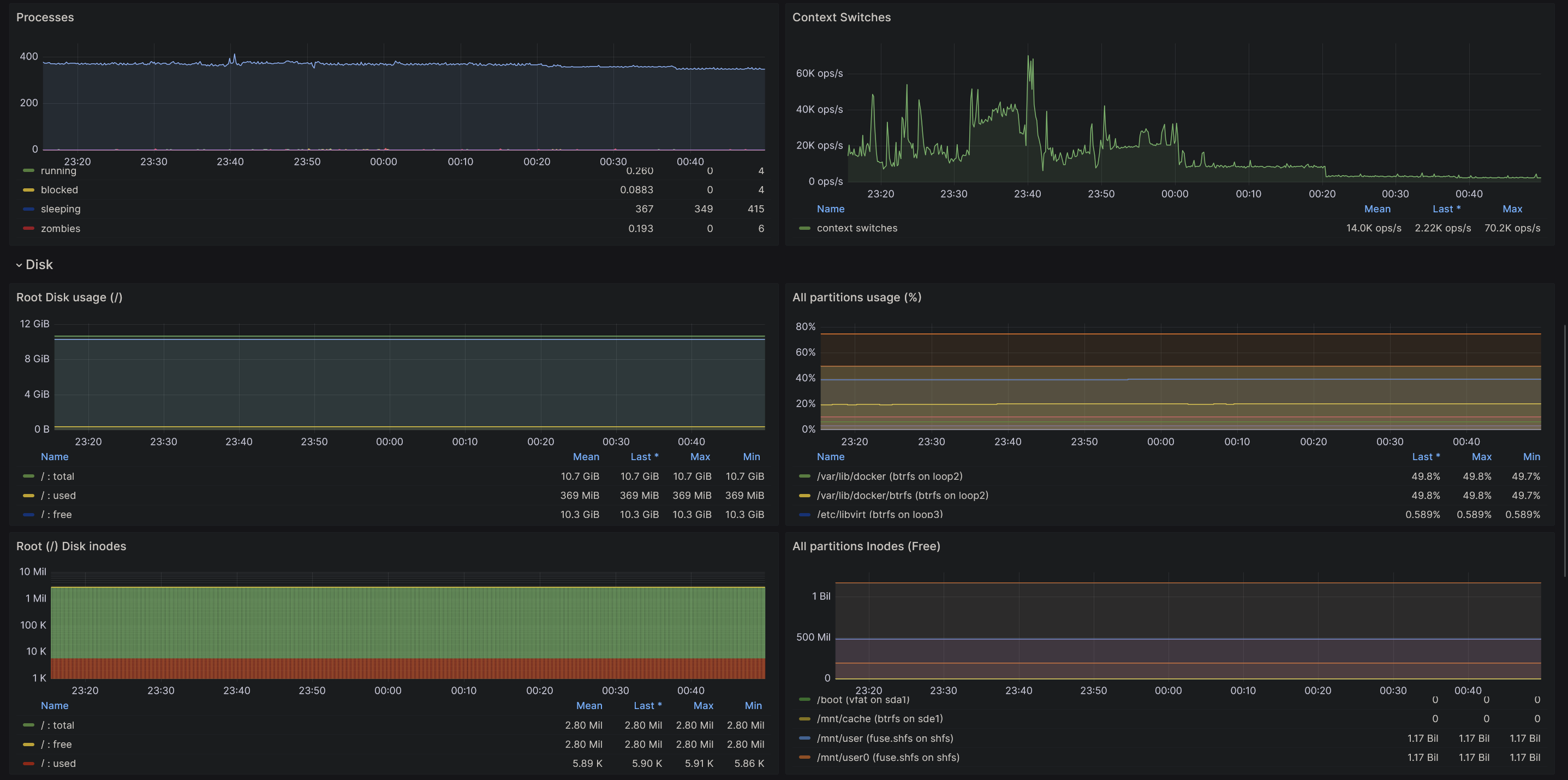

  2. Tonight my unraid stopped responding from the net and after pressing the shutdown button in this morning(it was turned on during the night) i hear disk spinning up and it returned reachable, after it showed that one drive have failed but the smart is good, i already started rebuild. what can caused this issue? after watching the content of some monitoring container i see that the system was online but the network stopped working. The system becom unreachable after 00:21 casaz-nas-diagnostics-20231207-0909.zip

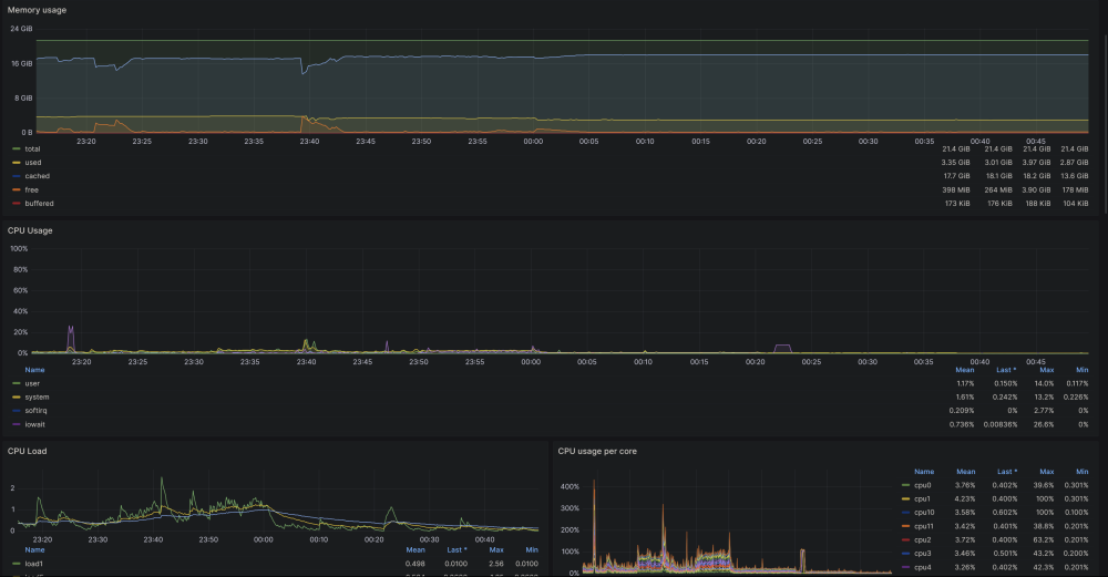

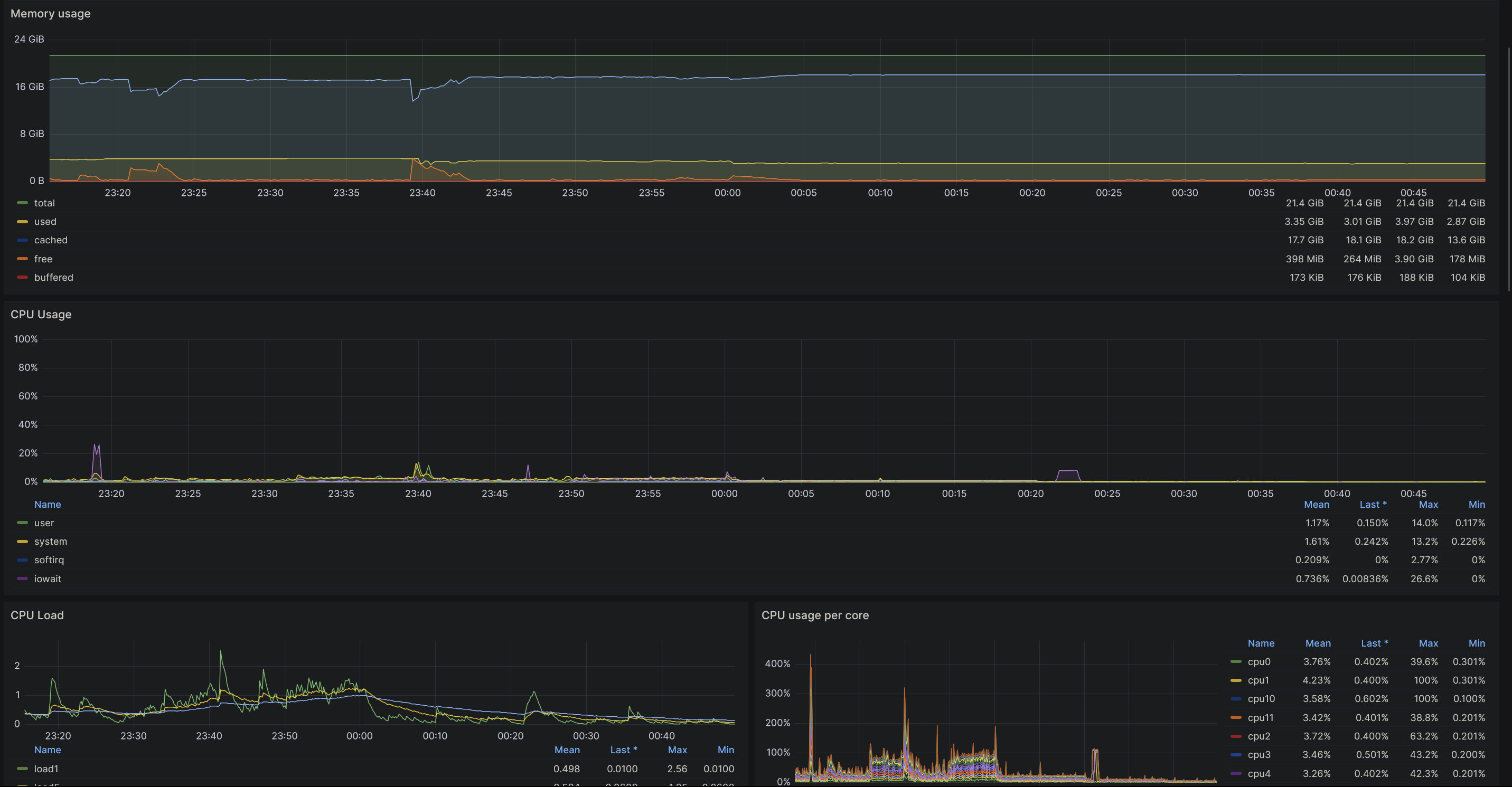

  3. found the cause, i configured unraid to use only ipv4 and ram usage returned to normal but now i can't re enable ipv6+ipv4, ipv6 memory leak problem?. i think something is wrong with unraid and ipv6, after applying settings nothing change, only reboot apply settings and the server is unable to get a dns server from dhcp

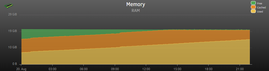

  4. now it reached 16G, and it still going up pretty fast. Now there are 3500 more processesram2.txt casaz-nas-diagnostics-20230820-2159.zip
  5. ok, thank you, but when the used ram(not the cached) reach 100% the system become unresponsive and every action on the webpage take a very long time to load.

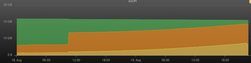

  6. Hi, i'm having some prolem with the RAM usage, after boot i nearly have 2G of used ram but after two days it reach 8G, in about a week it fill 24G of ram, and at that point i need to reboot the system. doing the command ps aux | awk '{print $6/1024 " MB\t\t" $11}' | sort -n i have found an strange amount of dhcpcd processram.txt. graph of memory usage of the last two days: casaz-nas-diagnostics-20230819-2301.zip
