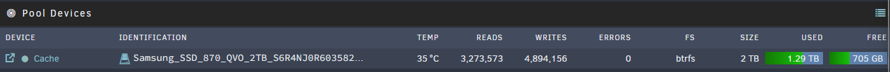

Sorry for my slow response. It has been another busy day and I cannot get to my hobbies as quickly as I like to more often than not. So I have not read your most recent 3 comments. Before I do I wanted to give you a server update. It looks like good news. My server has successfully freed up my entire cache drive (see pic). The bad news. I have no idea why. I have attached a new diagnostics file in case it can provide any insight on what changed since last night. jurassicpark-diagnostics-20250206-0117.zip

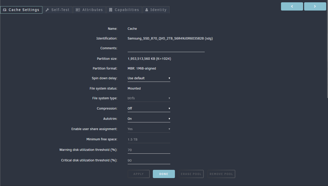

Correction. Mover has just finished. But this is very interesting. Either I don't understand that "Minimum free space" setting, or mover did not work right. Because it finished moving files and I don't have 1.5TB of Free cache jurassicpark-diagnostics-20250205-0400.zip
Cache drive suddenly full. Running Mover does not seem to do anything. Need help understanding Diagnostics files to learn how to debug.
The mover is still running. Will probably have to update with new diagnostics data in the morning. But it looks like it is working. Cache Used has already dropped to 1.41 TB. Ahhh I think I get "Minimum Free Space" setting inside the cache drive now. It only took me reading and rereading your description and Unraid's description like 10 times each. I was getting confused because you were talking in terms of "Files". While Unraid talks in terms of "Volume". You are both saying the same thing but slightly differently. If I understand it correctly, The "Minimum free space" setting is telling Unraid how much Free Space I want on my cache drive. That means if the remaining free space on my cache drive ever becomes less than this amount, so in my case less than 1.5 TB (ex: 1.4TB), then the mover will activate and start moving files off the Cache (like it is currently doing) until the remaining free space becomes 1.5 TB or larger. You talk about this setting in terms of File size because I never want Unraid to run into a situation where it cannot completely write a file onto a drive and cause an error. So you recommend to set the remaining free space to never drop below the largest individual file size that I might encounter. That way I maximize using my cache drive while never encountering a write error. Hopefully that explanation makes sense for future people. Now I mostly understand why you said 50G. My only remaining question is why you said "50G" (53,687,091,200) instead of "50 GB" (50,000,000,000)? Also does the space between the number and letter matter?

What is a good way to figure that out? I have plex writing to Cache. Since it's a 2TB drive so maybe 1.5TB? Something also that just popped into my head. Does Unraid have some sort of Trash Can or Recycling feature? I just remember I have a Docker Application called Maintainerr. It's supposed to clean up unwatched Plex movies and tv shows (that is what is in the d - - a (aka data) folder). I was running out of space on my system so I accelerated the clean up process and it recently deleted about 10TB of files. Could that some how effect the cache drive? I activated mover and will attach the new diagnostics data once it is finished

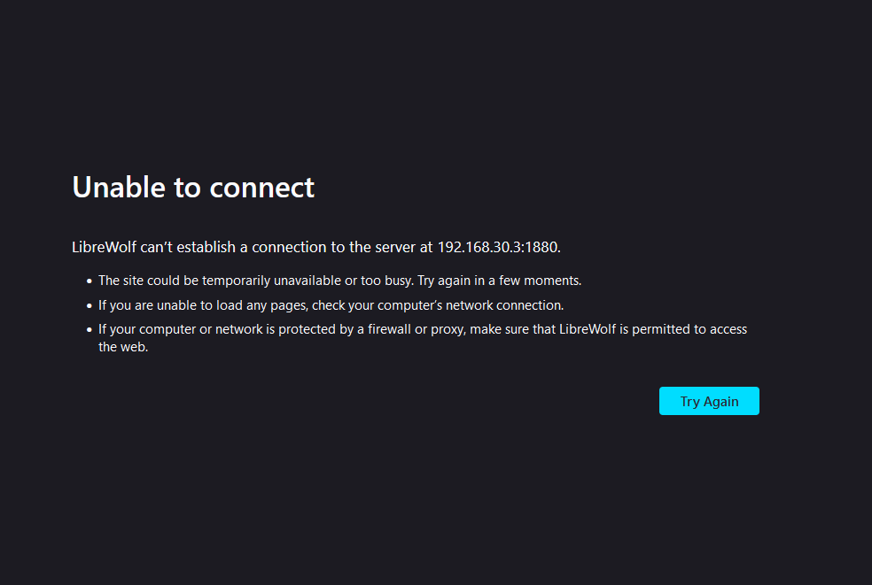

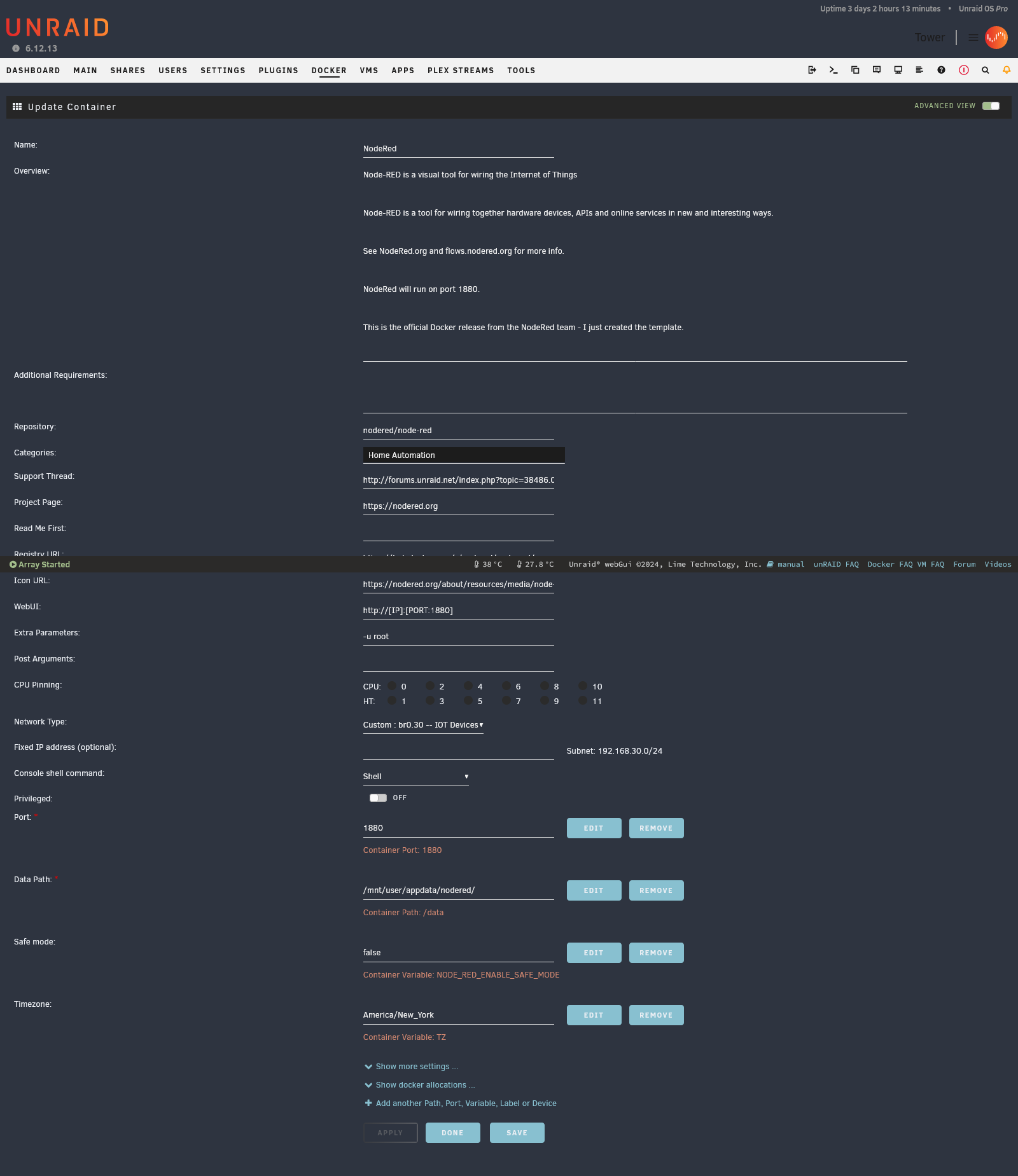

You are right. Thank you for that clarification. Changing the network to a bridge that shares the same IP as my host system fixed the problem. How can I manually set the IP address for Node Red if I want to put it on a network that's on a different VLAN? I want it on the same network as my Home Assistant VM. You said I have to do it in the settings of the application itself. Where is this setting in Node Red? Is there really no way to set it from the container setup?

@Skylord123 Would you be able to send a picture of your setup file so I can copy it? Is there anything different?

I'm confused can you please elaborate. Why would changing the port to 1881 in the Port field of the Docker Setup up not change the port value from 1880 to 1881? I've done that with countless other containers and it has worked just fine. I changed it to not conflict with Nginx Proxy Manager but I really didn't need to since NPM runs on a different VLAN now that I'm thinking about it. Changing the port value back to the default 1880 in the Docker Setup unfortunately does not fix anything either (see pictures).
