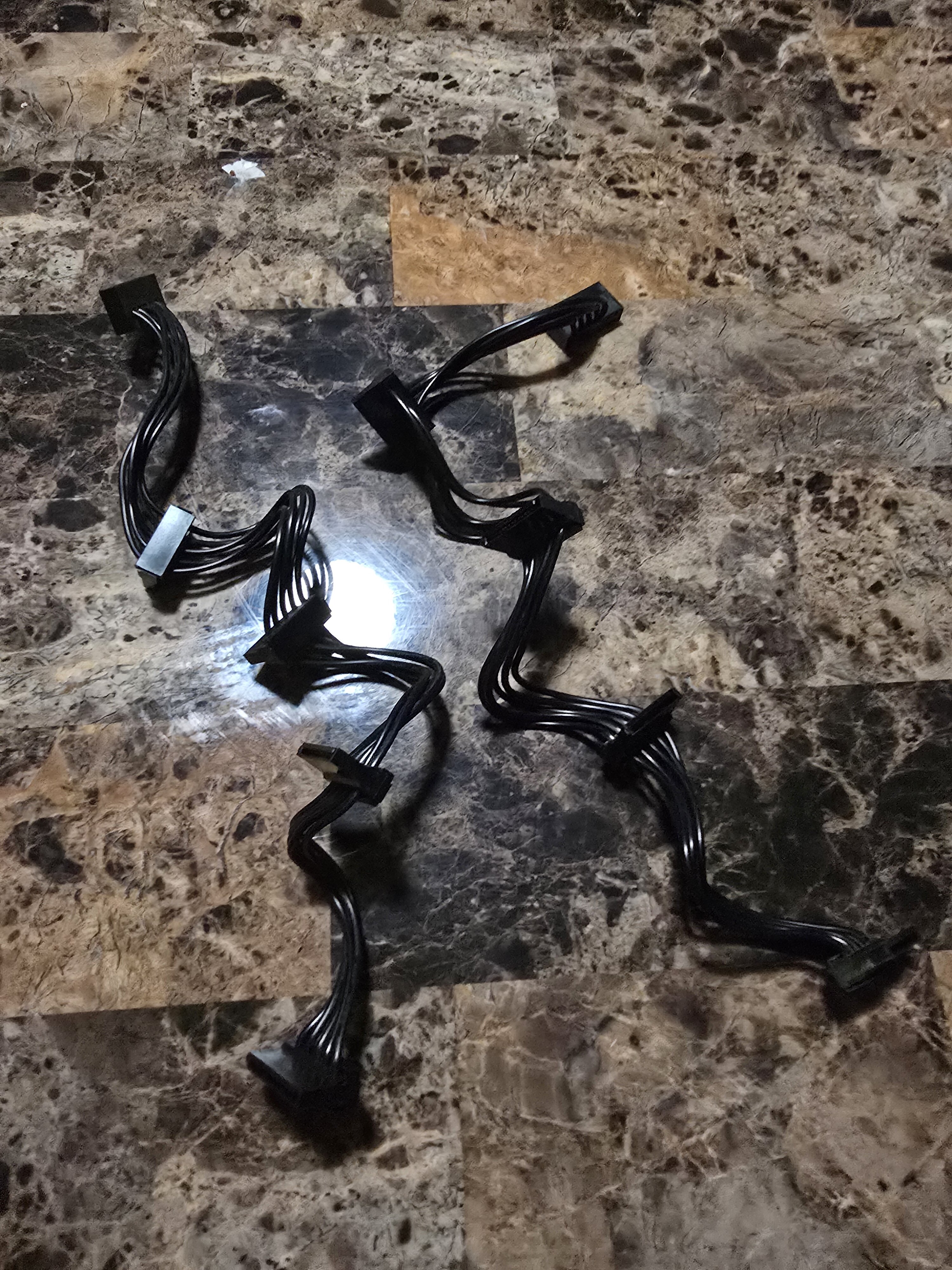

  1. This may be premature, but I've rebuilt Disk 1 and Disk 2 is at about 75%~ without any further issues. It looks like those extenders were the problem, and I still can't believe how long they've been in my server and potentially causing issues. Thanks again for the help, Jorge.
  2. I am facepalming so hard right now. So I finally bothered to open up my server and look at the power cables themselves, and not just the connections attached to the disks. Both of the two groups of disks that have been giving me problems (the daisy chains of Disks 1&2 and Disks 3&6) are attached to an additional extender cable (I don't know the name, I'll attach a picture) that were then attached to the disks. I must have attached these extenders years ago, because I don't remember doing so at all -- in the era when I wanted to daisy chain most of my drives to one cable instead of splitting them up). It seems beyond coincidence that the two groups of disks that have been given me grief happen to be the ones that were attached to these extenders. I have begun rebuilding Disk 1. Fingers crossed it was these damn extenders that were the cause of my current (and older????) issues.

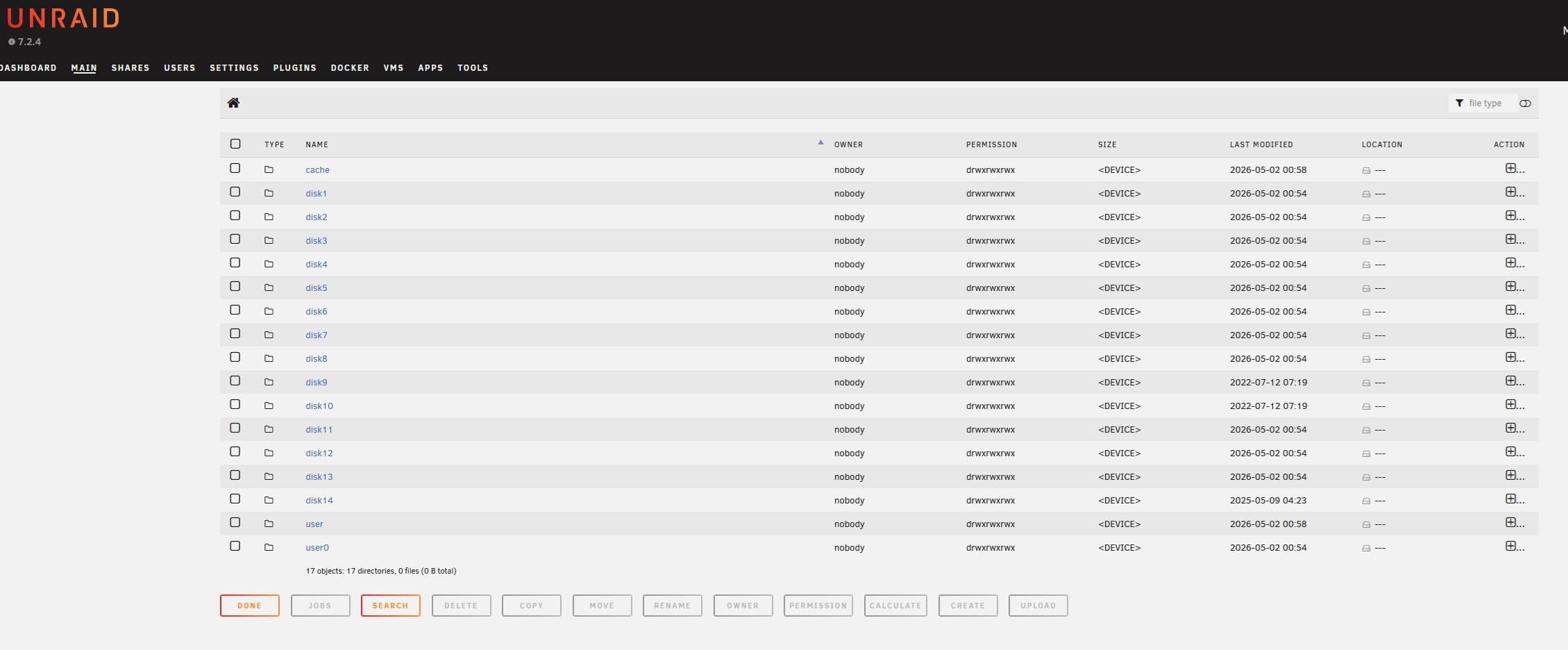

  13. Ah, sorry about that. I misunderstood, my fault. Doing that, I found and deleted the media cfg file. I am rebooting the server now to see what happens. EDIT: nothing changed on a reboot.

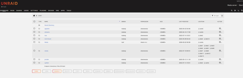

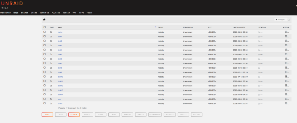

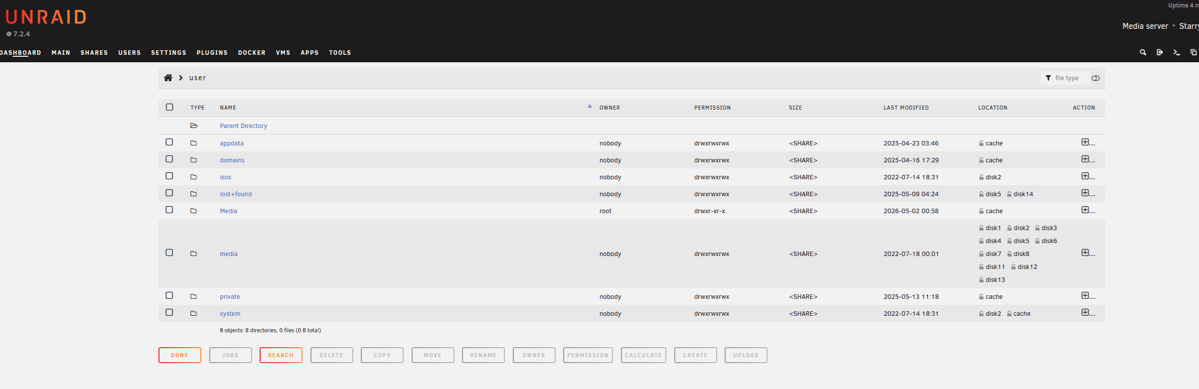

  14. Sorry to sound obtuse, but I'm not sure how to locate that location. When I click the file manager button in the web UI, this screen (attached) pops up, but none of the folders seem to lead to a config/shares/ location. EDIT: Also, I tried renaming the "Media" share to remove the uppercase and restart the array to see if anything changed. Just resulted in two Media and media shares (different cases) and now my Plex doesn't work.
