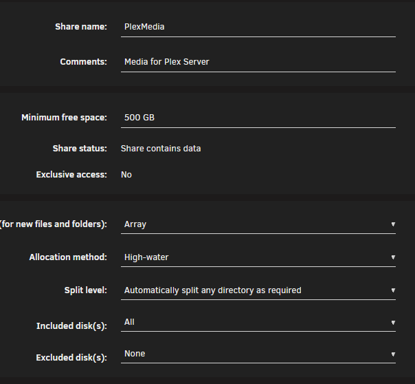

  3. how do i do the diagnostics

  6. i have it set to 500GB it was set to 1GB for some reason.
  7. I am having an issue where I have to HDD that are filling to the point that there are just KB of space on them, I have my array set to "high water" and there is a new drive that has 11TB of space that I just put in. How can I stop those drives from filling up? How can I see why they are in the first place? Please Help

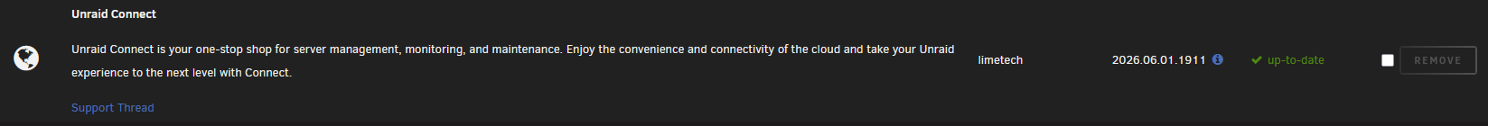

  10. no i don't, when i updated to 7.3.1 i didnt see that icon anymore
  11. I am signed in to my unraid server using my connect username and password but its not showing up on connect.myunraid.net account. I am using version 7.3.1. everything i lookup is telling me to enable remote access under API settings but there is not an option in 7.3.1 to do so. please help
