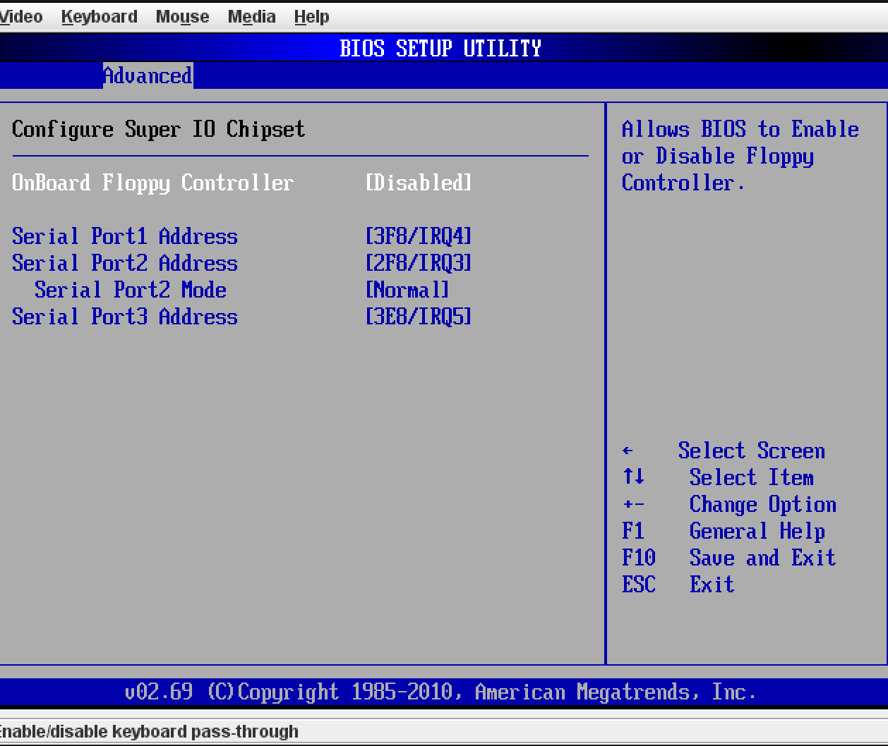

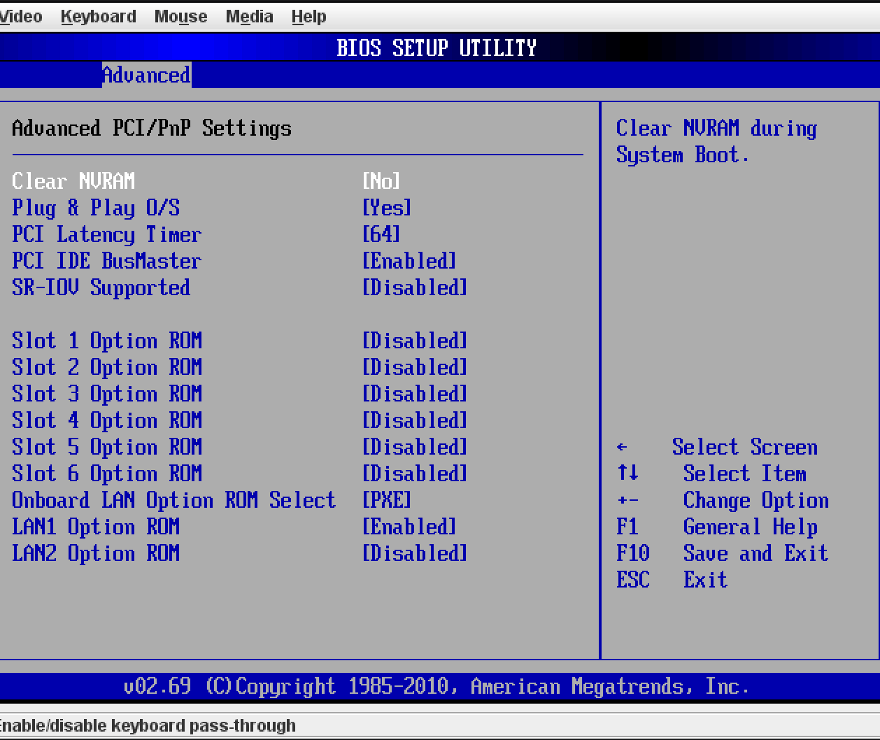

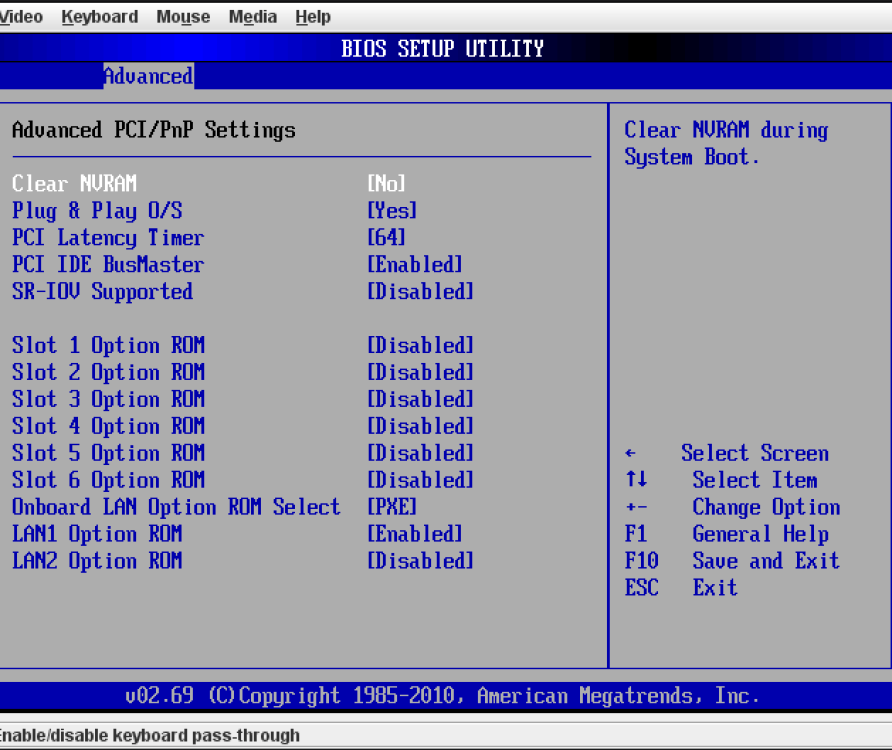

  2. i have a Supermicro x8dti-f with the last firmware 2.2 from 2018. 3 Raid controller in IT mode. (30 Disks) And it wont boot from USB exept: (The Serial Port Settings are most important 😄 / Funny Bug)
