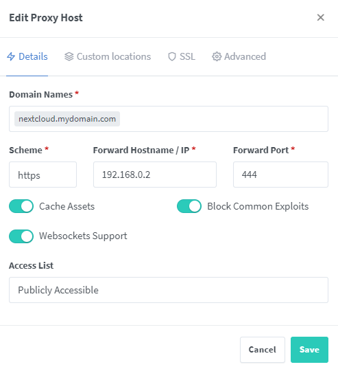

  7. Ok so have moved UNRAID to 5000/5001 and NPM is now on 80/443. Think I'm making progress but not there yet. -NPM is now host network with server IP and when I go to http://mypublic IP I get the NGINX congratulations screen, which is what I want !? -added new proxyhost and am able to get a cert from let's encrypt (couldn't before) -Now, when I click the proxyhost link to my domain I get "400 bad request The plain HTTP request was sent to HTTPS port nginx" Is this a config problem on the cloudflare side ? EDIT: simply changing the proxyhost to https from http it works. I think nextcloud needs https (although not sure why yet). Thank you very much mgutt for your help. I'm off to do some cartwheels 😆

  12. Hi, looking for some assistance setting this up with nextcloud. I've been messing around for longer than is healthy and hit a wall! I have a domain on cloudflare with nextcloud CNAME - nextcloud.mydomain.com. I configured NGINX to point to nextcloud but get a 404 error. I can access nextcloud locally when I remove the "overwrite" commands in the config. -nextcloud, cloudflare ddns & nginx all on custom network (proxynet) -server is 192.168.0.2 nextcloud is on port 444 -port forwarded as follows on a sky router -cloudflare A record points to my public IP -nextcloud config attached -nginx settings -cloudflare set to "full" on SSL/TLS, records are "proxied" Result is a 404 not found error when accessing externally ! nextcloud.config.edit.txt
